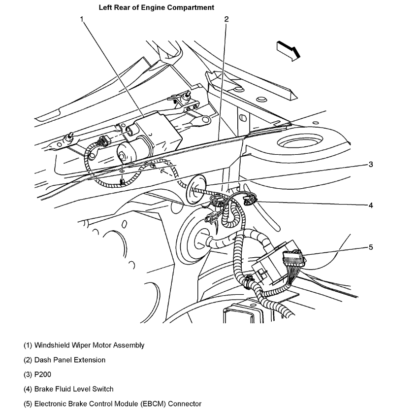

Remove protective cap on base of wiper arm and see if the nut that holds it to wiper trans is loose. If so tighten nut, if the nut is tight the control rod that works the drivers side came off here is a diagrams so you can see what I am talking about. Check out the diagrams (Below). Please let us know what you find. We are interested to see what it is.

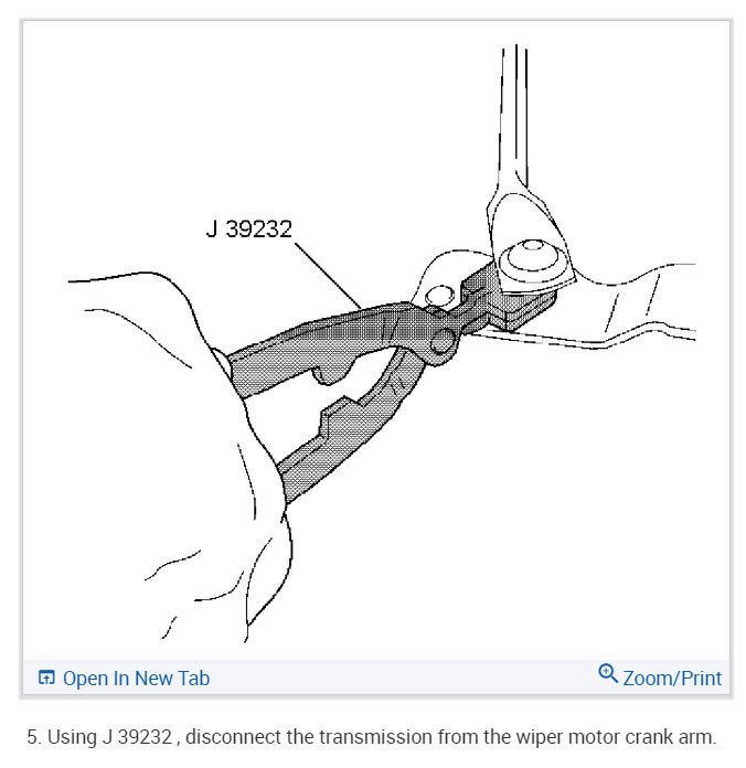

the above person has a legitimate answer, but his answer is no where near what the root of my problem was. the problem I came across was not the nut but is the actual bushing which snaps onto the ball joint on the wiper motor arm. the arm is held in place by some cheaply made plastic. i have a 1985 VW and the wipers still work (go figure), the overall design of the wiper system is pretty bad by Chevrolet standards. it is simply bad engineering on that specific part.

i did not make a conclusion without seeing what the problem was. i fixed my problem which happened to be a faulty linkage bushing. that is why i took a picture and went into detail with the problem i had.

I have the same issue myself. I have visually inspected and found the same bushing to be split in half causing the linkage arm to fall from the ball joint on the bottom of the wiper motor. I have tried Dorman replacement bushings with no luck. Chevrolet wants to sell the entire linkage kit for $197.00. all this to replace a bushing that should sell for about $5.00. Do you have a part number and source to order this bushing from?

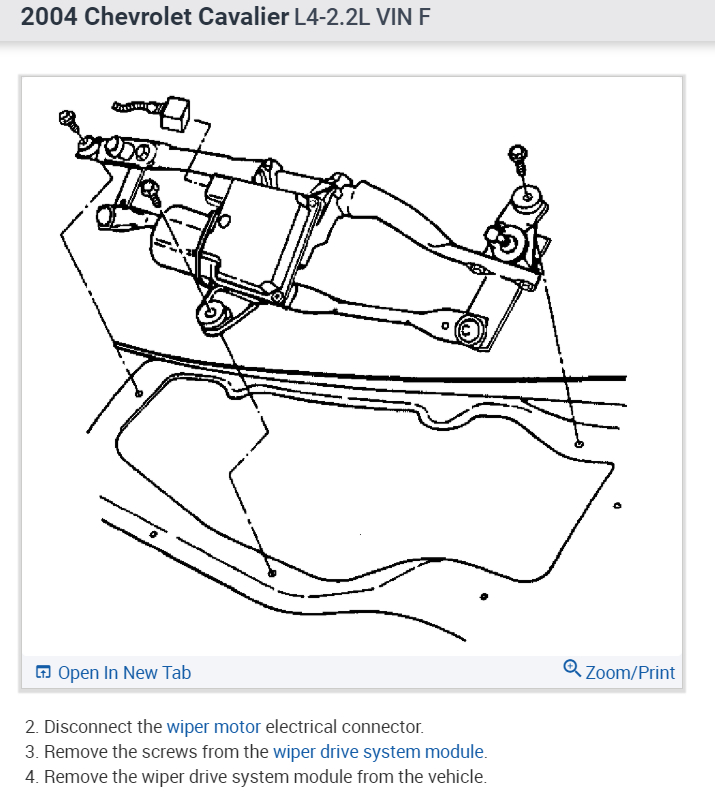

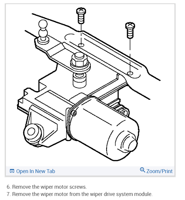

You will have to remove the plastic cowl to gain access.
Make sure the wiper arm bolts are tight, if so then remove cowl and inspect transmission assembly for broken parts.
