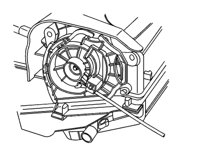

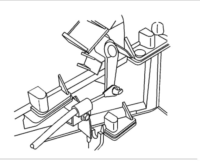

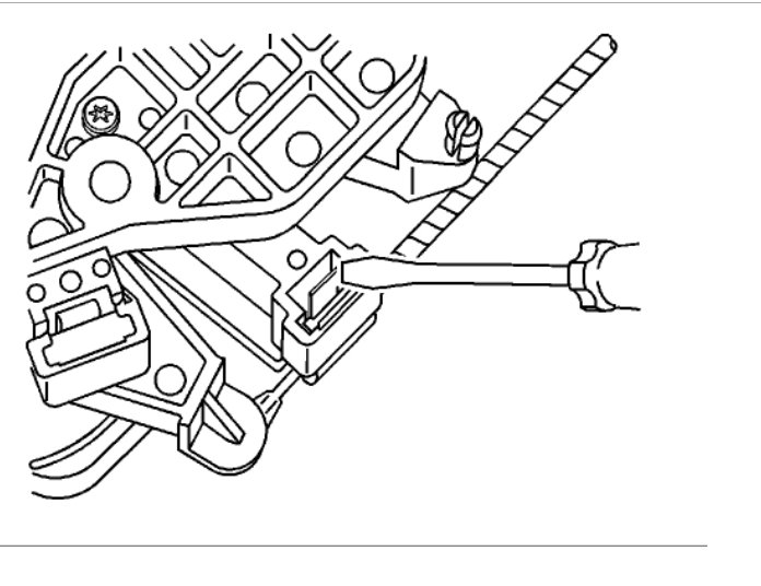

This sounds like you have a problem with the temperature blend door cable that has gone bad or broken which is common. Here is a guide to help confirm the problem.
https://www.2carpros.com/articles/car-air-conditioner-not-working-or-is-weak
and this will show you what you are in for when changing the cable out.
Here is a what it will be like on your car (below).

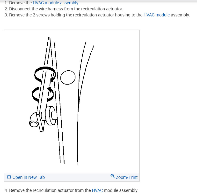

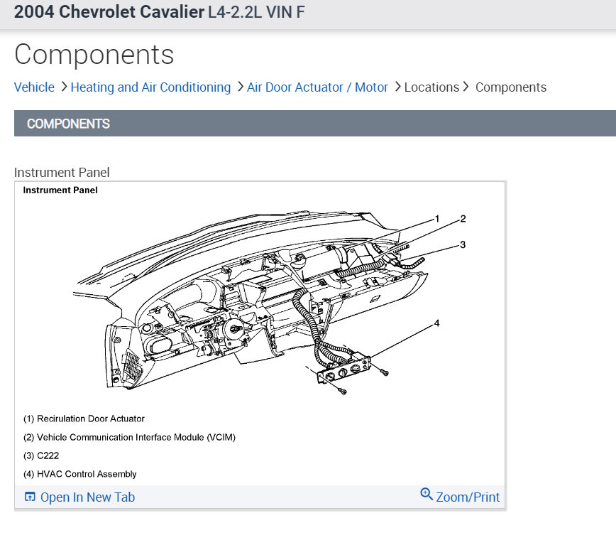

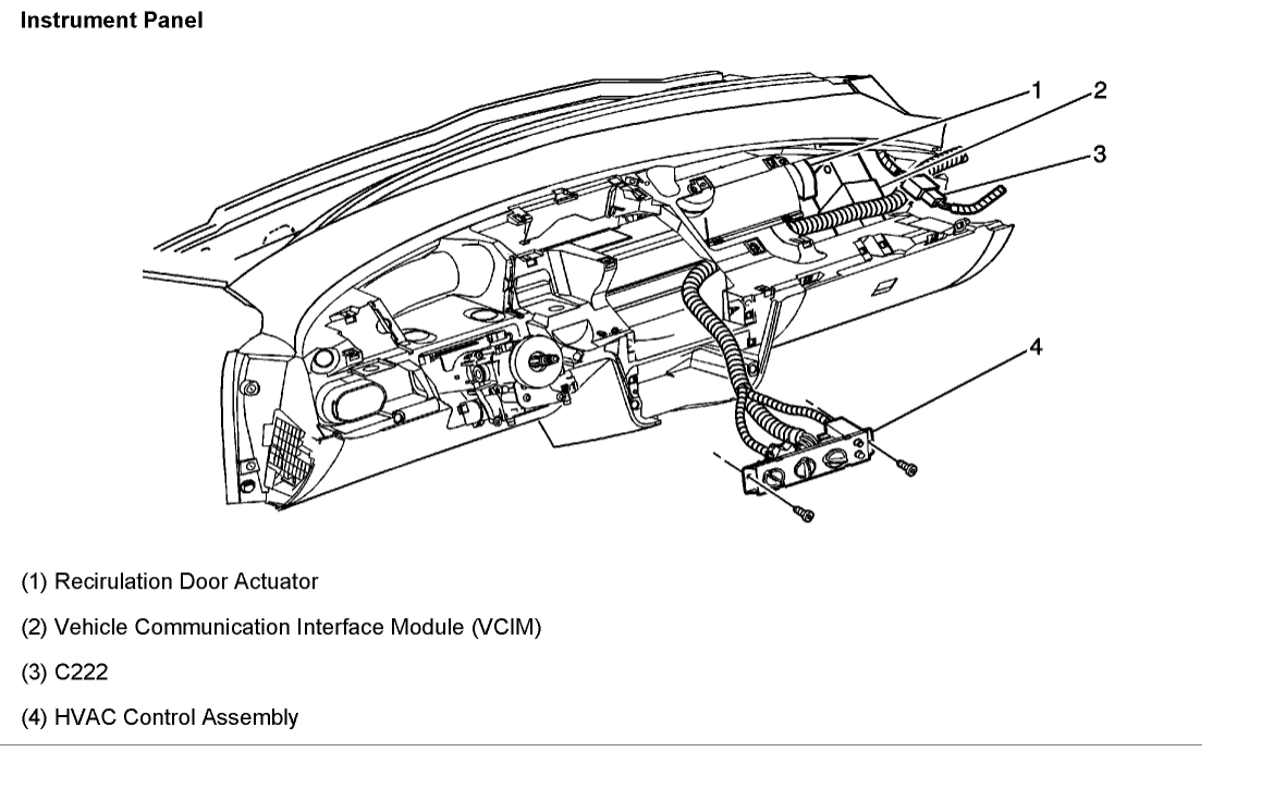

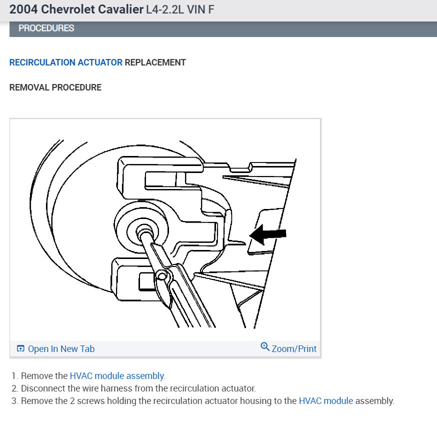

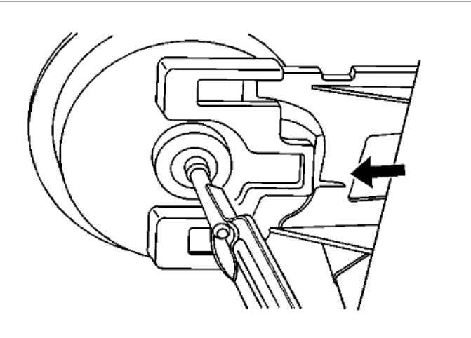

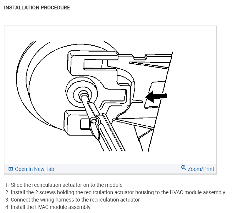

Hi I have a 2004 Chevy cavalier I just had my ac checked by a certified tech everything is where it needs to be. I just have a low vent flow when it's running. The ac blows cold and when I have it on the highest fan setting it's blowing out the vents very little. What do I need to do to fix this. Please help I have babies that I have to put in the car alot and it's been to hot for them.
Sep 23, 2022 at 12:30 PM

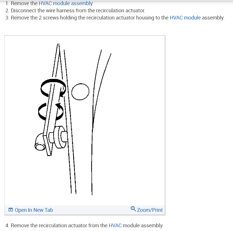

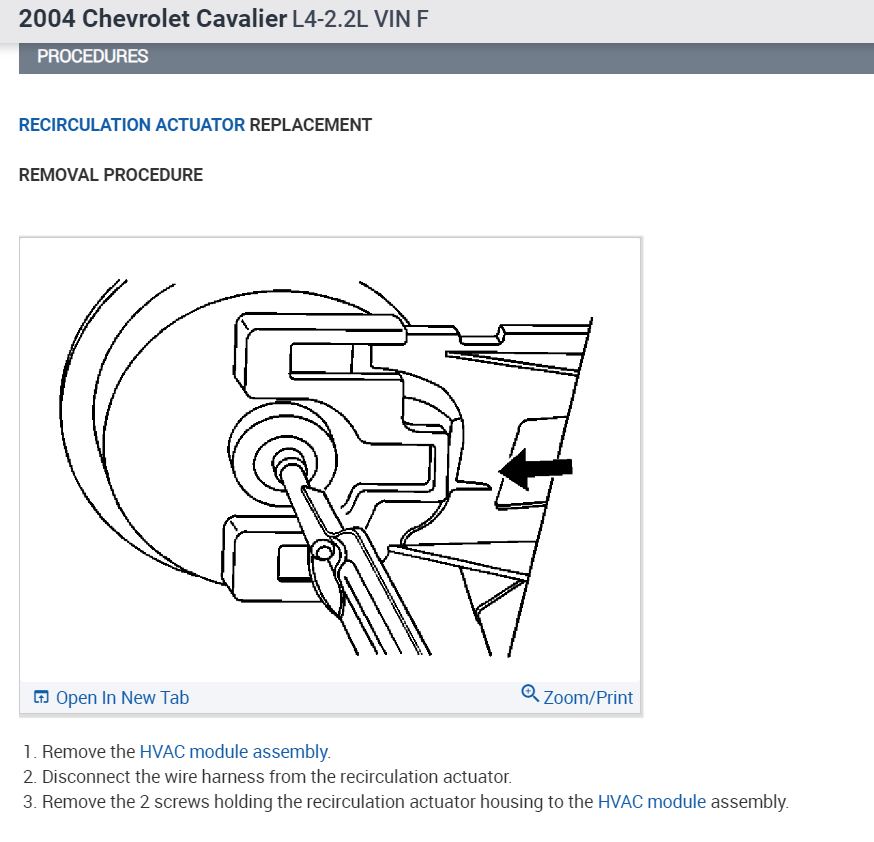

It sounds like you may have a vacuum leak under the hood near the engine that feeds the HVAC system. It will be a small line like the one in this guide.
https://www.2carpros.com/articles/air-vents-stay-in-the-defrost-position
Lift the hood and use a flashlight to see if you can find the vacuum feed line to make sure it is working. Also, you can remove the vacuum line for the recirculation blend door actuator to see if vacuum is present when the engine running, here is the actuator location in the images below. Check out the images (below). Let us know what happens and please upload pictures or videos of the problem.
