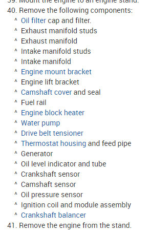

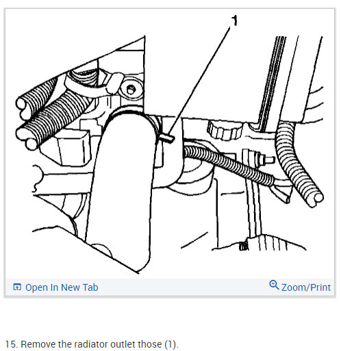

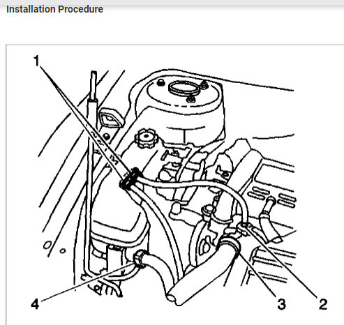

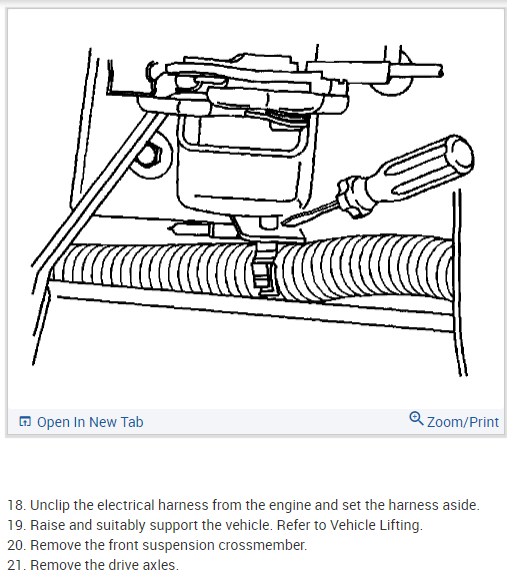

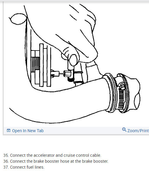

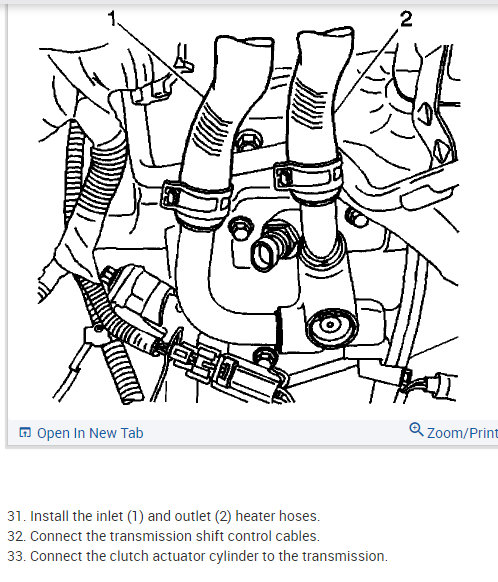

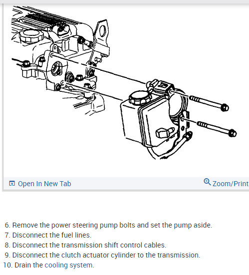

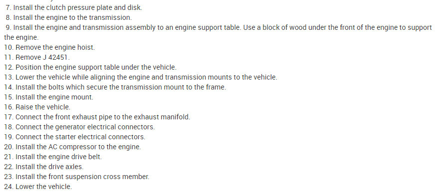

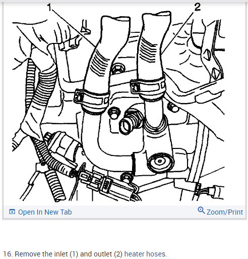

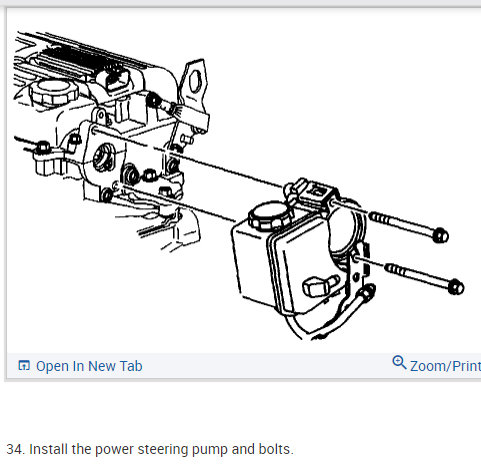

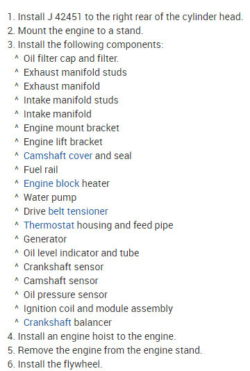

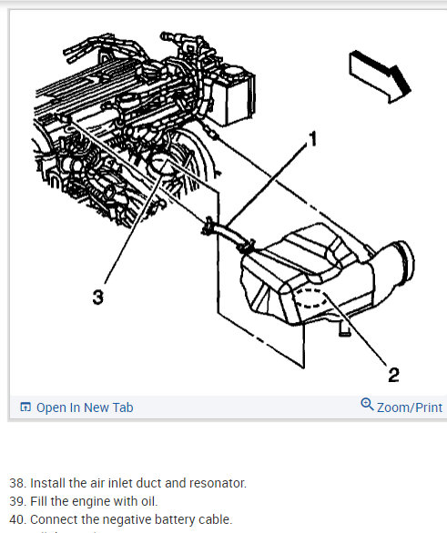

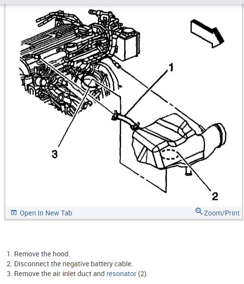

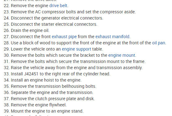

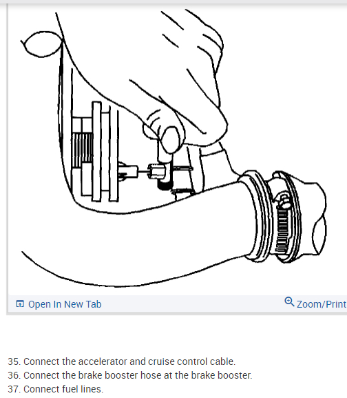

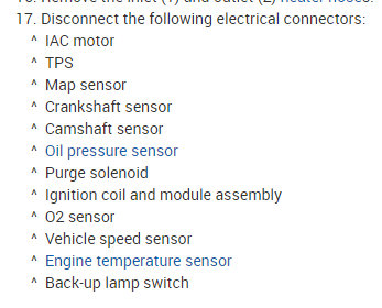

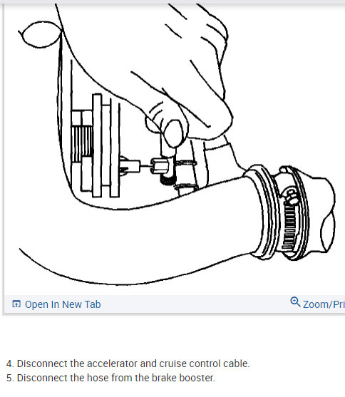

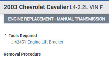

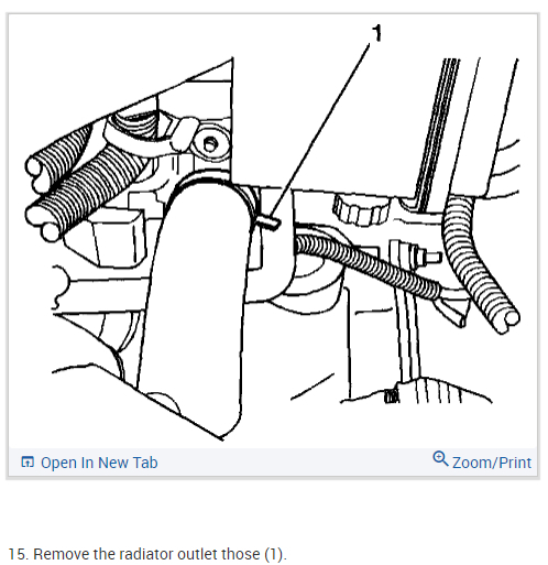

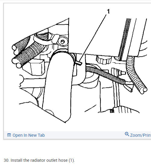

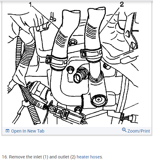

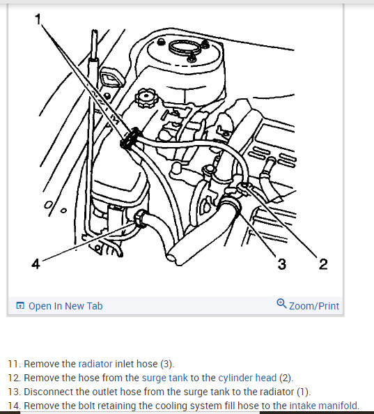

Here is the information you requested on engine removal and replacement. I've attached picture steps below showing instructions for engine replacement on your car. Hope this helps and thanks for using 2CarPros.
