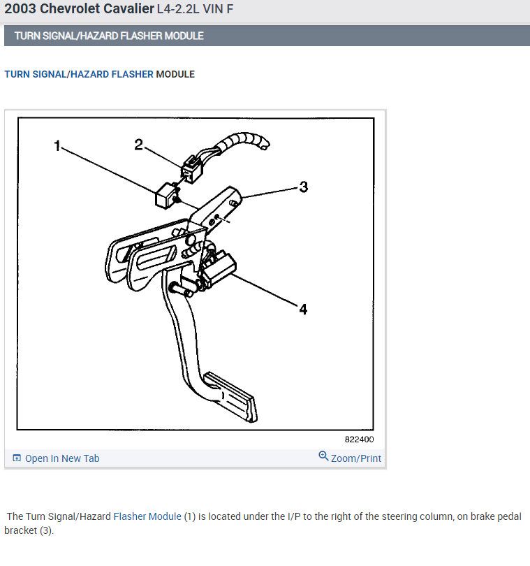

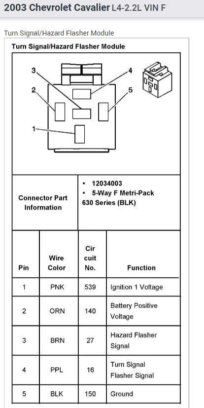

The same relay controls the turn signal and the hazard flasher.
However there are separate pins for these functions. You could have the pin for the turn signals burnt out.

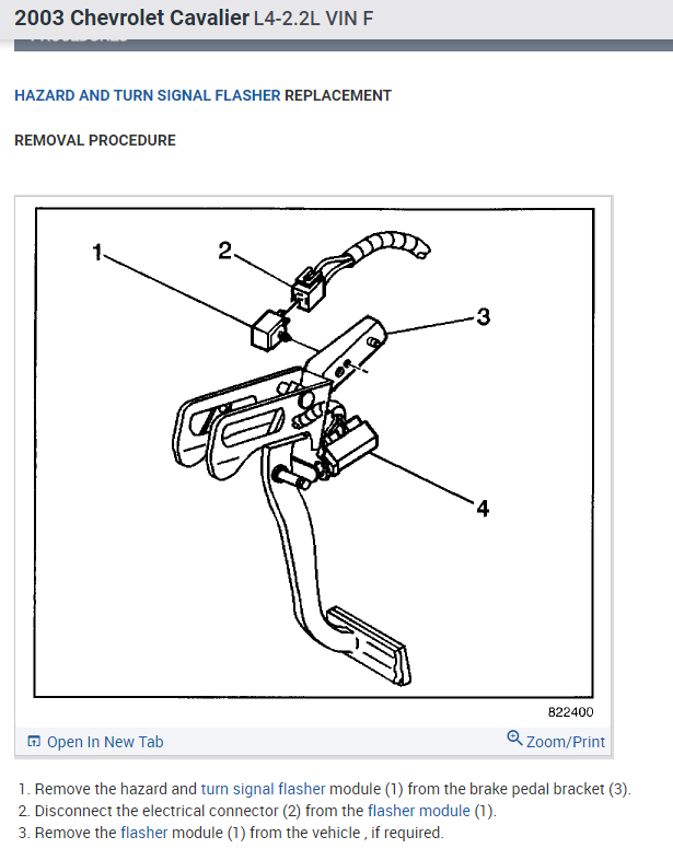

The Turn Signal/Hazard Flasher relay is located under the driver side instrument panel, to the right side of the steering column. (see picture below).
Here is a guide of how to test relays:

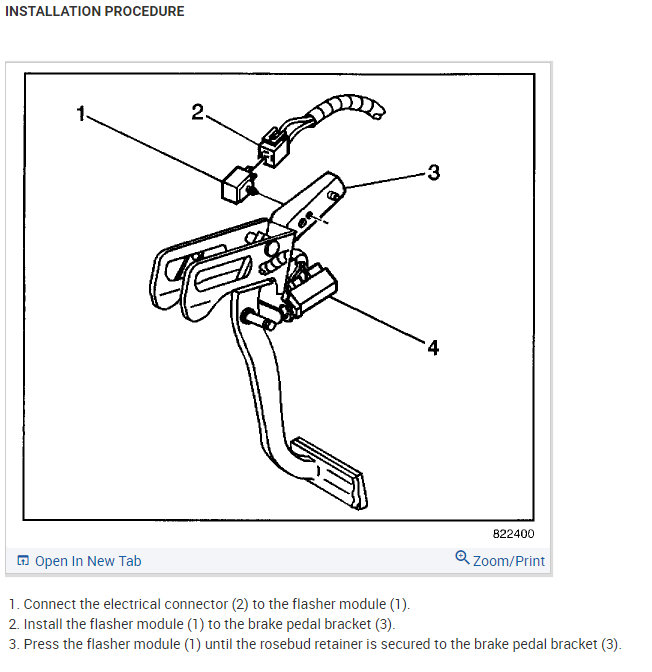

I have also attached the replacement procedure for the flasher relay.
