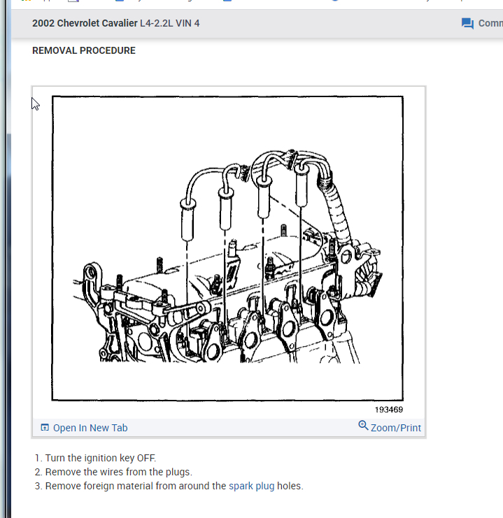

I just need to know what the spark plug gap should be on my car it has the 2.2 liter engine. Can you show me how to replace the spark plugs?
Mar 14, 2010 at 4:31 PM
RASMATAZ
CERTIFIED EXPERT
75,992 POSTS

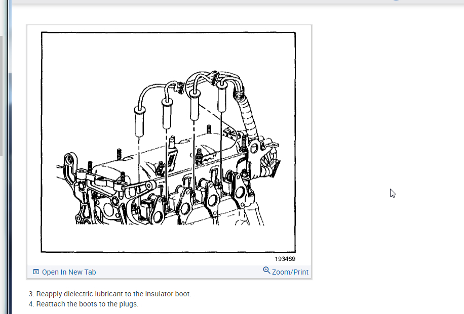

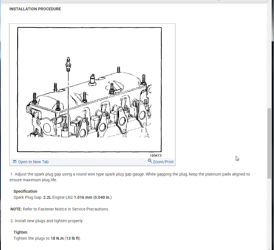

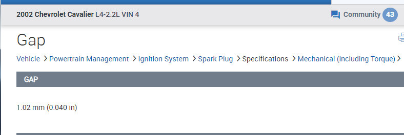

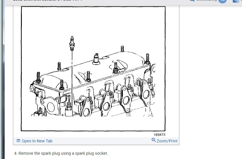

The gap should be .040. Check out the diagrams (below). Please let us know what you find.
Mar 14, 2010 at 4:41 PM
CERTIFIED EXPERT
18,907 POSTS
I am attaching the entire procedure on how to replace the plugs for this engine which includes the gap spec that is listed above as well as the torque specs.
