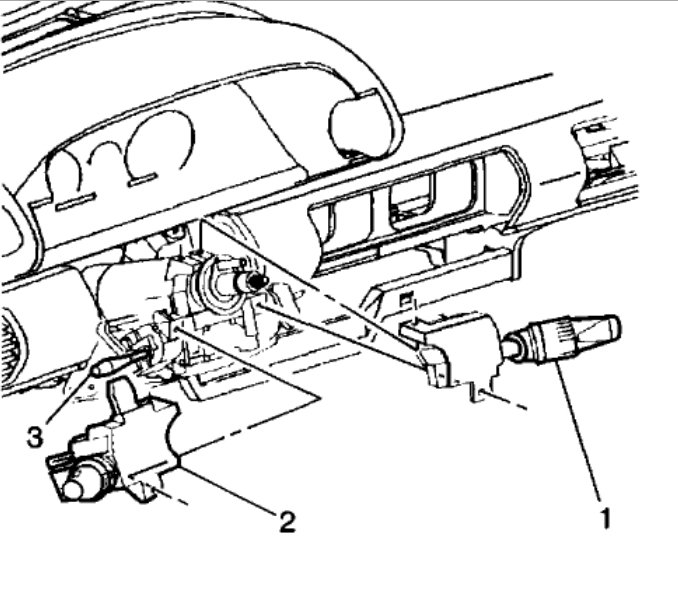

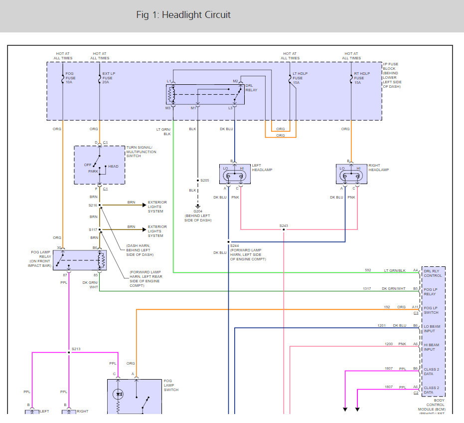

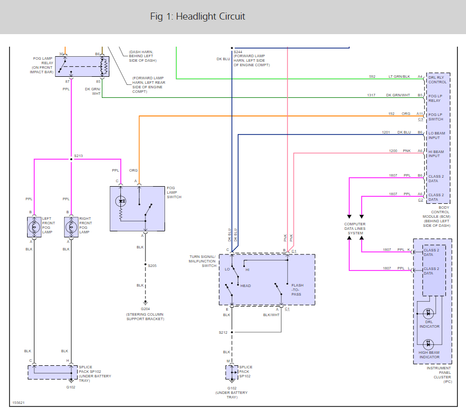

It sounds like you have a a headlight control switch that is out. Here are the headlight wiring diagrams so you can see how the system works.
Test for power output of the switch to confirm the failure.

Suspect faulty multi-function switch

I went and bought a new multi-function switch. I am now able to turn the high beams off but i still have no drl or low beams. any other suggestions?

Check splice connector 102 under battery tray known problem due to corrison will interupt ground for LOW and DRL

MAYBE THIS DIAGRAM WITH HELP YOU....IT'S FROM "MITCHELL I", AND IT'S EZ TO READ
IF YOU CANNOT SEE IT WELL---TELL ME
I CAN INITIATE A WAY TO GET YOU THE ORIGINAL DOWNLOAD WITHOUT YOU BLURTING OUT YOUR EMAIL ADDRESS IN OPEN FORUM!
HERE IT IS
THE MEDIC
