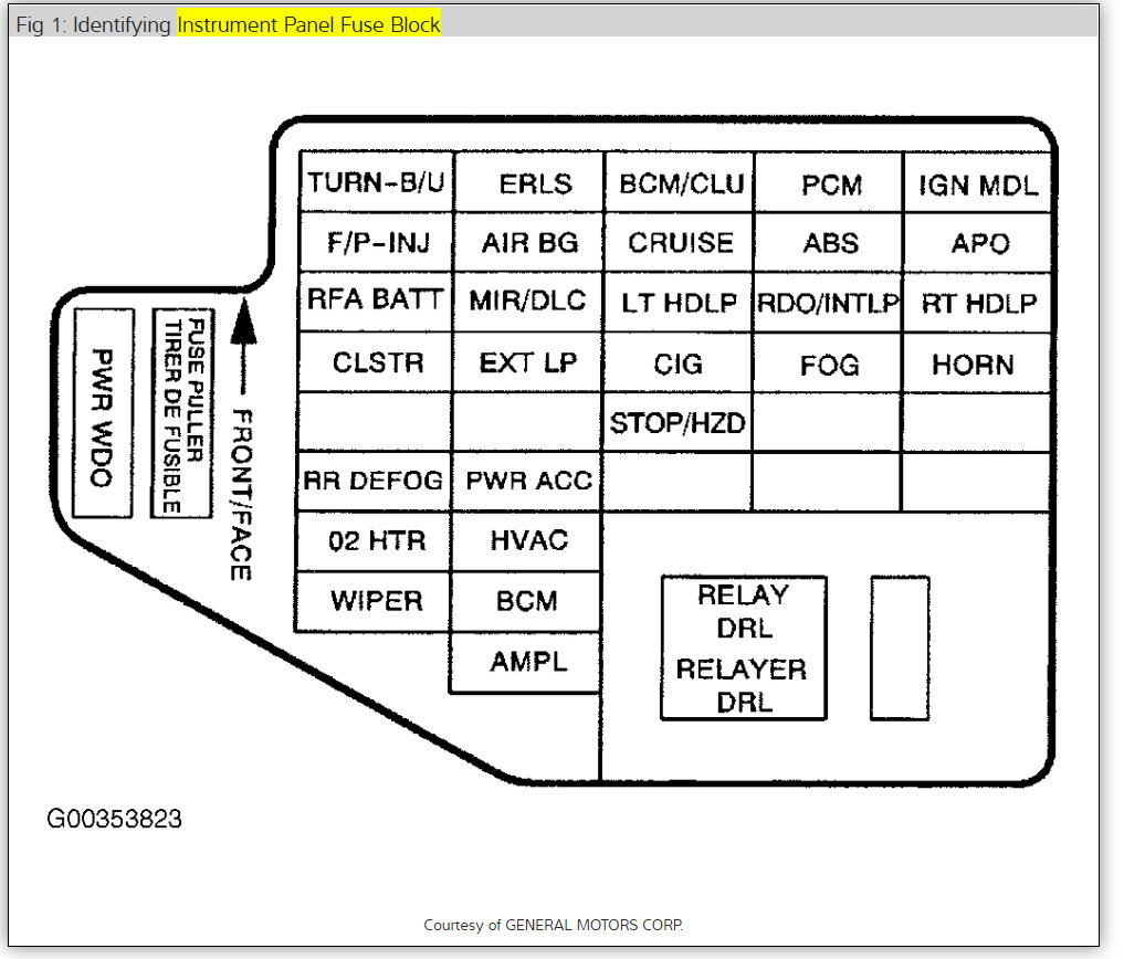

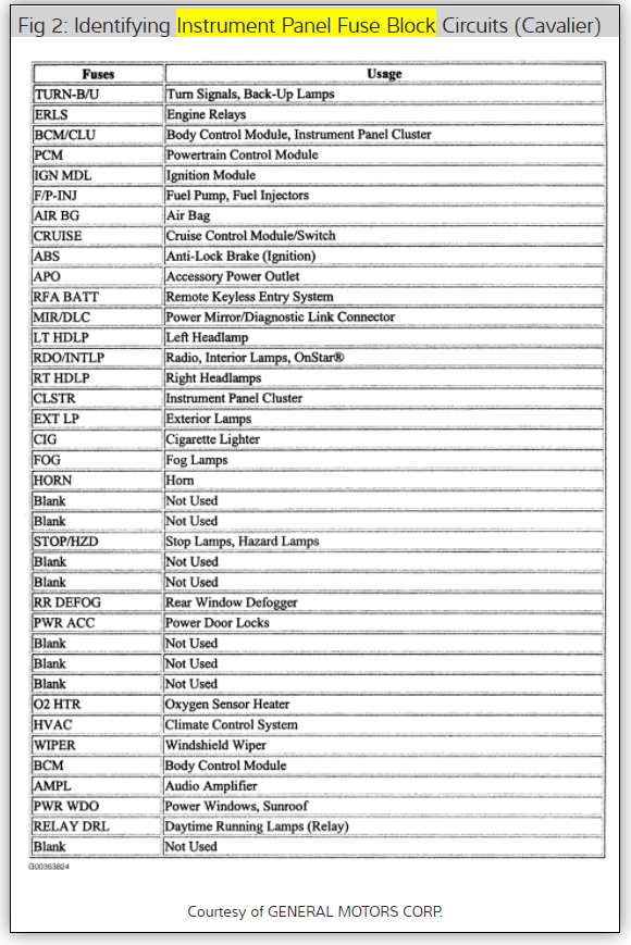

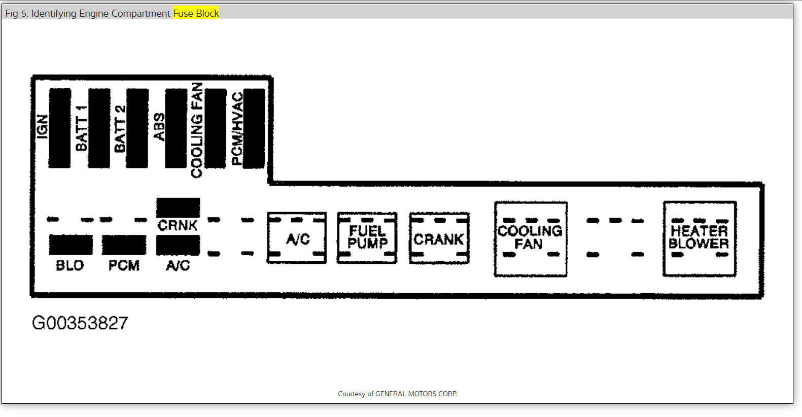

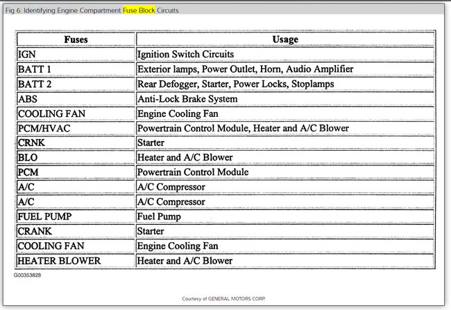

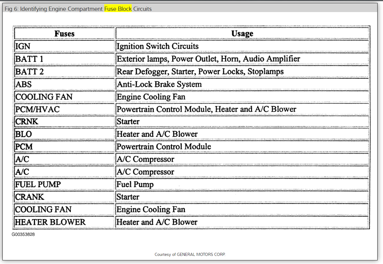

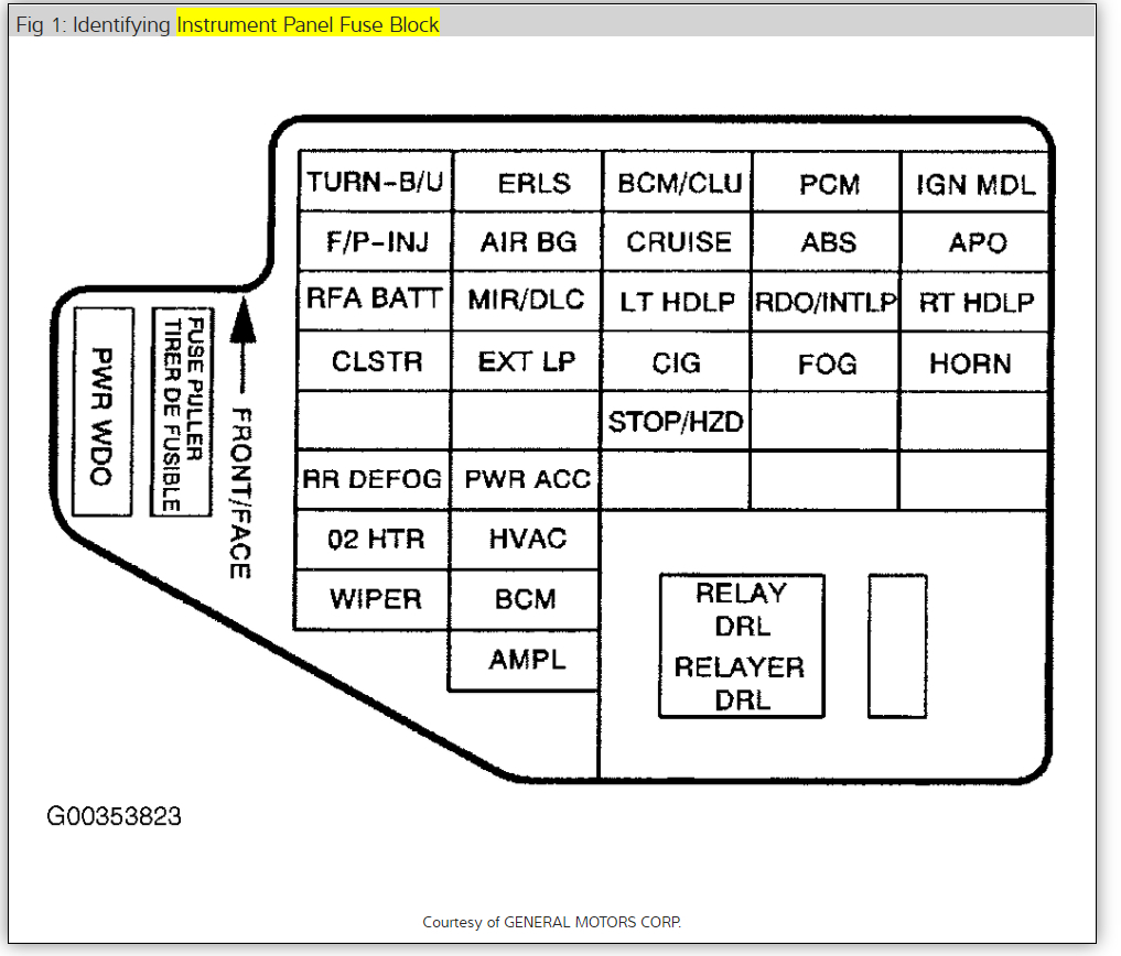

Any fuse you checked, did you use a voltage tester on the fuse circuit? Even if the fuse is good, if no voltage on the circuit, the circuit is dead. Usually the problem is in the steering column/steering wheel. You need to disarm the air-bag, where applicable, before trying to work on it.
https://www.2carpros.com/forum/automotive_pictures/170934_cavalier_horn_diagram_1.jpg
Check out the diagrams (Below). Please let us know what happens.
