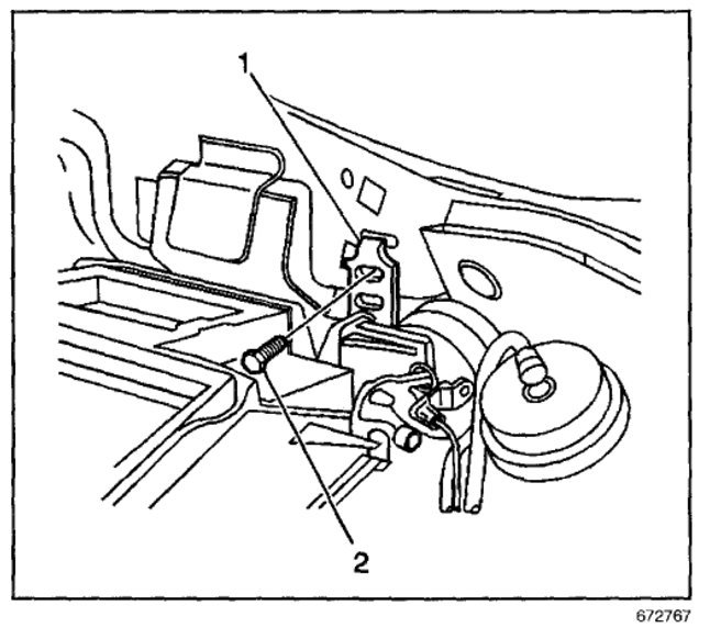

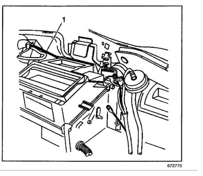

You will need to drain the coolant first and disconnect the battery. Also you will need to vacuum down and then recharge the ac system when you are done. Here is a guide for that.
Here is a guide that will give you an idea of what you are in for when doing the job.
https://www.2carpros.com/articles/replace-heater-core
Here are some diagrams (below) of your car to help you get the job done

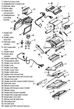

Take a look at the attached pic and let me know if it helps. It shows the entire unit in an exploded view. Hopefully, you can see something that needs removed.
Jun 12, 2017 at 3:48 PM (Merged)

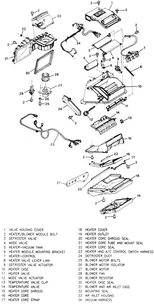

Here are the directions. Also, I have attached an exploded view of the system. I hope it helps.
Disable the SIR system.
Disconnect the negative battery cable.
Properly drain the cooling system.
Raise and safely support the vehicle.
Detach the heater hoses from the heater core.
Carefully lower the vehicle.
Remove the instrument panel. For details, please refer to the procedure located in Body & Trim of this guide.
Remove the DERM with the attaching bracket.
Detach the heater core cover.
Unfasten the heater core mounting clamps, then remove the heater core.
To install:
Position the heater core, then secure with the mounting clamps.
Attach the heater core cover.
Install the DERM with the attaching bracket.
Install the instrument panel
Connect the heater hoses to the core.
Properly refill the engine cooling system and check for leaks.
Enable the SIR system.
Connect the negative battery cable, then start the engine and check for proper system operation and/or leaks.
This is the only exploded view picture I could find of the system. I hope it helps. It shows the entire system.

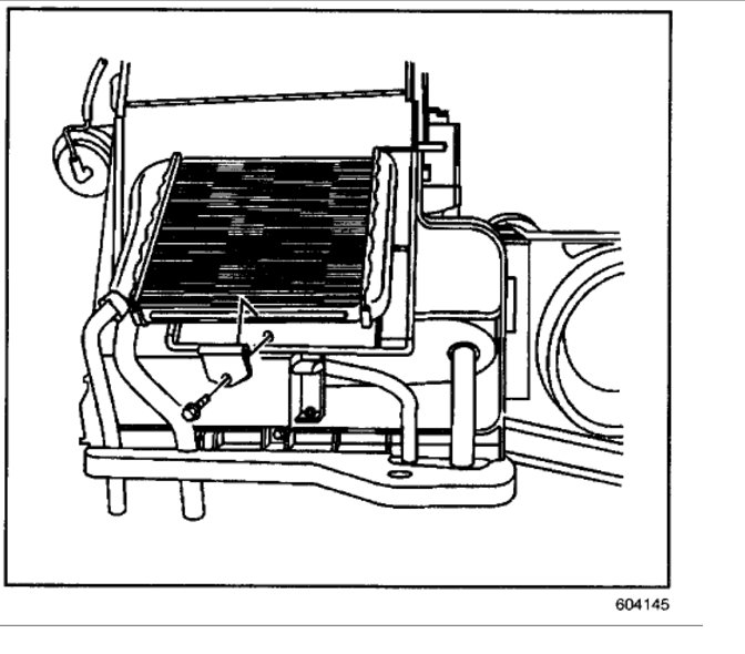

HEATER CORE REPLACEMENT
REMOVAL PROCEDURE
Remove the HVAC module. See: Housing Assembly HVAC\Service and Repair
Turn the HVAC module over.
Remove the heater core case cover screws and cover.
Remove the heater core bracket screws and brackets.
Remove the heater core.
