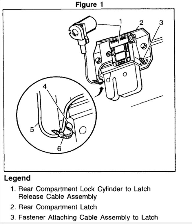

What are some repairing tips i can try to repair my trunk release latch on my own and avoid having to take it to a mechanic for repair? When i pull the release latch, it does not function at all, meaning the trunk remains closed and i have to open it manually. What can I do to check to see if its just a loose cable and what i can do/try to fix this problem or if it is damaged beyond repair? Please help.

There is a service bulletin on this problem, Here is what it says with the diagrams (below) to help you fix the problem.
File In Section: 10 - Body
Bulletin No.: 83-15-22
Date: December, 1998
Subject:
Rear Compartment (Trunk) Lid Latch Difficult to Unlock/Open
(Inspect/Replace Cable and Secure with Strap)
Models:
1995-99 Chevrolet Cavalier
1995-99 Pontiac Sunfire
without RPO AUO (Remote Keyless Entry System)
Condition
Some customers may comment that the rear compartment (trunk) lid is difficult to unlock with the key.
Cause
The tab on the cable assembly that secures it to the latch assembly may have broken. When this occurs, the cable may disengage from the latch.
Correction
Using the following procedure, inspect the tab on the cable assembly for signs of breakage. Replace the cable assembly if the tab is broken. If the tab is not broken, reinstall the cable to the latch. Secure the cable to the latch assembly with plastic strap.
Service Procedure

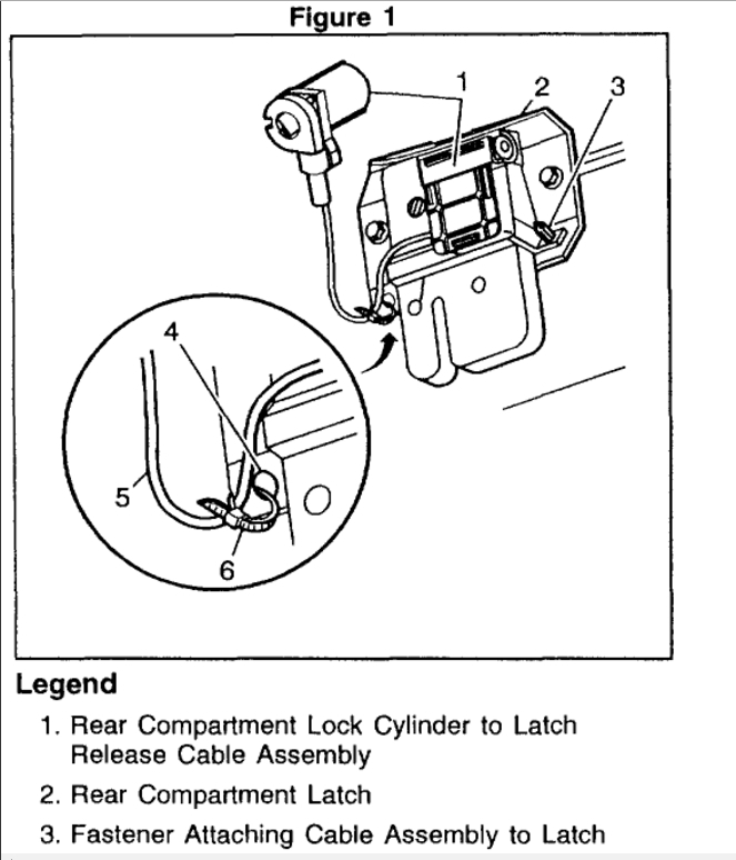

1. Open the rear compartment lid to access the latch on the inside.
2. Remove the fastener securing the cable to the latch (see Figure 1).

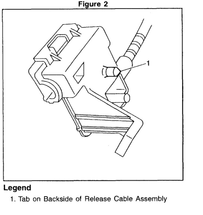

3. Inspect the tab on the backside of the cable for signs of breakage (see Figure 2).
If the tab has NOT disengaged from the latch after removing the fastener, the tab is in acceptable condition and it is NOT necessary to replace the cable assembly. Reinstall the fastener that secures the cable assembly to the latch.

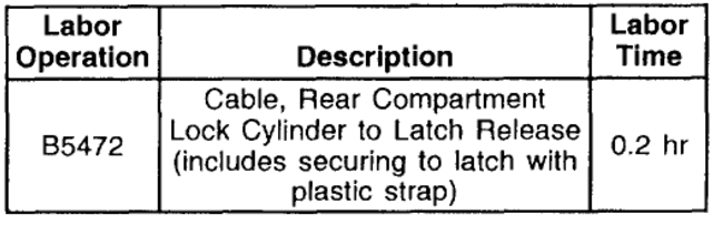

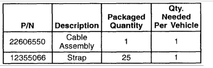

If the tab HAS disengaged from the latch after removing the fastener, the tab is broken and the cable assembly must be replaced with a new cable, P/N 22606550. See the appropriate Service Manual for information on replacing the cable assembly.
4. Using one (1) plastic strap, P/N 12355066, secure the cable portion of the assembly to the latch as shown in Figure 1.
5. Trim off excess strap material.
Parts Information
Parts are currently available from GMSPO.

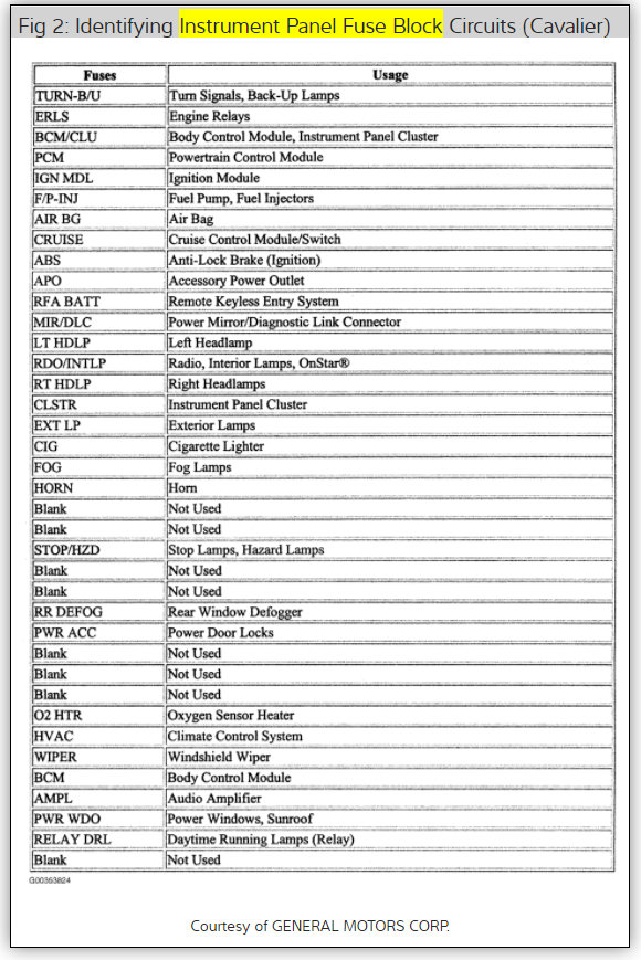

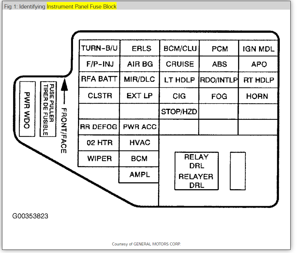

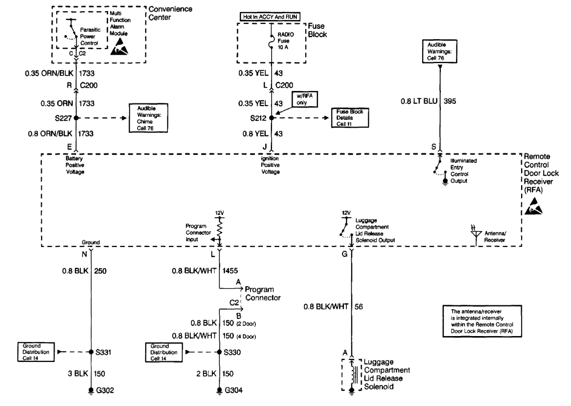

HMAC300
  • 48,601 POSTS

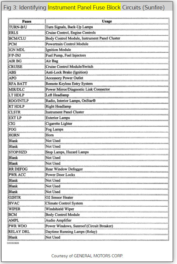

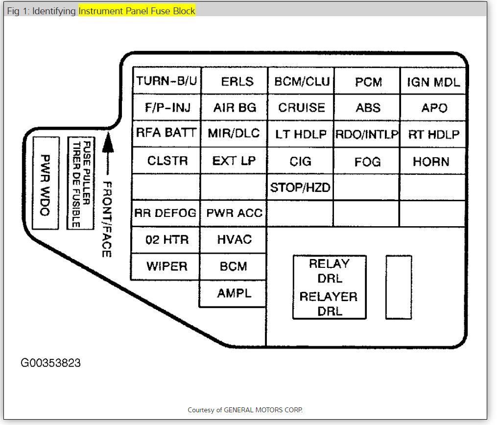

There is a radio fuse that needs to be checked because it power the release latch. Here is a guide to help and the trunk wiring diagrams so you can see how it works with the fuse location as well.
Aug 17, 2019 at 1:31 PM (Merged)
BOOPERIII
Thank you for this post I had this problem the fuse was blown all fixed I love this site.
