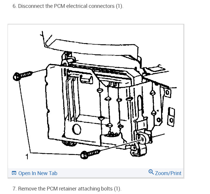

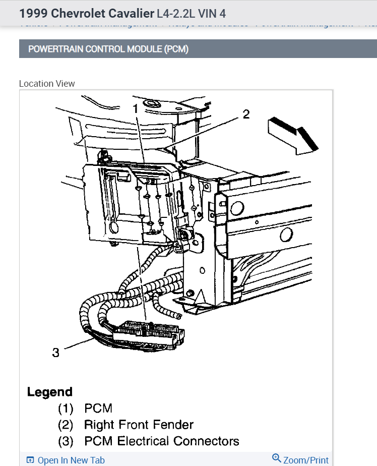

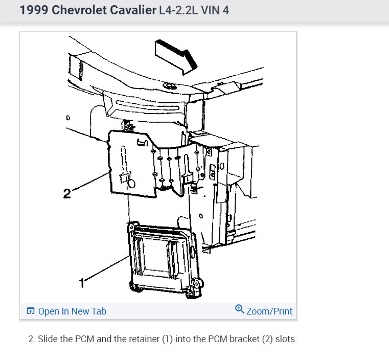

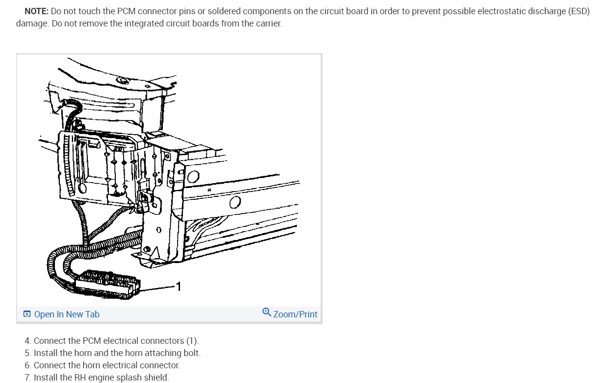

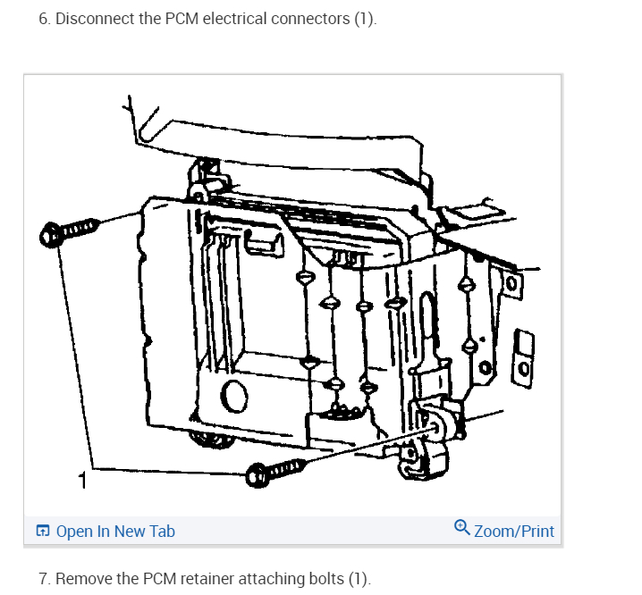

I just bought a new 'used' ecm computer for my car, do you know where this computer is located on my car? Thanks!
Mar 23, 2009 at 5:00 PM
BLUELIGHTNIN6
  • 16,542 POSTS

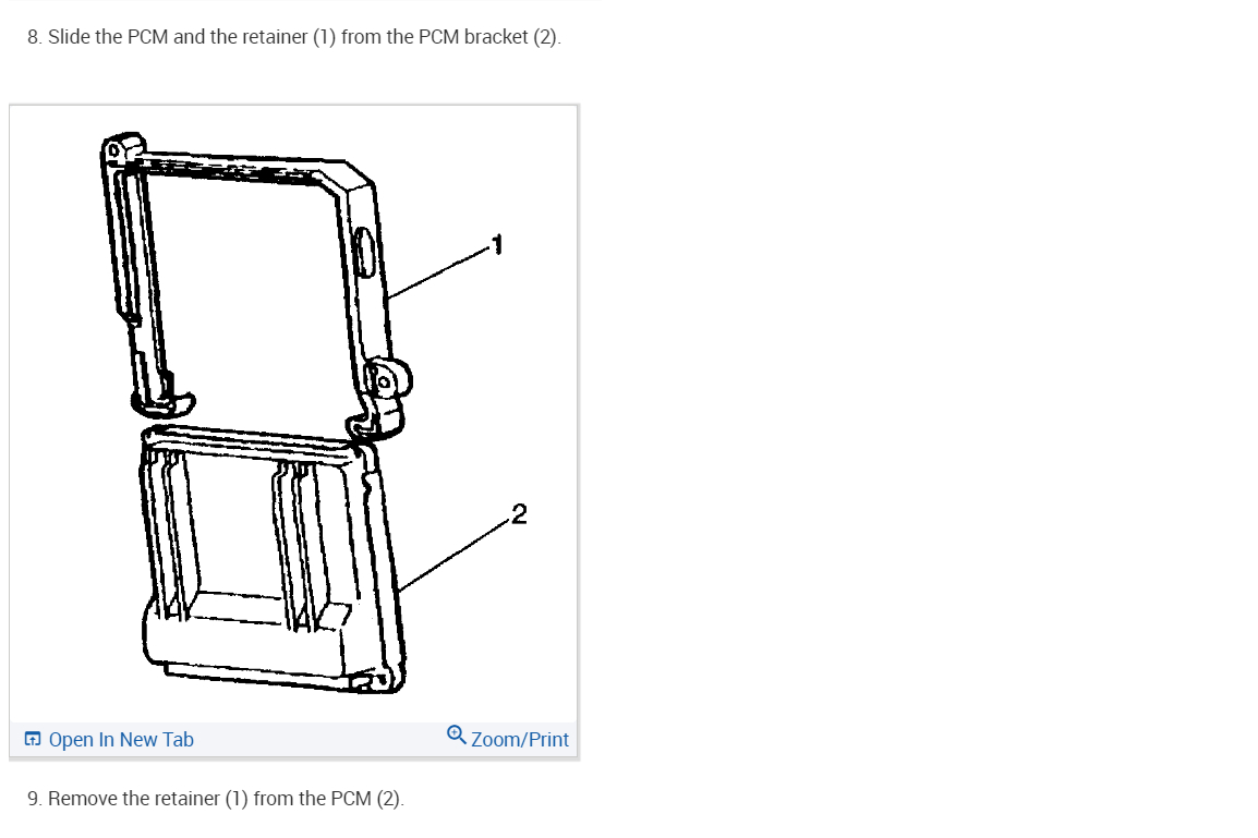

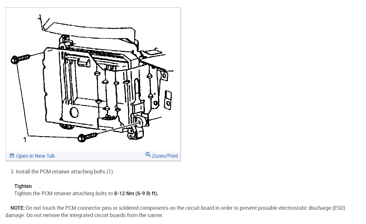

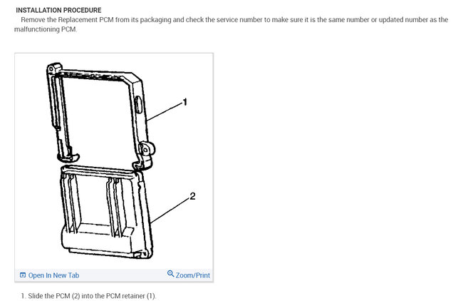

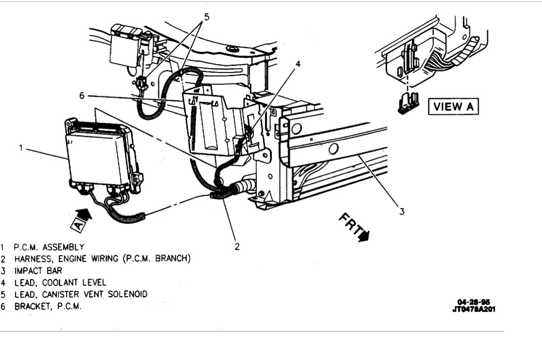

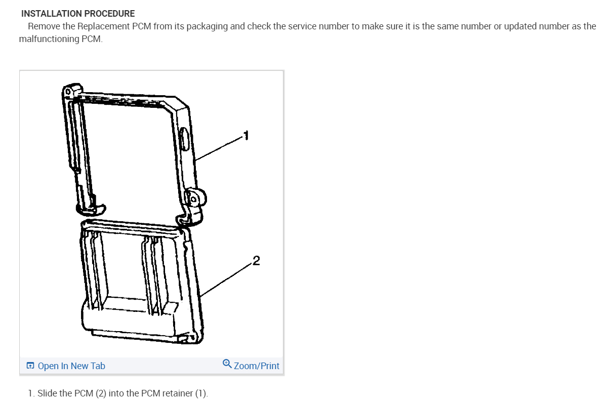

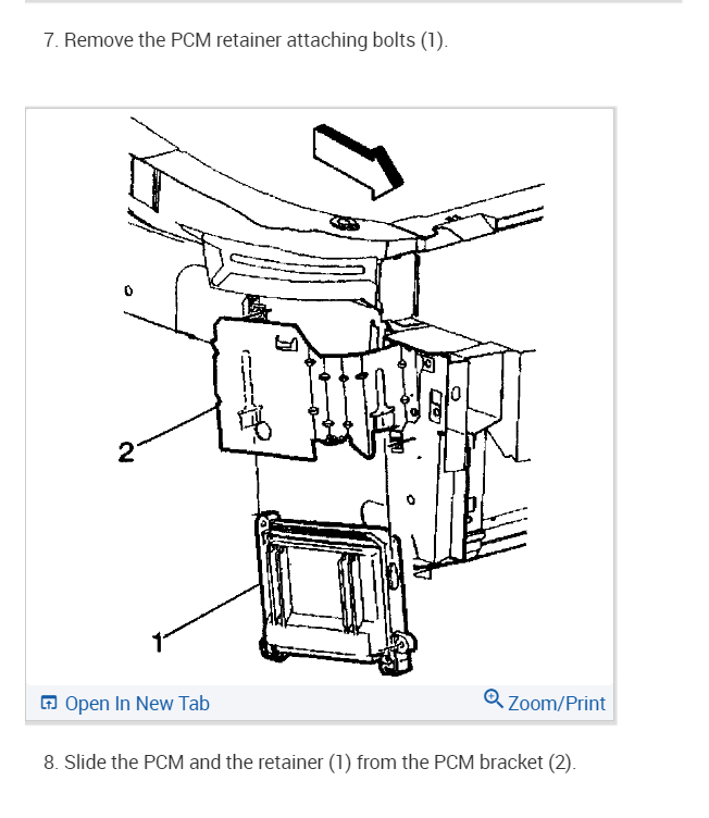

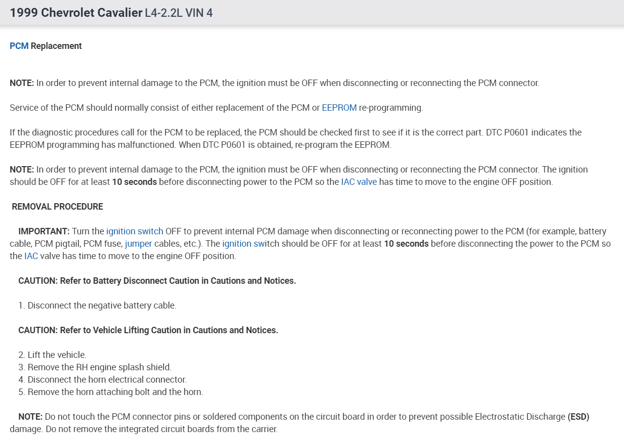

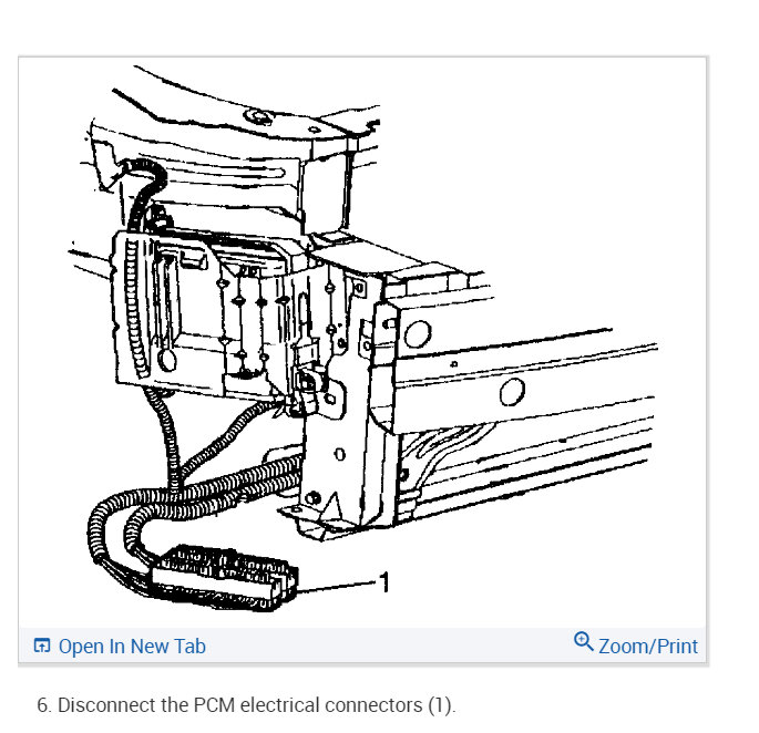

Your vehicle's powertrain control module ( AKA electronic control module) is located on the right front of the engine compartment. Underhood near RF fender, here are the instructions on how to change it out and it shows the location in the images below.
Mar 23, 2009 at 5:13 PM

Behind the right front headlight, at C1.

In the right front of the engine compartment on the frame rail.

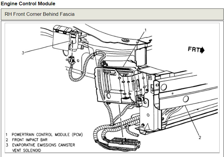

i was told i need anew computer my q is where it is located. i was told its behind the fender adjacent to evap canister. Is this right i cant see it and do i have to take the fender off? please help
Jan 13, 2020 at 8:45 PM (Merged)
It looks like it is down low in the front of the car, you might need to jack the car up before doing the
removal.
Here is a diagram on its location (below)
