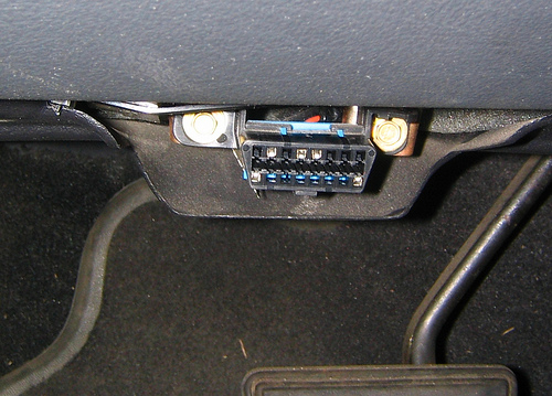

> Have you ever tried to retrieve for trouble codes?
No, and I can't do this easily at Autozone, etc. because it's not compatible. Maybe I can buy my own checker?

The DLC shown seems to be OBD-II but scanners comes in different standards so it is not surprising if Autozone does not have the correct one.
If you get any scanner, it should be equivalent to J-39200 standard.
