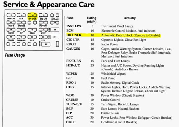

is there a way to disable the automatic door lock feature on a 1994 Chevy Cavalier Wagon? My elderly mother refuses to get rid of the car and I just want the car to lock manually only.
Aug 7, 2010 at 1:15 PM
MARTINLETECH
I have the same issue, so check the picture for the solution. In the user manuel of the 1994 Cavalier, it's clearly indicate "If you don’t want the doors to automatically unlock whenth e key is
turned to the OFF position, you can remove the Automatic Door Unlock
fuse. For fuse location, see the Index under Fuse Usage"
