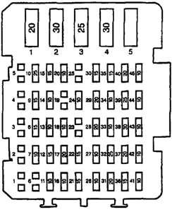

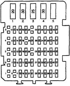

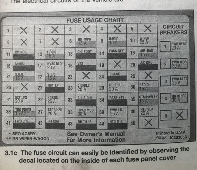

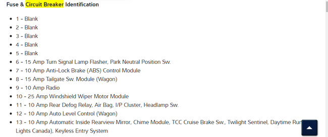

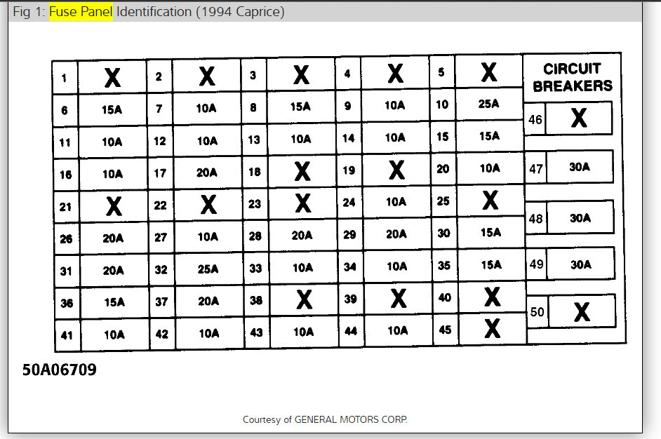

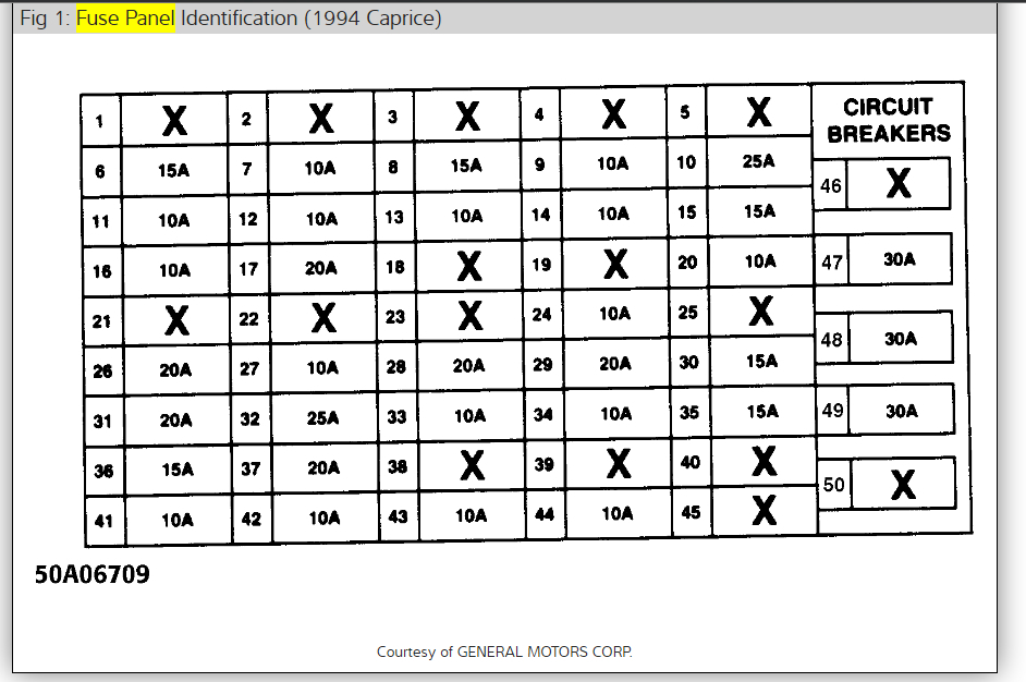

Hi, I need a fuse box for the car listed above and an abbreviation! Thank you
Aug 11, 2019 at 2:43 PM
SCGRANTURISMO
  • 4,897 POSTS
I have included for you in the diagrams down below the information that you have requested. I have included the fuse panel diagram and callout for your vehicle. Please go through these diagrams and get back to us with what you are able to find.

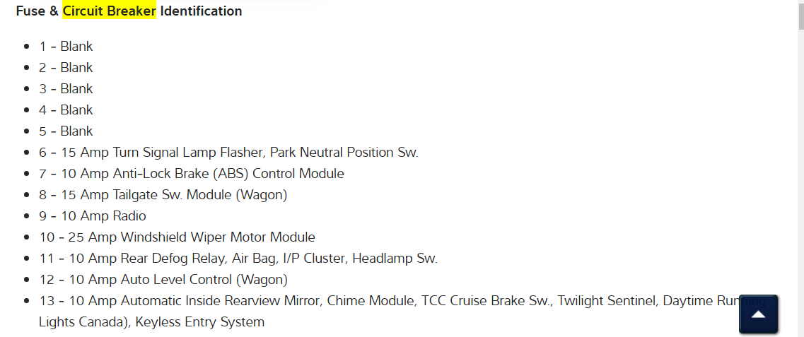

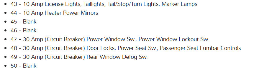

I need.
Aug 11, 2019 at 3:08 PM
  • 0 POST
Description.
Aug 11, 2019 at 3:14 PM
SCGRANTURISMO
  • 4,897 POSTS

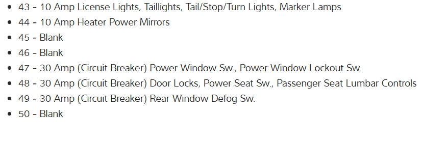

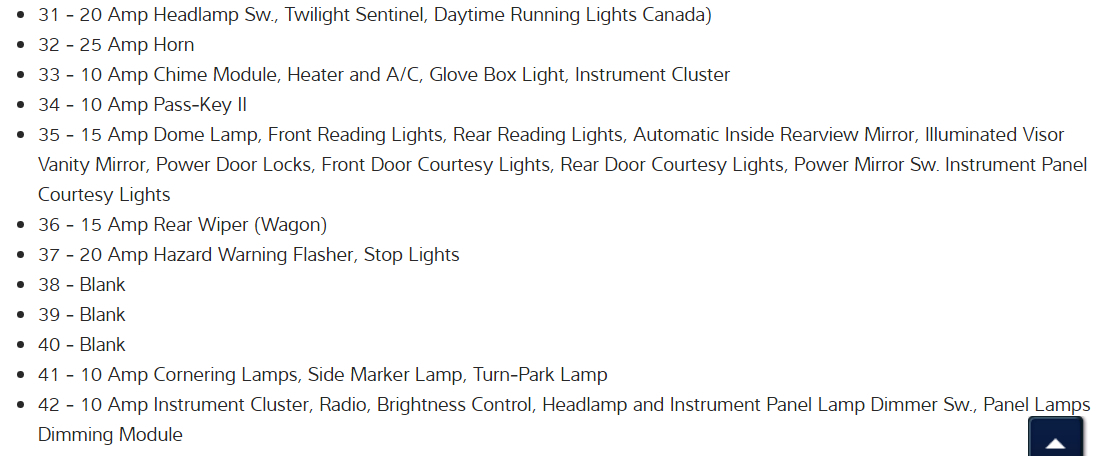

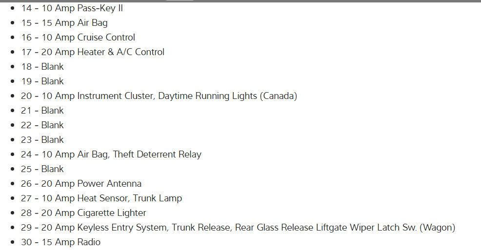

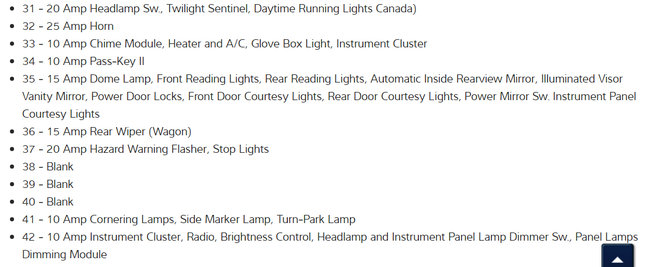

Hello again,
Sorry about that. I don't know why the callout didn't get sent. Here it is in the diagrams down below.
