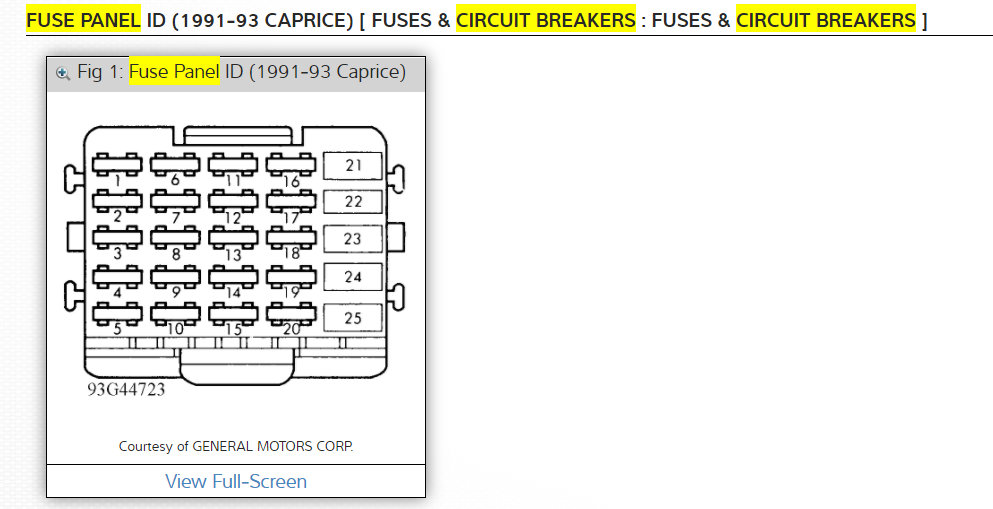

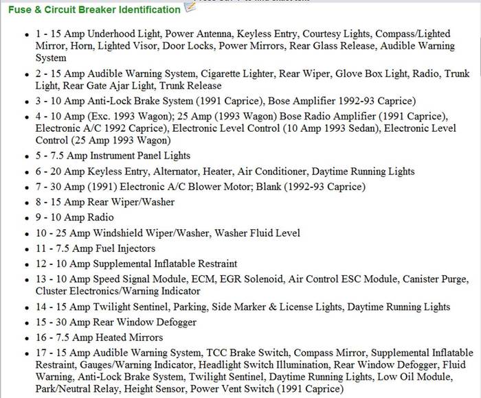

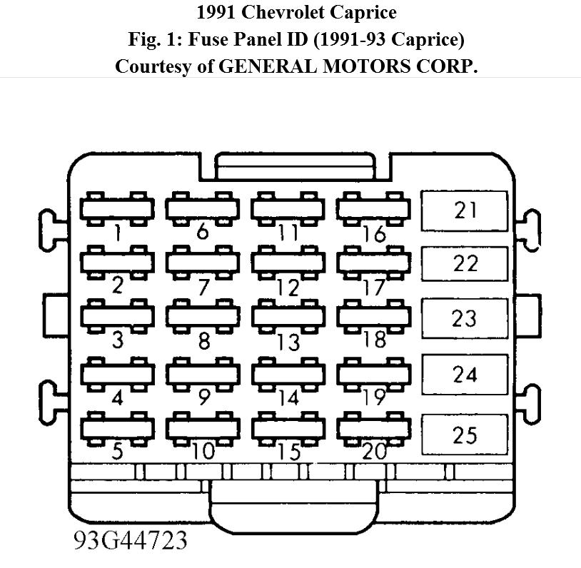

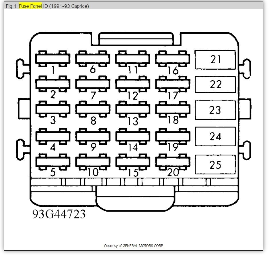

Here is the complete fuse panel and descriptions. (BELOW)

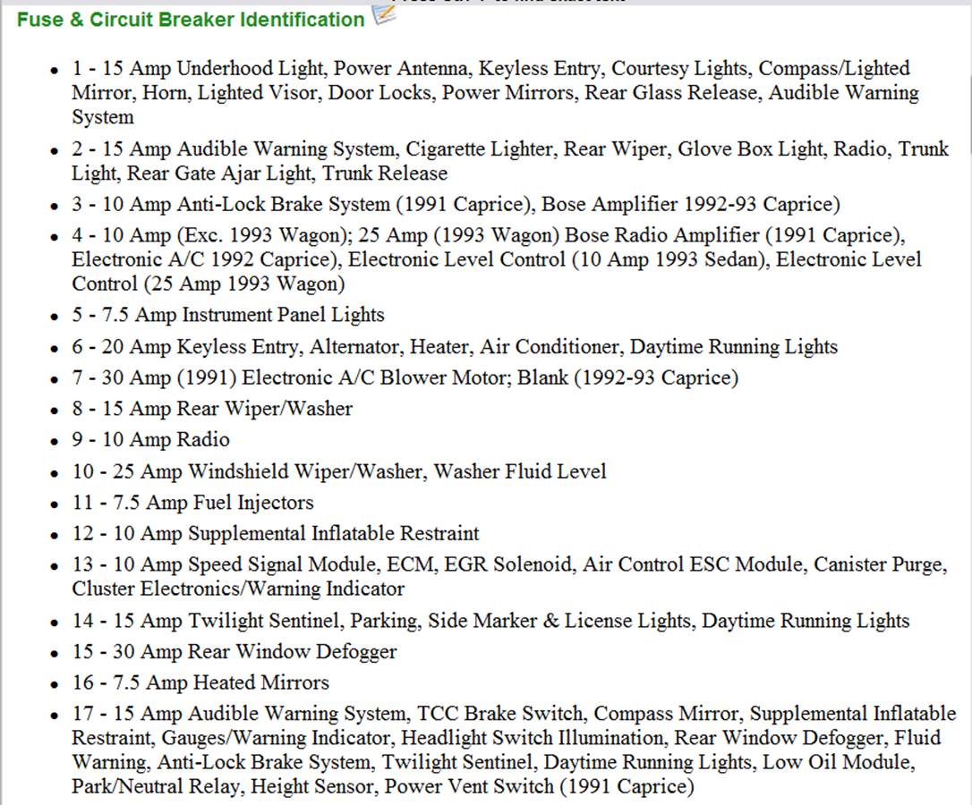

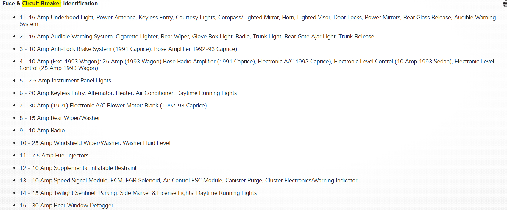

1 - 15 Amp Underhood Light, Power Antenna, Keyless Entry, Courtesy Lights, Compass/Lighted Mirror, Horn, Lighted Visor, Door Locks, Power Mirrors, Rear Glass Release, Audible Warning System
2 - 15 Amp Audible Warning System, Cigarette Lighter, Rear Wiper, Glove Box Light, Radio, Trunk Light, Rear Gate Ajar Light, Trunk Release
3 - 10 Amp Anti-Lock Brake System (1991 Caprice), Bose Amplifier 1992-93 Caprice)
4 - 10 Amp (Exc. 1993 Wagon); 25 Amp (1993 Wagon) Bose Radio Amplifier (1991 Caprice), Electronic A/C 1992 Caprice), Electronic Level Control (10 Amp 1993 Sedan), Electronic Level Control (25 Amp 1993 Wagon)
5 - 7.5 Amp Instrument Panel Lights
6 - 20 Amp Keyless Entry, Alternator, Heater, Air Conditioner, Daytime Running Lights
7 - 30 Amp (1991) Electronic A/C Blower Motor; Blank (1992-93 Caprice)
8 - 15 Amp Rear Wiper/Washer
9 - 10 Amp Radio
10 - 25 Amp Windshield Wiper/Washer, Washer Fluid Level

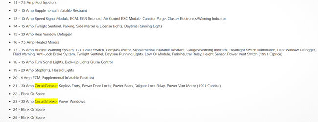

11 - 7.5 Amp Fuel Injectors
12 - 10 Amp Supplemental Inflatable Restraint
13 - 10 Amp Speed Signal Module, ECM, EGR Solenoid, Air Control ESC Module, Canister Purge, Cluster Electronics/Warning Indicator
14 - 15 Amp Twilight Sentinel, Parking, Side Marker & License Lights, Daytime Running Lights
15 - 30 Amp Rear Window Defogger
16 - 7.5 Amp Heated Mirrors
17 - 15 Amp Audible Warning System, TCC Brake Switch, Compass Mirror, Supplemental Inflatable Restraint, Gauges/Warning Indicator, Headlight Switch Illumination, Rear Window Defogger, Fluid Warning, Anti-Lock Brake System, Twilight Sentinel, Daytime Running Lights, Low Oil Module, Park/Neutral Relay, Height Sensor, Power Vent Switch (1991 Caprice)

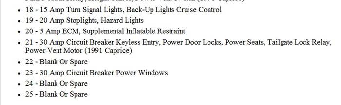

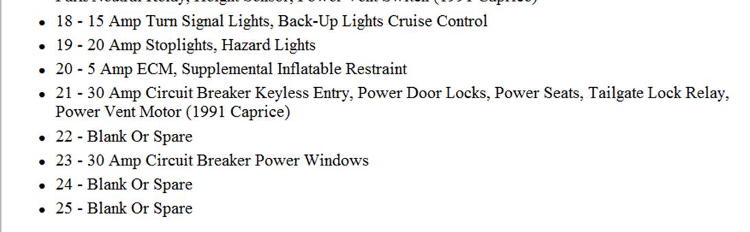

18 - 15 Amp Turn Signal Lights, Back-Up Lights Cruise Control
19 - 20 Amp Stoplights, Hazard Lights
20 - 5 Amp ECM, Supplemental Inflatable Restraint
21 - 30 Amp Circuit Breaker Keyless Entry, Power Door Locks, Power Seats, Tailgate Lock Relay, Power Vent Motor (1991 Caprice)
22 - Blank Or Spare
23 - 30 Amp Circuit Breaker Power Windows
24 - Blank Or Spare
25 - Blank Or Spare
