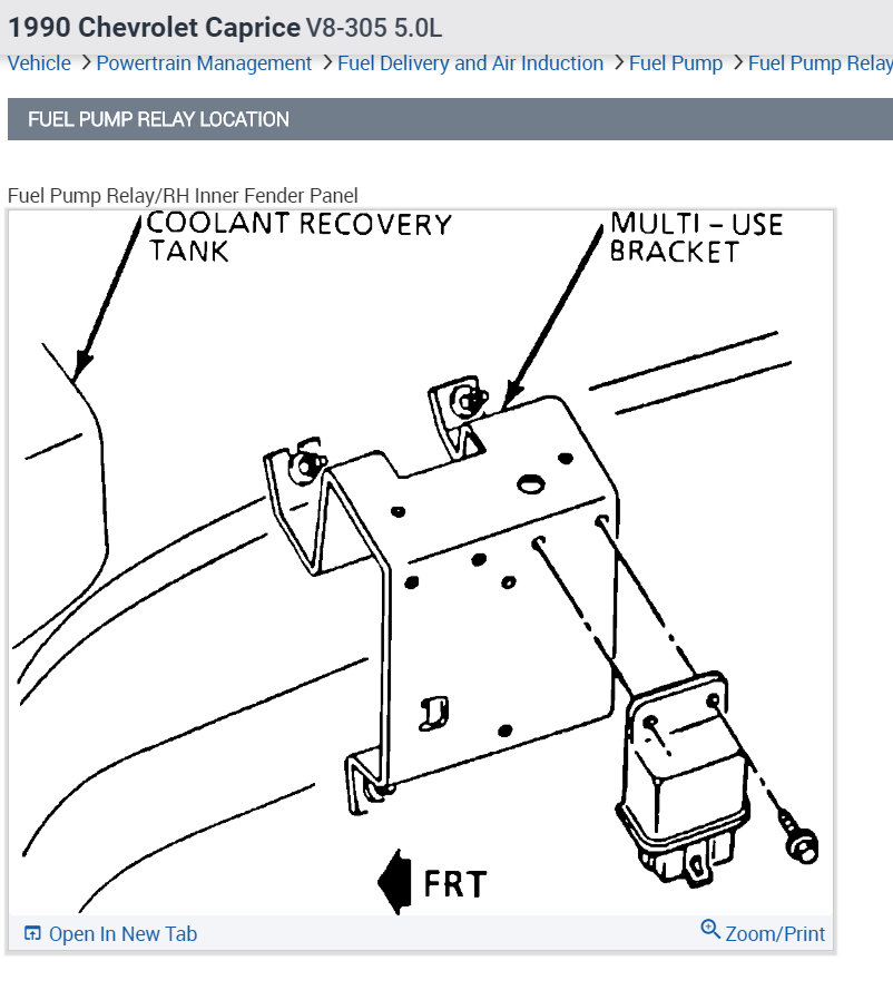

someone help! i have changed the fuel pump the fuse in my 90 caprice it is fuel injected with a two barrel and the pump still will not come on i bypass the relay and it works but the injectors will not keep it running i changed the relay,pump and fuse and that wasn't it either and i missing?

Check for spark if none then injectors will not spray. Here is a guide to help test the fuel pump relay with the location in the diagrams below.
