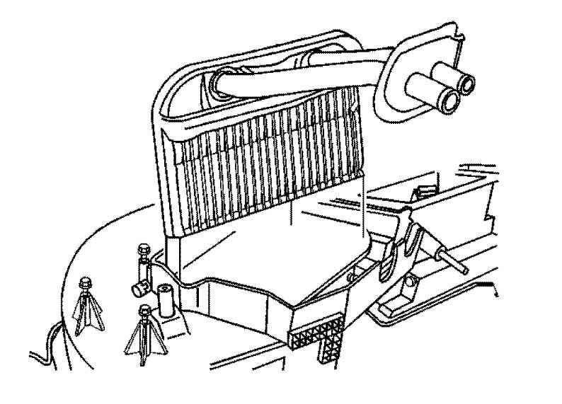

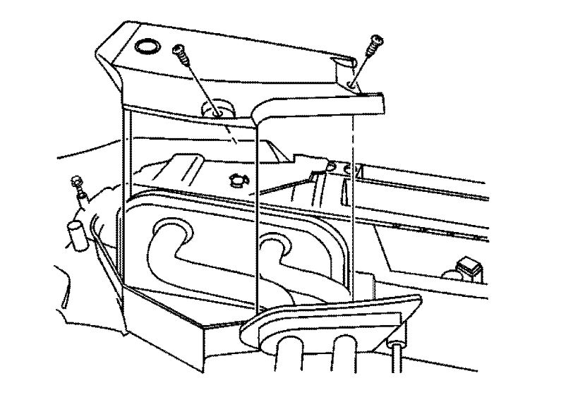

Heater Core Replacement
1. Remove the heater/vent module. Refer to Heater/Vent Module Replacement .
2. Remove the heater core access cover screws.
3. Remove the heater core access cover.
4. Remove the heater core from the heater/vent module.
