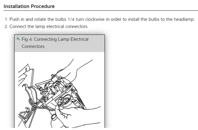

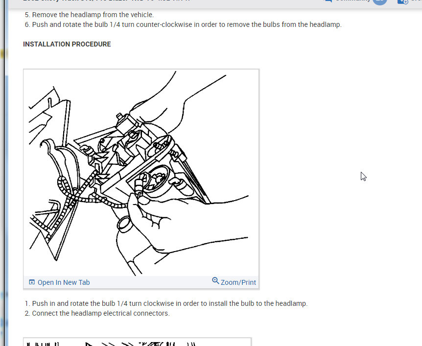

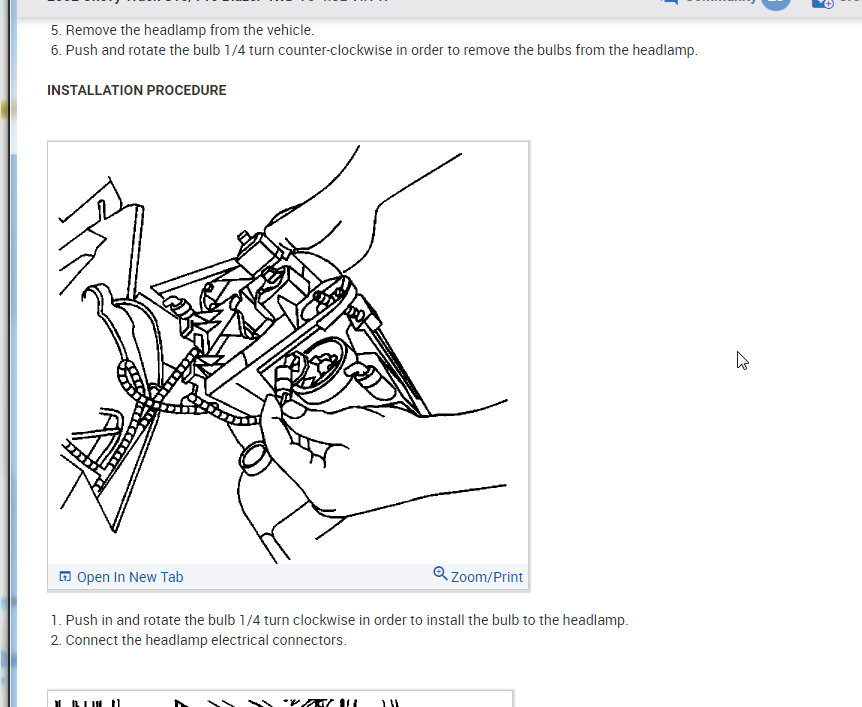

Here is a guide to help you step by step with instructions in the diagrams below to show you how on your car. https://www.2carpros.com/articles/how-to-replace-a-headlight-bulb
https://www.2carpros.com/forum/automotive_pictures/99387_Graphic1_212.jpg
Push and rotate the bulb ¼ turn counterclockwise in order to remove the bulbs from the headlamp assembly

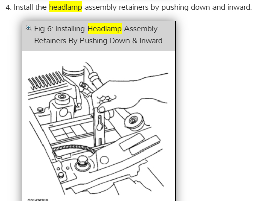

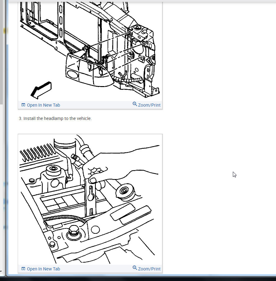

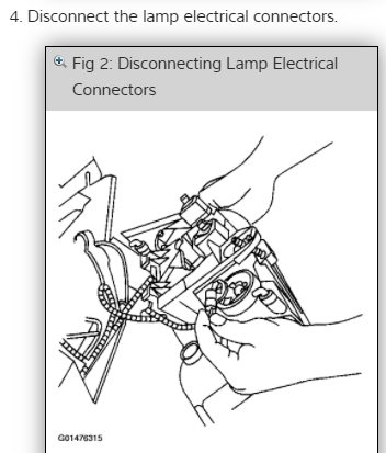

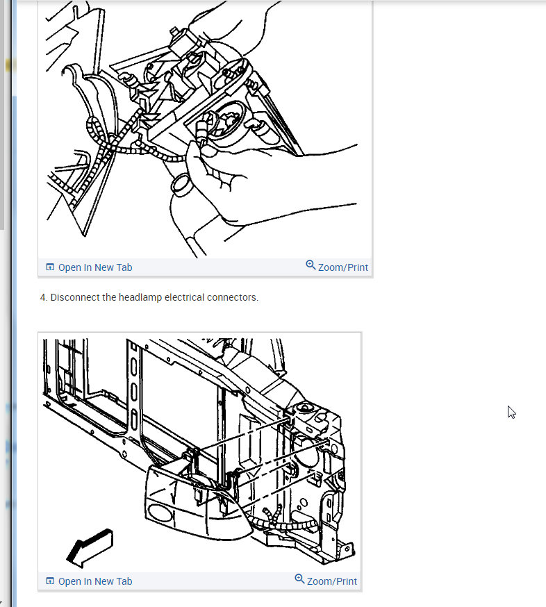

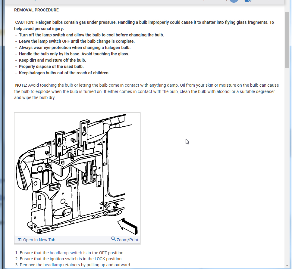

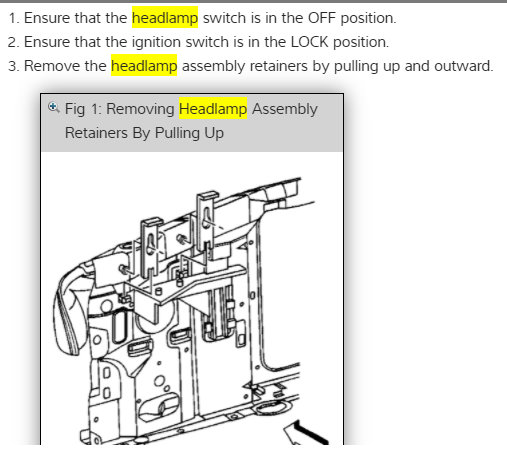

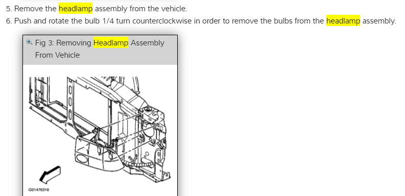

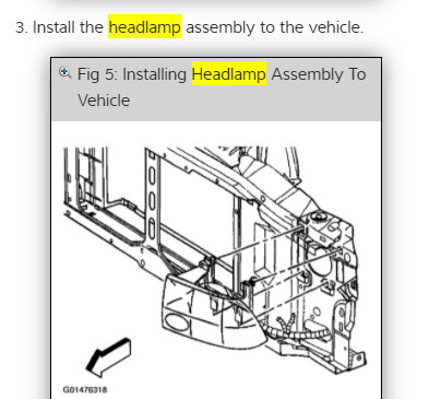

Here is the information you requested. Here is a tutorial showing how to replace a headlamp bulb:

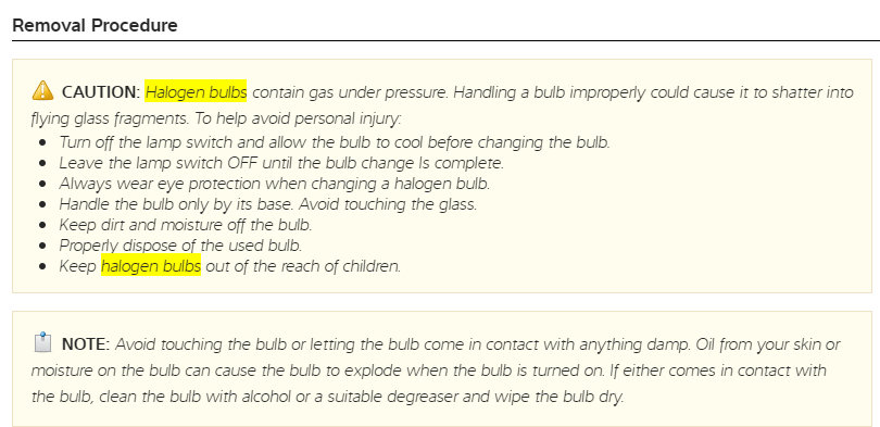

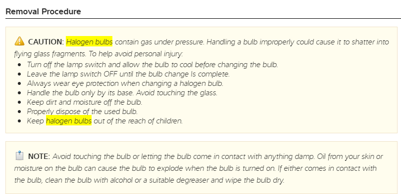

Be sure to not touch the glass bulb with your fingers as the oils from our skin will possibly destroy or break the glass. I've attached picture steps below on how to replace the headlamp bulb on your vehicle. Hope this helps and thanks for using 2CarPros.

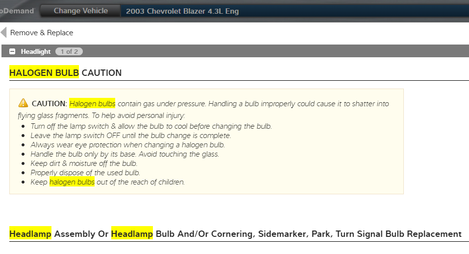

Here is a guide that will help with this on step by step instructions:
Here is video of a similar vehicle that will help with this:
https://www.youtube.com/watch?v=4dsoNWsULDs
Please run through this material and let us know if you have questions.
Below you will find the process from the manual that will help as well.

To replace the headlamp bulbs, open the hood and look behind the headlamp assembly. You will see the sockets that hold the bulb. Turn them counter clockwise and the socket will come loose. Just pop the old bulb out and replace it with the new one.
One rule of thumb. Try to avoid touching the class part of the new bulb. THe oils from your skin will cause them to burn out faster.
