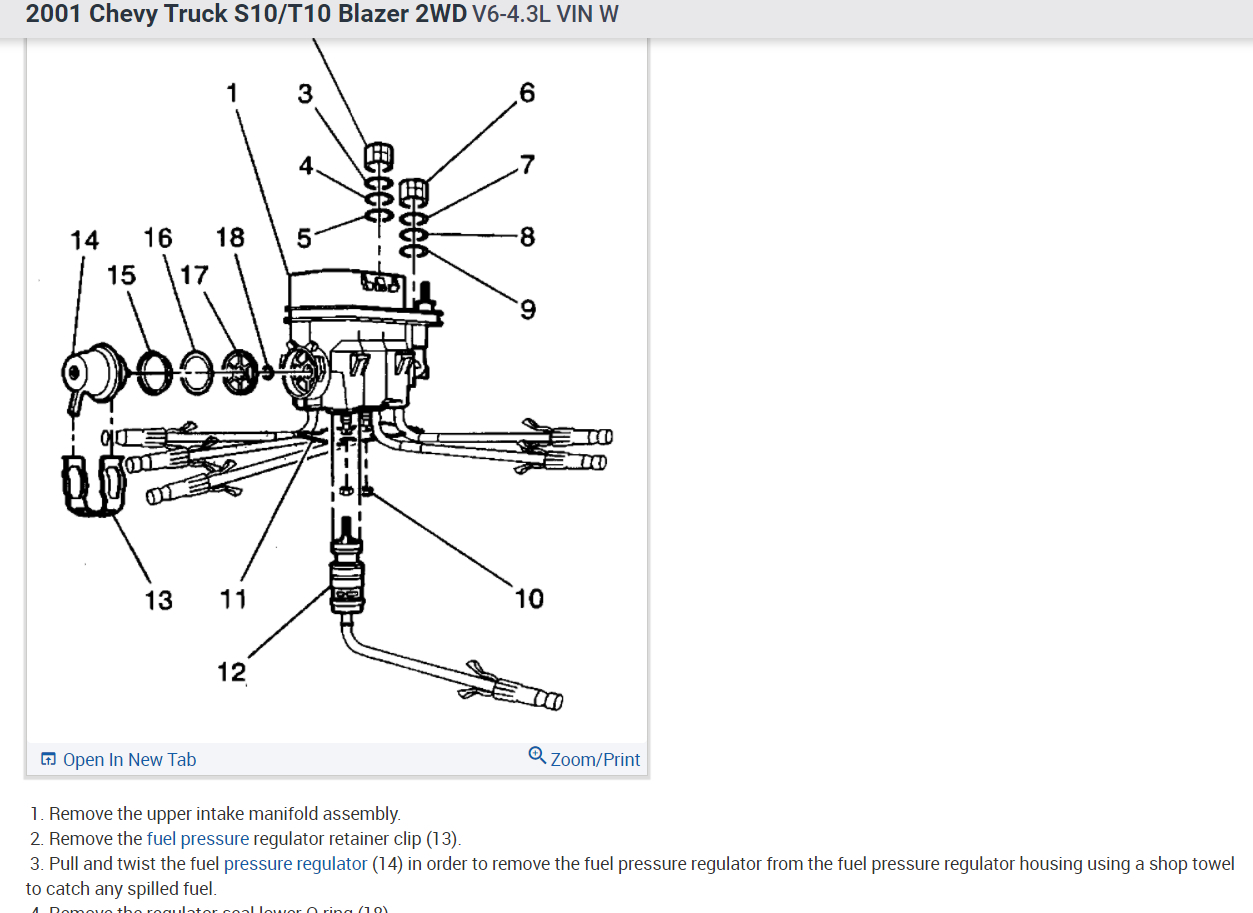

To find the fuel pressure regulator you will have to take the Plenum off...... it is located in the center of the picture....

DEAD01BLAZER
Got a 2001 Chevy Blazer, 4.3 Vortec 6cyl. csfi Where exactly is the fuel pressure regulator located? Cant seem to find visually Dont see exposed fuel rail Do i have to remove the intake manifold? Can take a picture of engine if that would help of course its snowing now!!!
Dec 28, 2020 at 11:41 AM (Merged)
MOHMAN
I have a 4.3 6cyl. 2000 chevy blazer with the vortec. The regulator I hate to say is under the manifold with the spider injector. Im having the same problem with mine. The engine cranks but wont start. The pump is working and the filter was changed. Good luck Ive learned my lesson with this Chevy. Here are diagrams to help you see what I am talking about. Check out the diagrams (Below)

SWILLIAMS
  • 597 POSTS
Under the upper section of the intake manifold. On the rear of the injector assembly. If it was mounted on the front you could change it without opening the intake.

R.C. EDIE
need to find its location.
Dec 28, 2020 at 11:43 AM (Merged)
RASMATAZ
  • 75,992 POSTS
4.3L V6
If its the CPI spider system its under the upper plenum on the passenger side-TBI behind the injector

MARIONRAY
how do i replace fuel pressure on 4.3 vortech engine?
BLUELIGHTNIN6
  • 16,542 POSTS
Properly relieve the fuel system pressure and disconnect the negative battery cable.
Remove the fuel return pipe from the regulator and discard the old O-ring.
Disconnect the vacuum hose from the regulator.
Remove the fuel return pipe clamp.
Remove the pressure regulator attaching screw, then remove the regulator and discard the O-ring.
To install:
If the old pressure regulator is being installed, check the filter screen (if equipped) for contamination and replace, if necessary.
Lubricate the new O-rings with clean engine oil, then install them on the pressure regulator and fuel pipe.
Install the pressure regulator onto the manifold.
Make sure the regulator attaching screw threads are covered with Loctite 262 or an equivalent threadlocking compound, then install and tighten the screws to 31 inch lbs. (3.5 Nm).
Connect the vacuum hose to the regulator.
Make sure the new O-ring is in position, then connect the fuel return pipe to the pressure regulator and tighten to 22 ft. lbs. (30 Nm).
Install the fuel return pipe clamp and attaching nut to the lower intake manifold assembly.
Connect the negative battery cable, then pressurize the fuel system by cycling the ignition (without attempting to start the engine) and check for leaks.

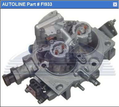

TRASKRIVERJACK
What is the procedure for installing a kit in the fuel pressure regulator of an 1989 5.7 K5 Blazer TBI ?
Dec 28, 2020 at 11:45 AM (Merged)
JDL
  • 16,098 POSTS
Make sure no pressure on system, Remove top torque screws, the autostore sells a fitting to remove those. You should be able to remove only the top part. Picture below.

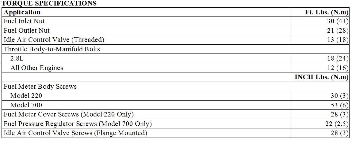

TRASKRIVERJACK
And then what ? I understand the regulater is under spring pressure. How to disassemble, reassemble, and what are the alignment issues, and torque values for the fasteners ?
JDL
  • 16,098 POSTS
You shouldn't have any problems, just put it back together the way it came off. I don't use a torque wrench on screws that small, maybe I should? Torque specs are below.
