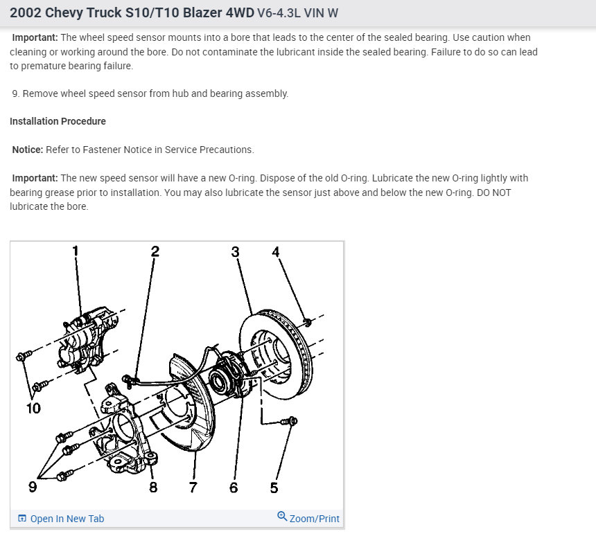

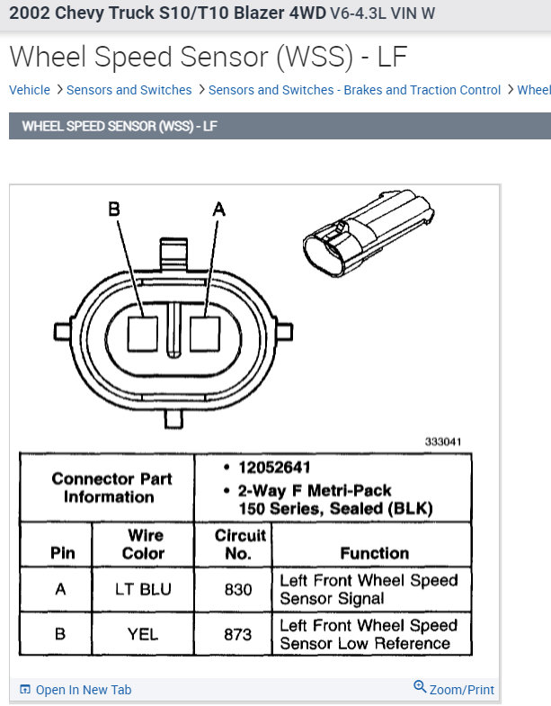

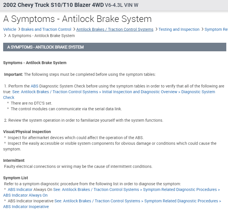

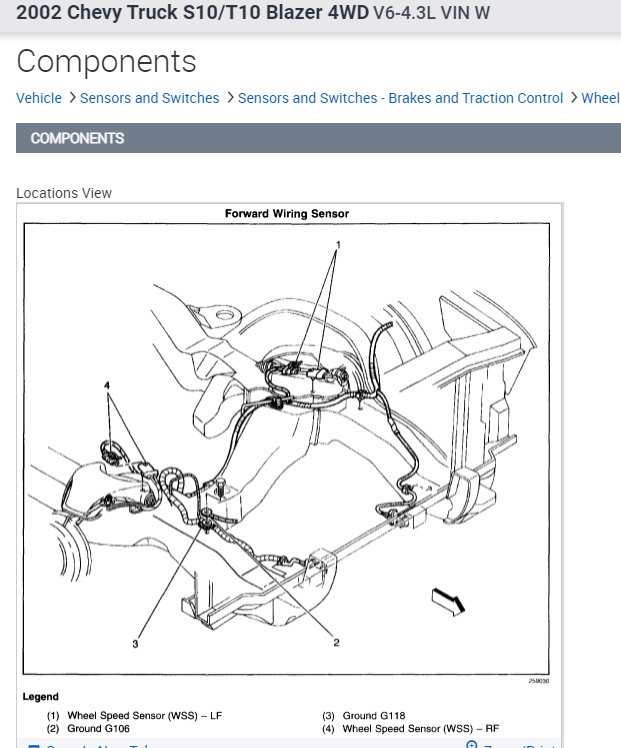

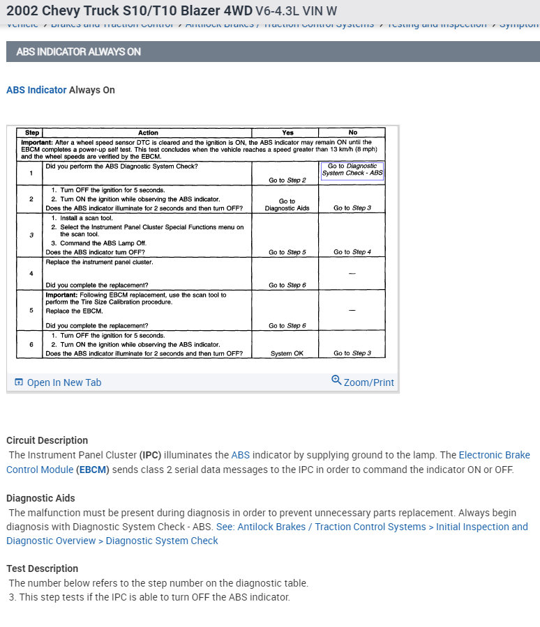

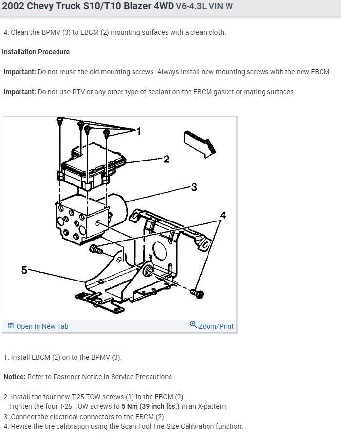

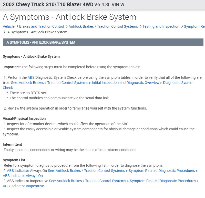

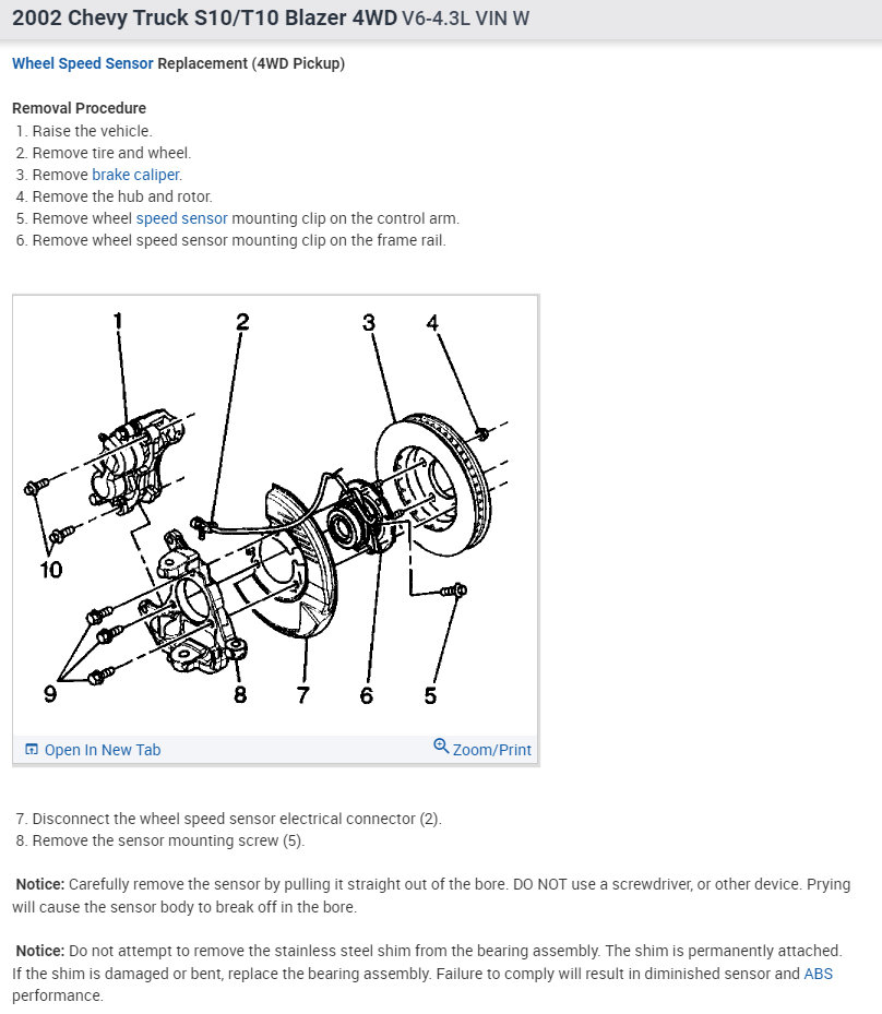

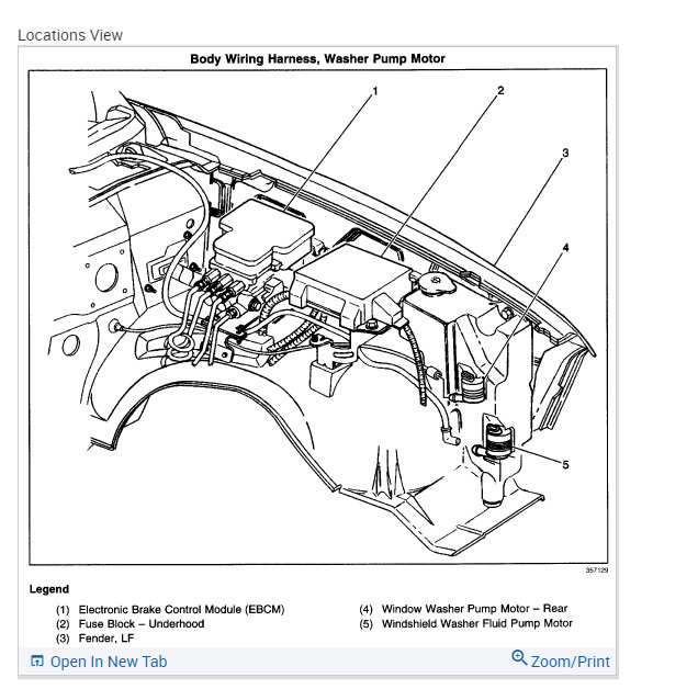

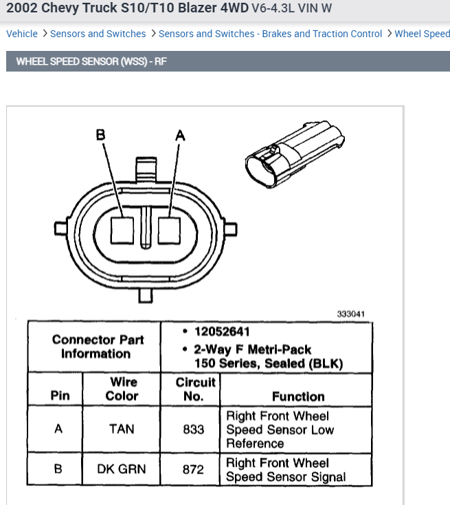

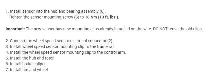

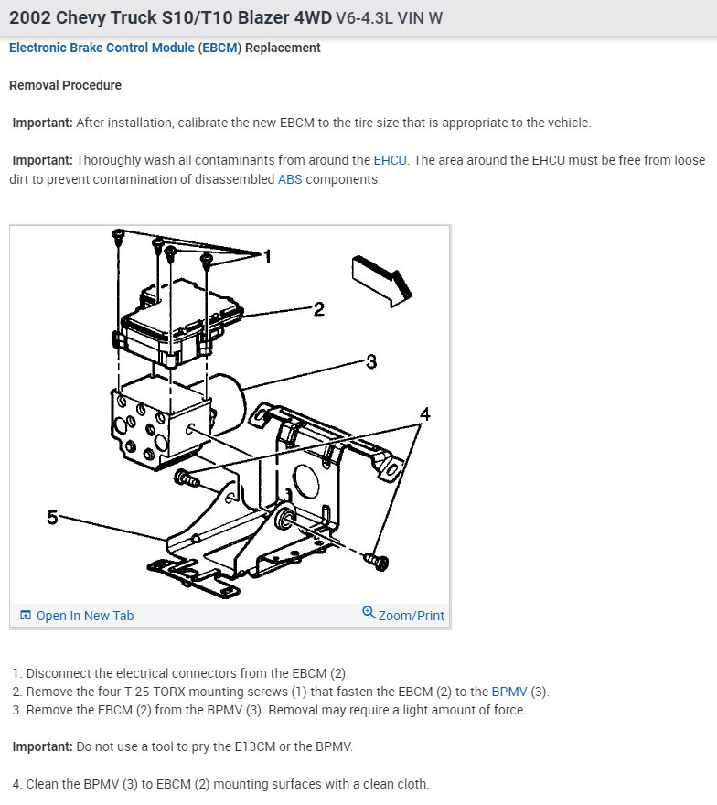

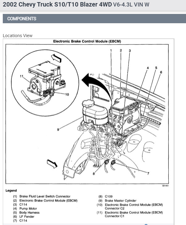

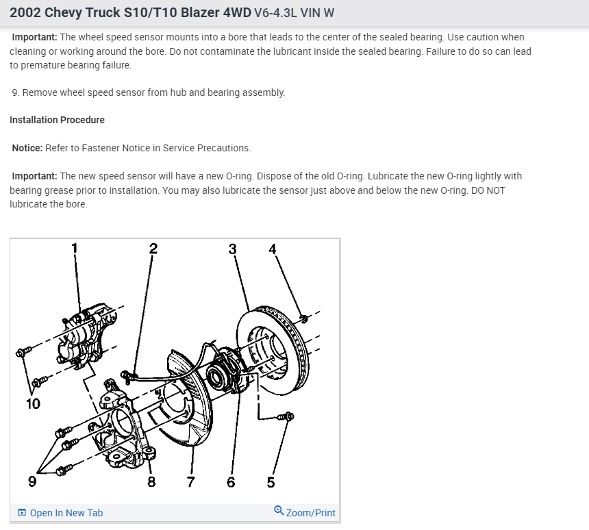

I have attached the ABS light troubleshooting guide below. Also included the ABS components.
