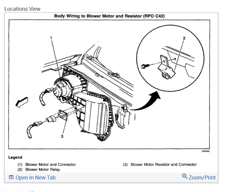

My heater blower stopped working today. I went to Auto Zone who sold me a Heater Blower Relay but there isn't a place in the fuse boxes for this relay. The relay looks like it attaches to something like maybe on the firewall but I can't figure out where. I see nothing in the box or the fire wall that resembles the relay I was sold.
If anyone has any suggestions, please let me know.Thanks
Feb 22, 2008 at 6:09 PM
BMRFIXIT
  • 19,053 POSTS

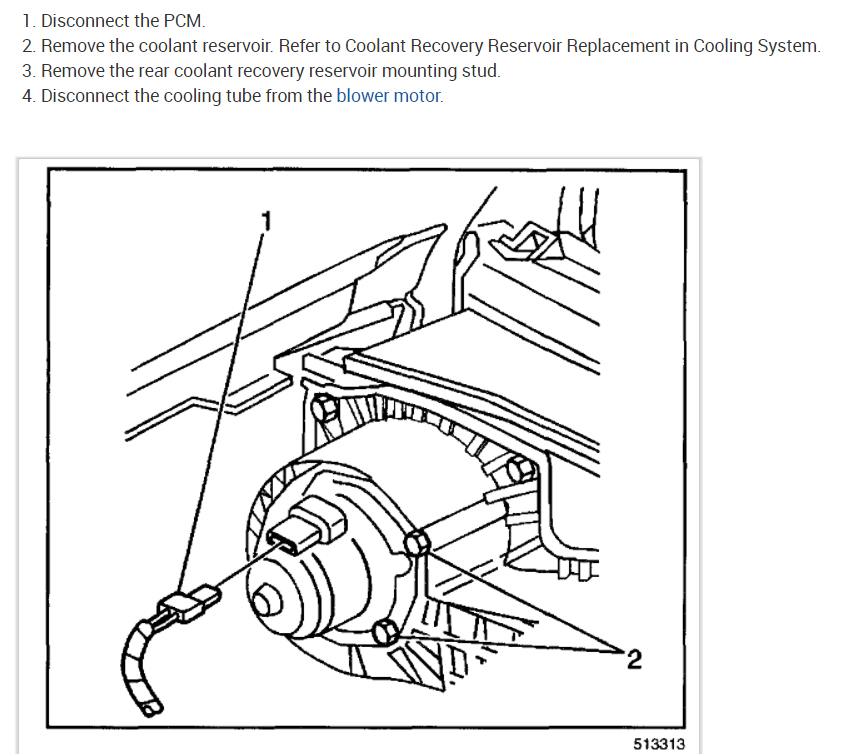

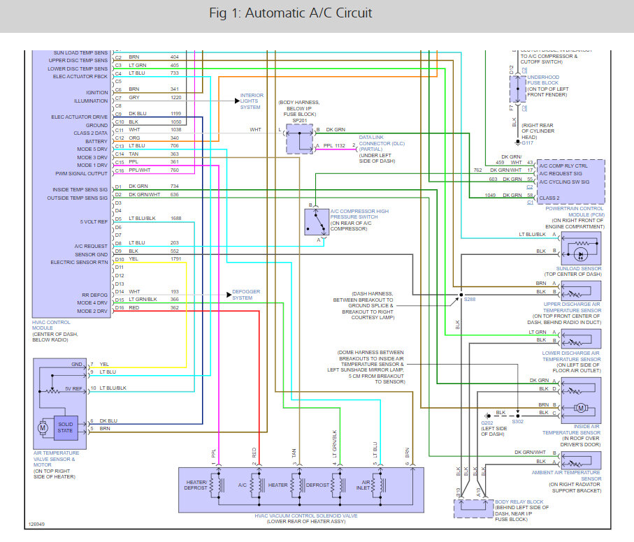

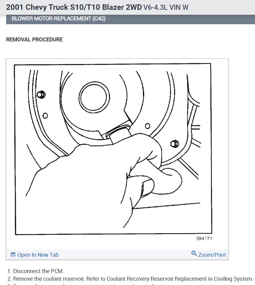

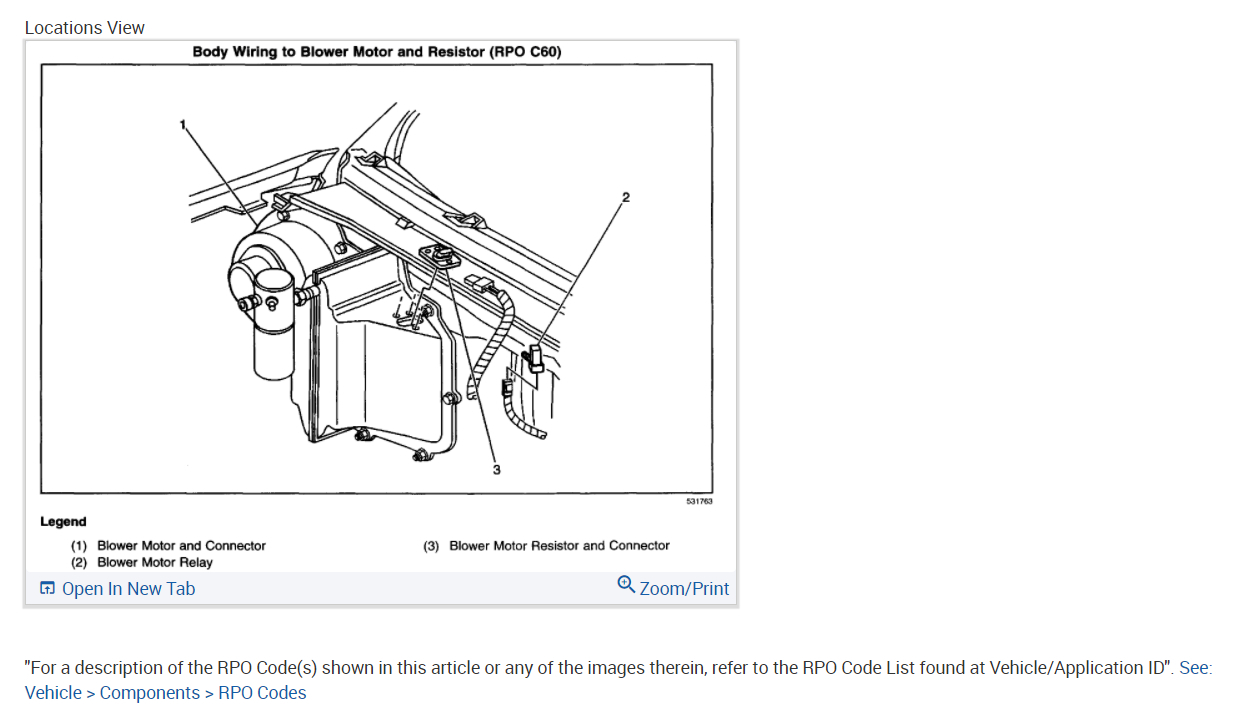

did you check the fuses also check the motor and the wires around it tap on the motor. This guide will help you test the motor here is a guide as well to check the relay with the relay location in the diagrams below.
and
https://www.2carpros.com/articles/blower-fan-motor-works-on-high-speed-only
Check out the diagrams (Below). Please let us know what happens.

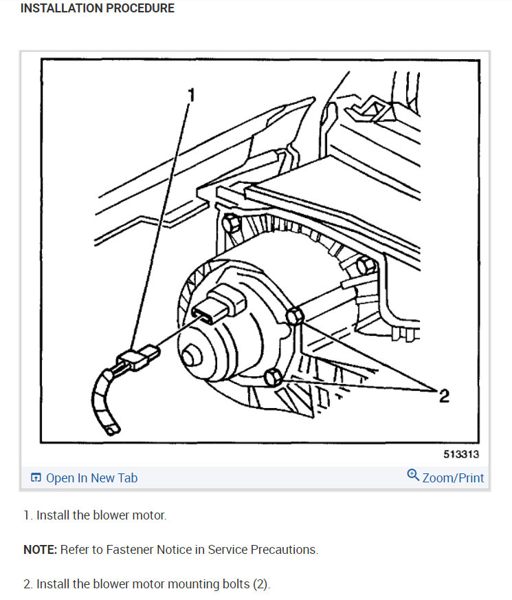

the blower stopped working, how easy is it to fix myself, i pretty much know nothing about vehicles.
Nov 12, 2020 at 5:45 PM (Merged)
Hi:
The problem may not be the motor. You first need to check if the motor is getting power. If it is, then it's most likely the motor.
As far as replacing it, it's under the dash on the passanger side (a little bit of a pain to get to).
If you are willing to do the work, I can tell you how to do it, but on a scale of 1 to 10, 10 being the worst, it's about a 6.

The blower motor is located on the right rear of engine compartment
Check the AC/Heater fuse no. 6 25amp and also test the blower switch
Apply battery power to the purple wire on the connector at the motor-Did it fire up-if not check the ground on it if okay the motor is gone

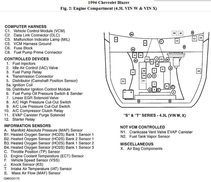

please help my 4x4 full size chevy blower fan was going on and off and now has stoped working, where do I locate the fuse and or what other things should I be cheaking
Dec 28, 2020 at 11:09 AM (Merged)
DRCRANKNWRENCH
  • 3,380 POSTS

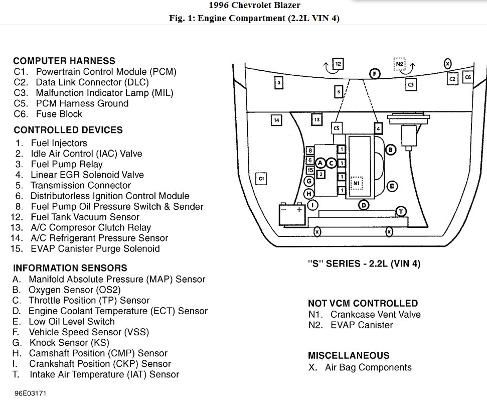

The ralay might be bad as well. If you check the fuse and it is good, the relay may need to be replaced. It is located at the center rear of the engine compartment.
The fuse box is located on the leaft side of the dash. The cover should have a diagram on it mapping out the location with a description of the fuses in the panel. It is somethimes hard to orient this diagram, so make sure you have it right by using the spare fuses or large relays as landmarks to orient the diagram in relation the the fuse location.
I am giving you 2 diagrams. They are electrical component location diagrams and show the fuse panel, but I did not see the relay represented. One is for a 2.2L and the othe is for the 3L.
They are labeld at the top when you click on them you will be able to see this.
They both have the fuse panel in the same place, but I figured you might be able to use them for other purposes or just to have them.
If you need anything else, please don't hesitate and I will reply ASAP.

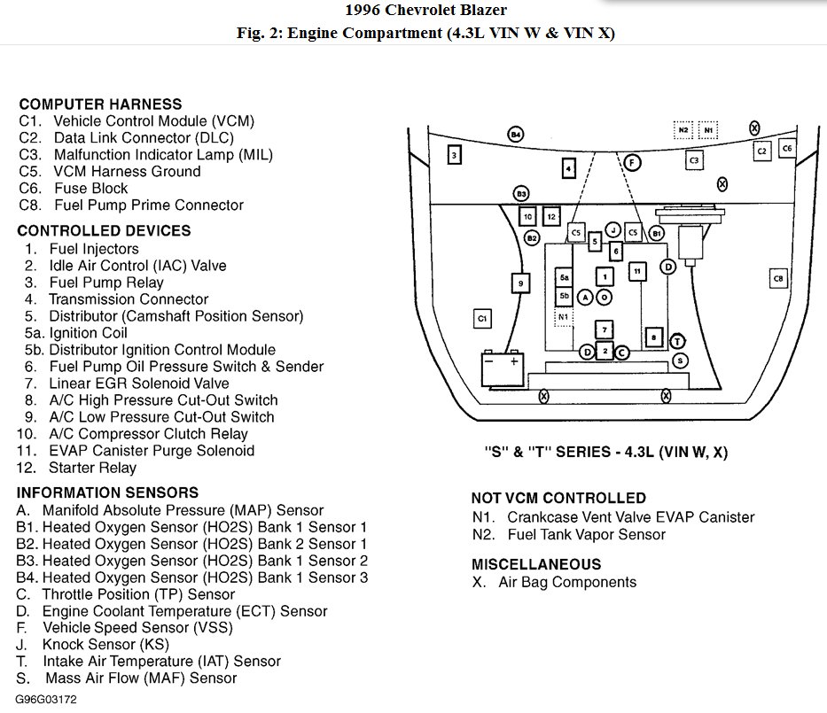

BRYAN MCNABB
Thank you Dr CranknWrench if it is the relay is it the one in the middle of the 3 little boxes beside the blower fan at the back of the fire wall? is this correct?
Thank you so much!
DRCRANKNWRENCH
  • 3,380 POSTS
It should have the following colors of wires going into the wire harness terminal connector and then the a black wire going out to ground;
Orange, Red and Dark Blue and Purple then the Black ground wire.

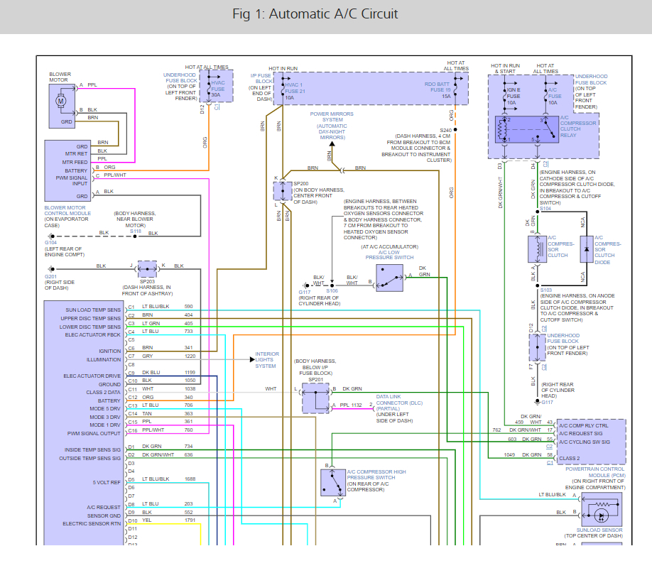

I can get the blower to run by splicing the purple wire on relay harness from positive on battery buy fan will not run without it. Replaced the resistor and nothing. Any recommendations?
Jan 8, 2023 at 2:24 PM
Can you check the HVAC fuse in the under-hood fuse panel for power?
Here is a guide to help and the blower motor wiring diagrams so you can see how the system works:
