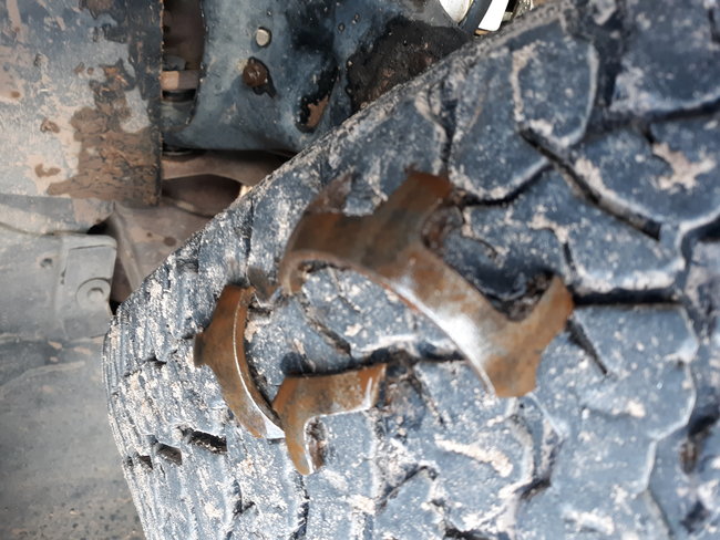

Long story short, I did not abuse it and it randomly broke on me, boots been ripped forever too. I was able to pull some metal pieces from inside the front passenger boot. Anyway, I am needing to find out if all I need to replace is the CV axle. It also will me spin it freely by hand, as if it is not connected to the tire. Cannot afford a look over from a mechanic.

That looks like broken pieces of the CV joint cage that holds the steel balls.
Why do you not just go take the complete axle along with the CV joint from a car in a salvage yard?
You can find if there are any 1987 Chevrolet s10 Blazers near you with this nationwide database of salvage yards.

The boot was ripped, so I was able to see inside, part of the cage is still in there , and the other parts fell out as pictured . You made it sound like the cv assembly had the cage ?

When I was talking about the broken pieces, I was talking about my old one. Now when I was talking about then you are not having a cage, I thought the cage was something exterior that it's hooked up from the wheel to the CV, not inside of the CV itself. To confirm things is the cage inside of the CV.

My bad, i didnt fully understand how it hooked up, a friend explained it to me. I thought the cage that holds the part i pctured was a separate piece, i realize now it is internal.. all is well haha.

The cage holds the cv joint steel ball.
See here, https://imgur.com/gallery/2zY7G
