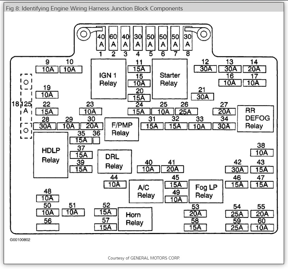

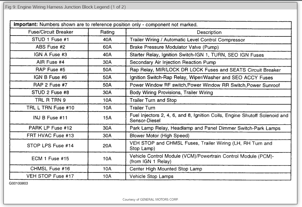

CHeck engine light on/off for weeks. Replaced o2 sensor 3 times. Pulled fuel pump fuse out, put back in. Truck now starts. Mechanic says it will take some time to figure out what might be really wrong. Can fuel pump overheat , stop working for a while, then restart? Fuse contacts old? Fuel pump relay the problem?
Any other ideas would be great
