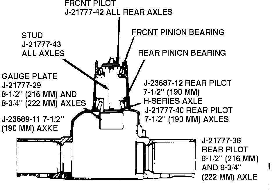

I have a 1988, K5 Blazer, automatic transmission, 4 wheel drive with a 5.7L engine with about 100,000 miles on it. I lost the oil in the rear end and locked up or seized the bearings where the yolk enters the rear end. Possible damage to axle bearings also. I am trying to decide rather to fix what I have, if possible, or find a whole rear end at a salvage yard. I need to know what size rear end came in this vehicle. I have opened it up and all the gears are in pretty good shape. I am fairly sure, no positive, that it is the stock rear end for that year. Can you please tell me what size rear end I have in it? Do you think it is worth re-building? My axles turn freely with no growling or noticeable damage. I would replace anyway. I believe my main problem is the bearing where the drive line and yolk enter the rear end. That is froze up solid, or pretty close to solid. I will included a pic I took and maybe that will help determine some of this. Thank you very much in advance. DonH Sterling, CO
https://www.2carpros.com/forum/automotive_pictures/112189_Blazer_rear_end_002_1.jpg
https://www.2carpros.com/forum/automotive_pictures/112189_Blazer_rear_end_001_1.jpg
https://www.2carpros.com/forum/automotive_pictures/112189_Blazer_rear_end_003_1.jpg
https://www.2carpros.com/forum/automotive_pictures/112189_Blazer_rear_end_004_1.jpg
May 14, 2021 at 12:26 PM (Merged)
MERLIN2021
  • 17,250 POSTS
That is called a 10 bolt rear end. Count the teeth on the ring gear and then divide the number of teeth on the small pinion gear that will give you your ratio. Make sure you measure the overall width and check the spring perches.
If the pinion bearing seized and there is a lot of metallic flaking in the case you are better getting a used rear end and installing it.

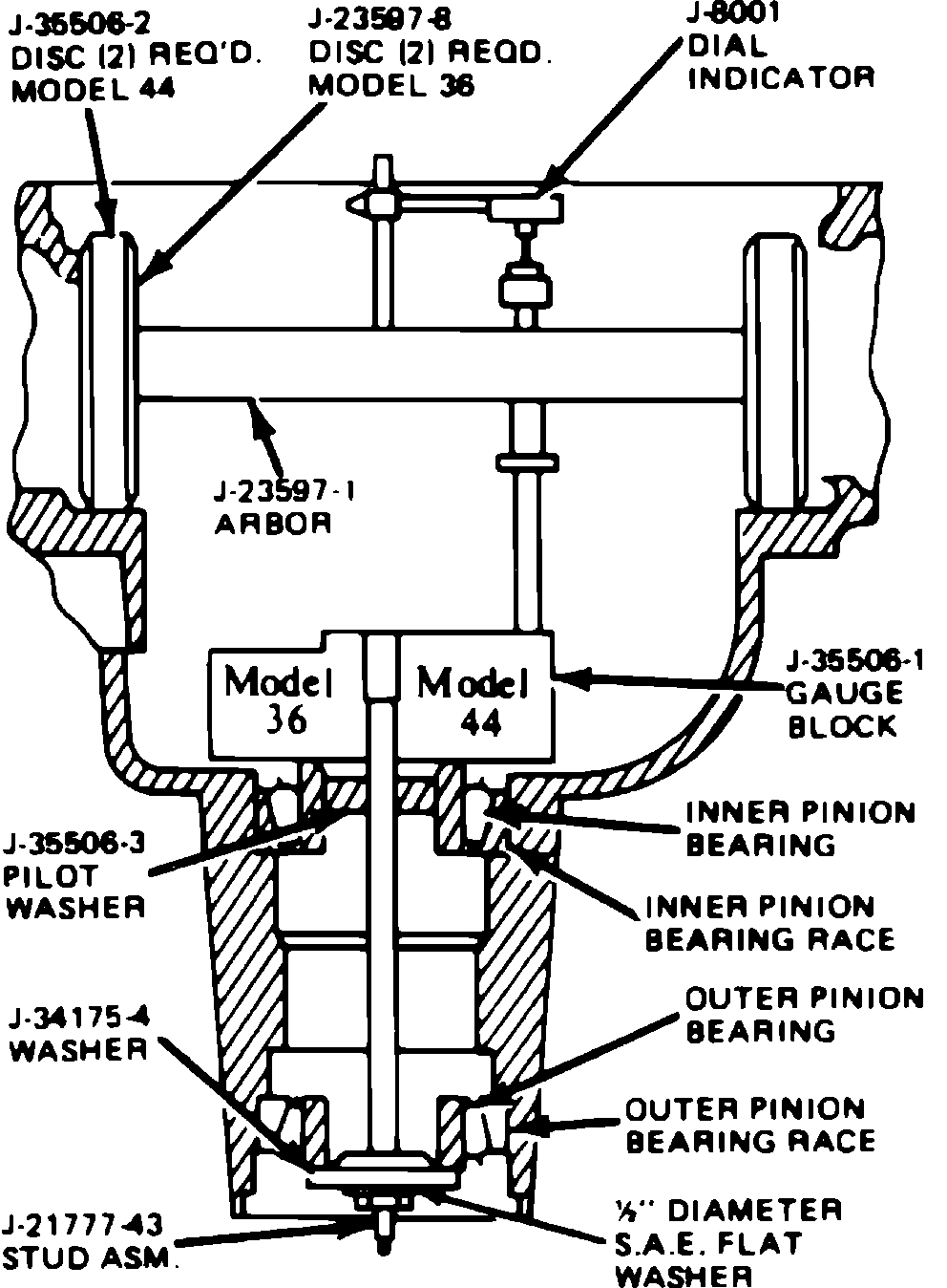

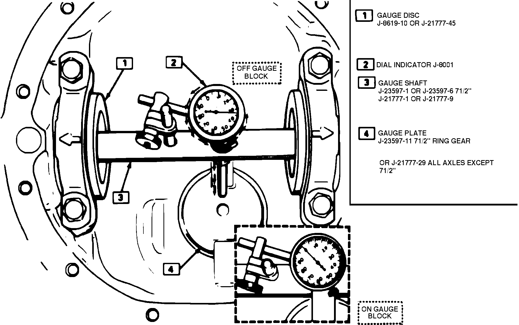

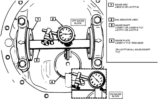

K5_BLAZER
I am installing new gears I the front end of my vehicle and I got the old shim on the new pinion and new bearings. When I tighten the nut the pinion is too tight to turn and it's not over tightened I barely wrenched it on.and if I back off a bit and turn the pinion then I can hear the (new) crush sleeve has not been crushed it's moving in there. I'm thinking maybe have to go with smaller or no shim on pinion?
Welcome to 2CarPros.
I need to know which differential you have. There are several that could have been used. Here is the list of possible differentials.
Adjustments
Borg Warner
Dana/Spicer
Timken/Rockwell - 12 Inch Ring Gear
K5_BLAZER
It's a GM 10 bolt 8.5 ring gear.
Welcome back:
I believe this is what you need. Take a look through it and let me know. The attached pictures correlate with the directions.
__________________________________________
Adjustment
1. Install pinion bearing races in housing using a suitable driver.
2. Lubricate pinion bearings and install bearings in races.
3. Mount depth gauging jig in housing, Fig. 8, noting the following:
a. Assemble gauge plate onto preload stud.
b. Hold pinion bearings in position, insert stud through rear bearing and pilot and front bearing and pilot, then install retaining nut and tighten nut until snug.
c. Rotate tool to ensure bearings are properly seated.
d. Hold preload stud and tighten nut until 20 inch lbs. of torque, which is required to rotate stud. To prevent damage to bearing, tighten nut in small increments, checking rotating torque after each adjustment.
e. Mount side bearing discs on arbor, using step for disc that corresponds to base of housing.
f. Mount arbor and plunger assembly in housing, ensuring side bearing discs are properly seated, install bearing caps and tighten cap bolts to prevent bearing discs from moving, Fig. 9.
4. Mount dial indicator on arbor stud with indicator contact button bearing against top of arbor plunger.
5. Preload indicator 3/4 revolution and secure to arbor mounting stud in this position.
6. Place arbor plunger on gauge plate, rotating plate as needed so that plunger rests directly on button corresponding to ring gear size.
7. Slowly rock plunger rod back and forth across button while observing dial indicator.
8. At point on button where indicator registers greatest deflection, zero dial indicator. Perform steps 7 and 8 several times to ensure correct setting.
9. Once verified zero reading is obtained, swing plunger aside until it is clear of gauge plate button and record dial indicator reading. Indicator will now read required pinion depth shim thickness for a ``nominal'' pinion.
10. Inspect rear face of drive pinion to be installed for a pinion code number. This number indicates in thousandths of an inch necessary modification of pinion shim thickness obtained in step 9.
11. Select pinion depth adjusting shim as follows:
a. If pinion is stamped with a plus (+) number, add that number of thousandths to dimension obtained in step 9.
b. If pinion is stamped with a minus ( - ) number, subtract that many thousandths from dimension obtained in step 9.
c. If pinion is not stamped with plus or minus number, dimension obtained in step 9 is correct shim thickness.
