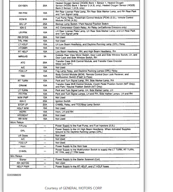

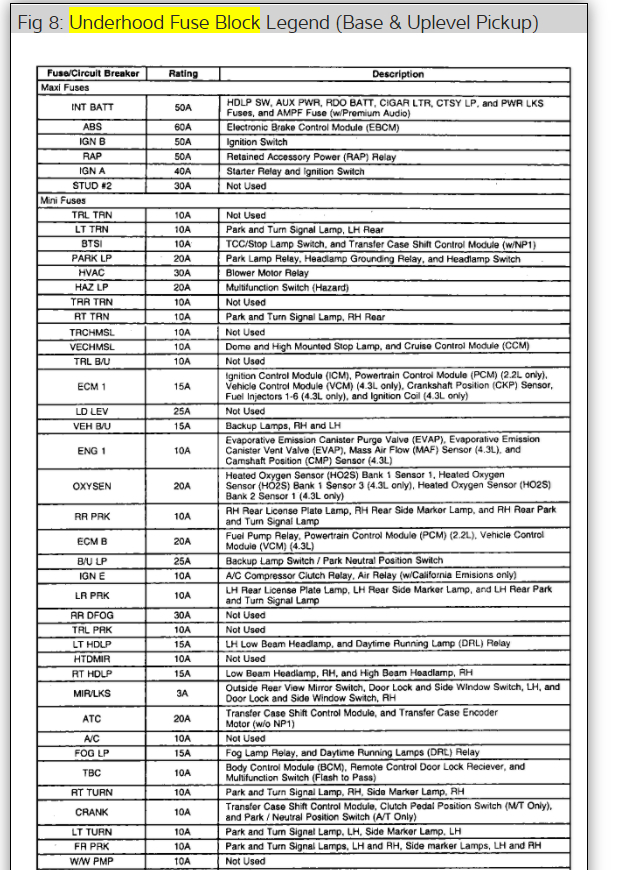

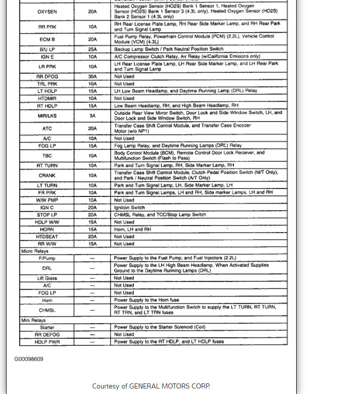

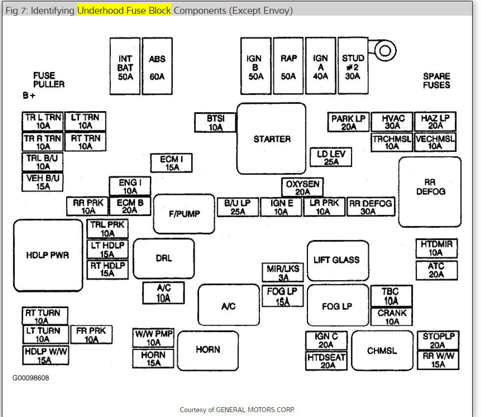

I have replaced my fuel pump but it not whurring when i turn on the key. Where is the fuel pump relay on this model. It not on the pass side firewall nor behind the glove box. On the fuse box is one power relay and that one is good. There seams to be no power to the the pump.
Jan 30, 2021 at 8:31 AM (Merged)
RASMATAZ
  • 75,992 POSTS
Its inside the underhood bussed electrical
https://www.2carpros.com/forum/automotive_pictures/12900_relay_box_1.jpg
OSCODAPAT
  • 4 POSTS
is it under the inside fuse box or just the one on the fuse box
Jan 30, 2021 at 8:32 AM (Merged)
RASMATAZ
  • 75,992 POSTS
Its inside the bussed electrical center-don't have the info on which is which tried but couldn't come up with it-
OSCODAPAT
  • 4 POSTS
I've replaced my fuel pump and checked my fuel relay but still dont have power to the pump. any ideas
RASMATAZ
  • 75,992 POSTS
All you got is 2secs to check for power before the fuel pump relay de-energizes then you lose power to the pump. The computer energizes the fuel pump relay. Did you check the fuel pump fuse?
https://www.2carpros.com/forum/automotive_pictures/12900_oil_sending_unit_and_fuel_pump_circuit_55.gif
