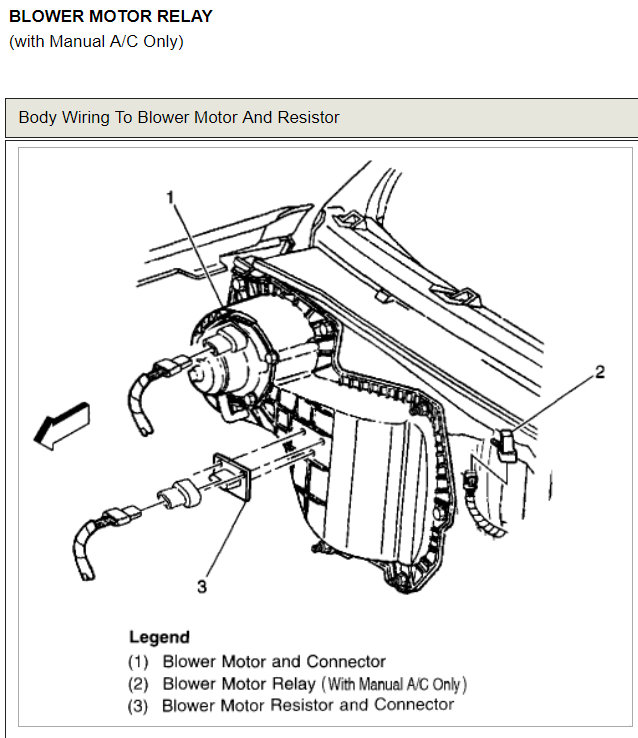

My blower in my car recently stopped working. I was going to first check the relay to see if that was the problem, but I can't seem to locate it. Any help would be great.

Here is a guide to help you test the relay after you find it from the diagrams below.

Hi:
I believe the relay is located on the passanger side under the hood to the HVAC box on the firewall. It could also be the blower motor resister, or a loose connection.
