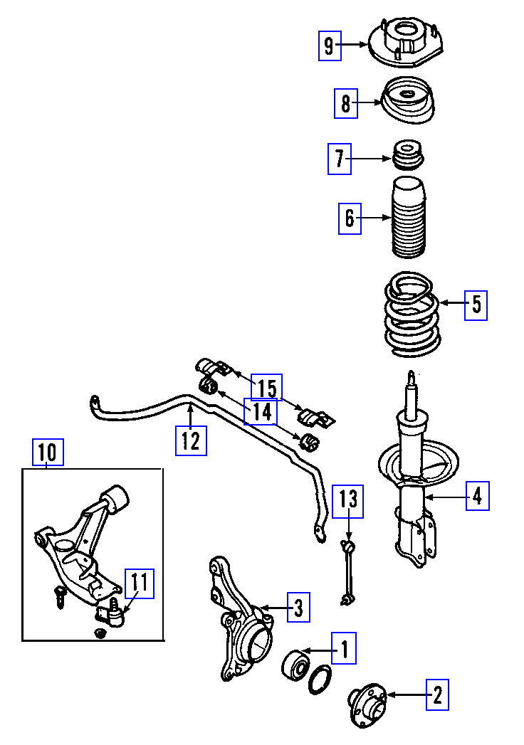

By "wishbones" do you mean the front lower control arms (shown as item #10 in the attached diagram)?
After you replace the suspension/steering parts you've mentioned your car will need a four wheel alignment in order for it to steer properly and to preserve tire life (as it is impossible to put each new part in the exact orientation as the original part).
Have vehicle aligned at a reputable shop.
P.S.
The "rubbers" that you mentioned are called the strut mount (#'s 8 and 9 in diagram)
and the "suspension legs" are the struts (# 4 in the diagram).
Please let me know how the alignment changes/improves your steering.
