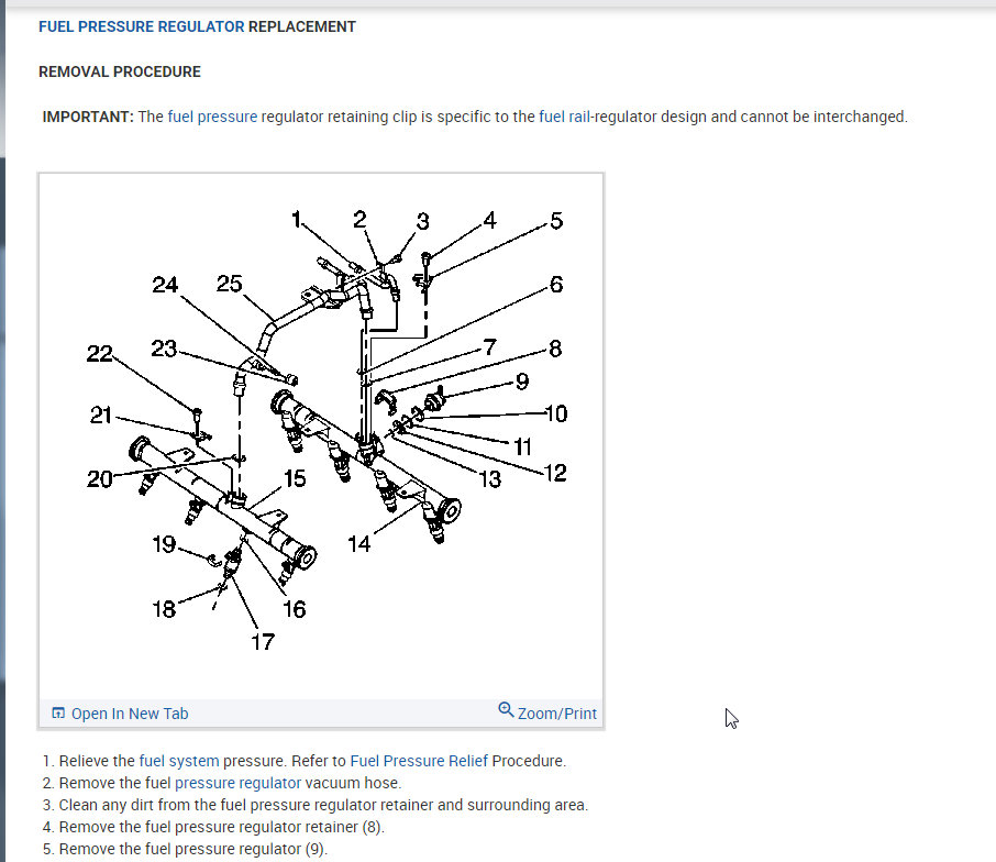

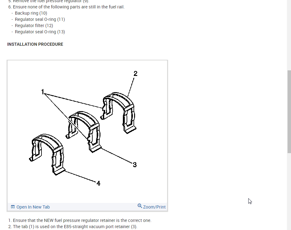

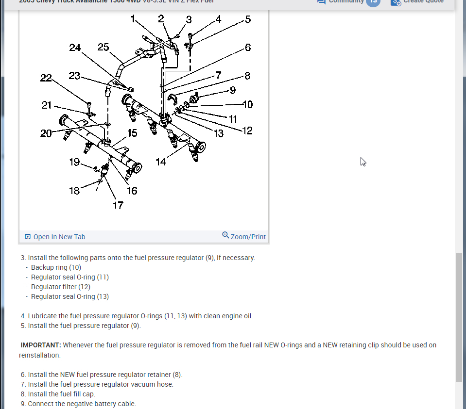

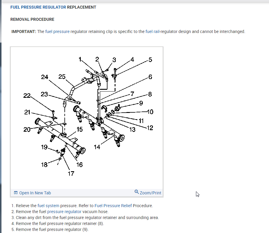

There is a strong possibility that the fuel pressure regulator is stuck open causing a rich condition that is giving you the black smoke-rough running condition from extremely high fuel pressure. The fuel pressure regulator is located within the in-tank electric fuel pump assembly. Here is a tutorial showing how to check fuel pressure. The fuel pressure specification for your truck is with key on-engine off is 55-62 PSI.

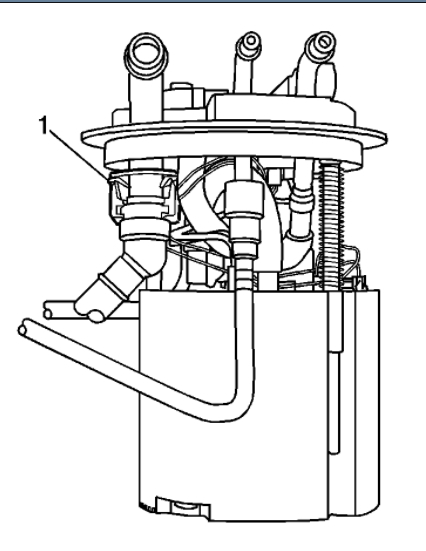

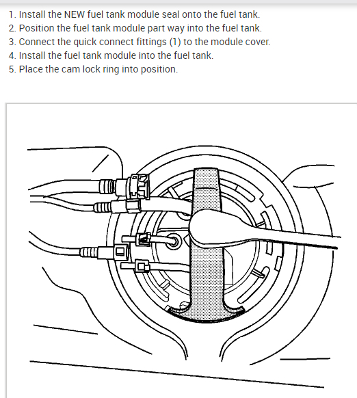

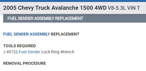

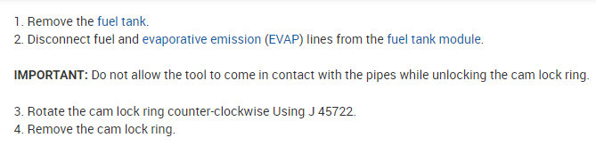

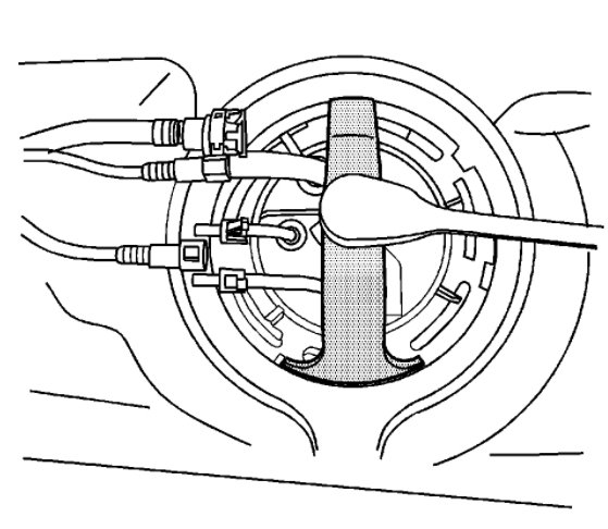

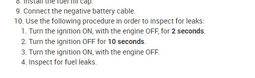

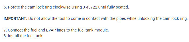

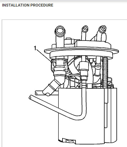

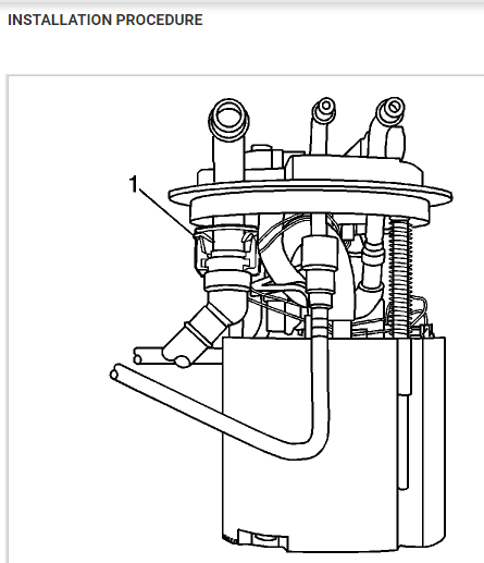

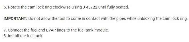

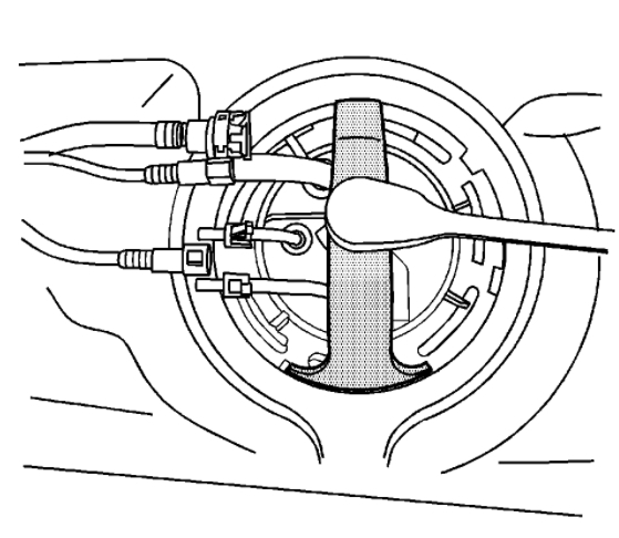

Here is a tutorial showing how to replace an in-tank fuel pump:
I've attached picture steps below showing how to remove and replace the fuel pump on your truck. Hope this helps and thanks for using 2CarPros.
