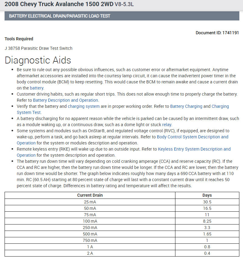

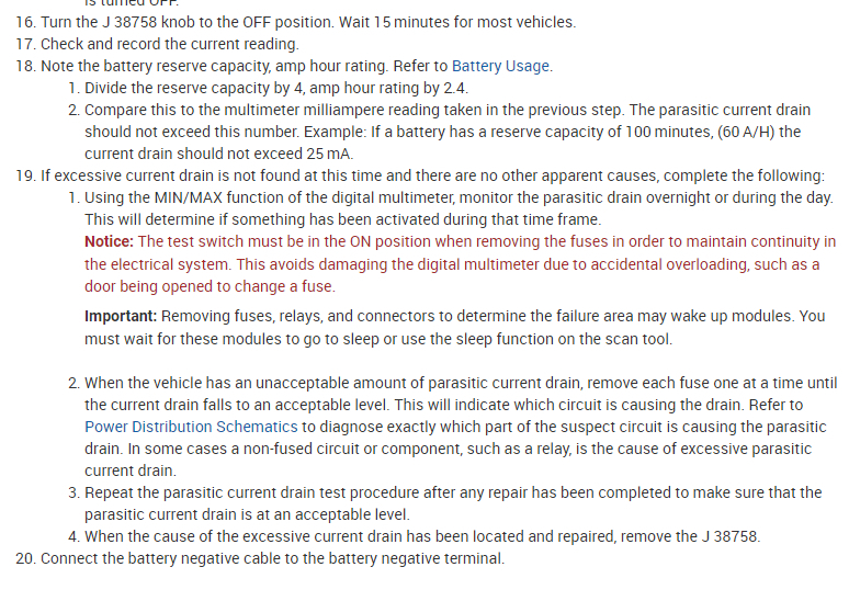

You could high current draw or parasitic draw on the battery due to any number to faulty electrical components. It could be a glove box light staying on to a shorted window switch etc.

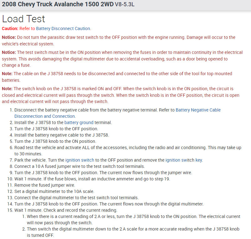

You will have to use a multimeter to see what is the current drain on your battery. This vehicle should have 25 milliamp or less parasitic draw.
If the draw exceeds that then it is considered excessive.
Here is a helpful video of how to check for parasitic draw:
