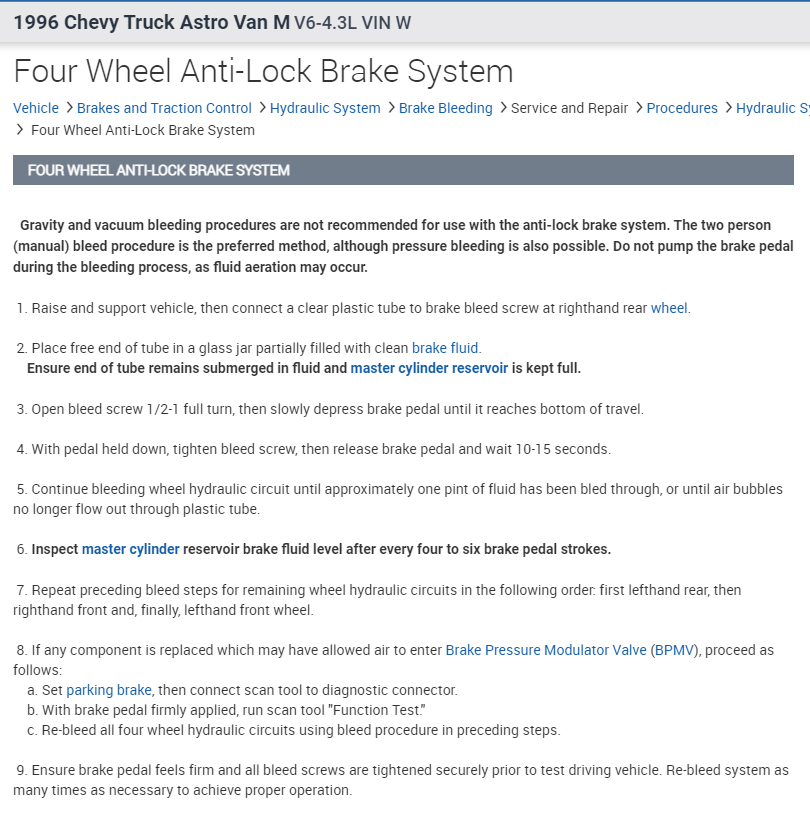

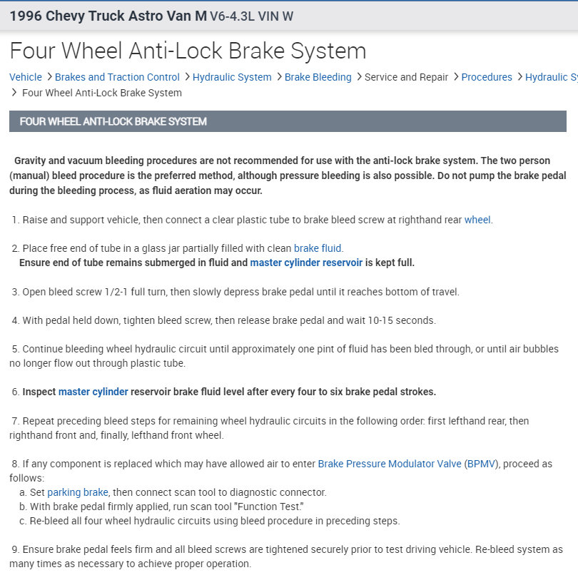

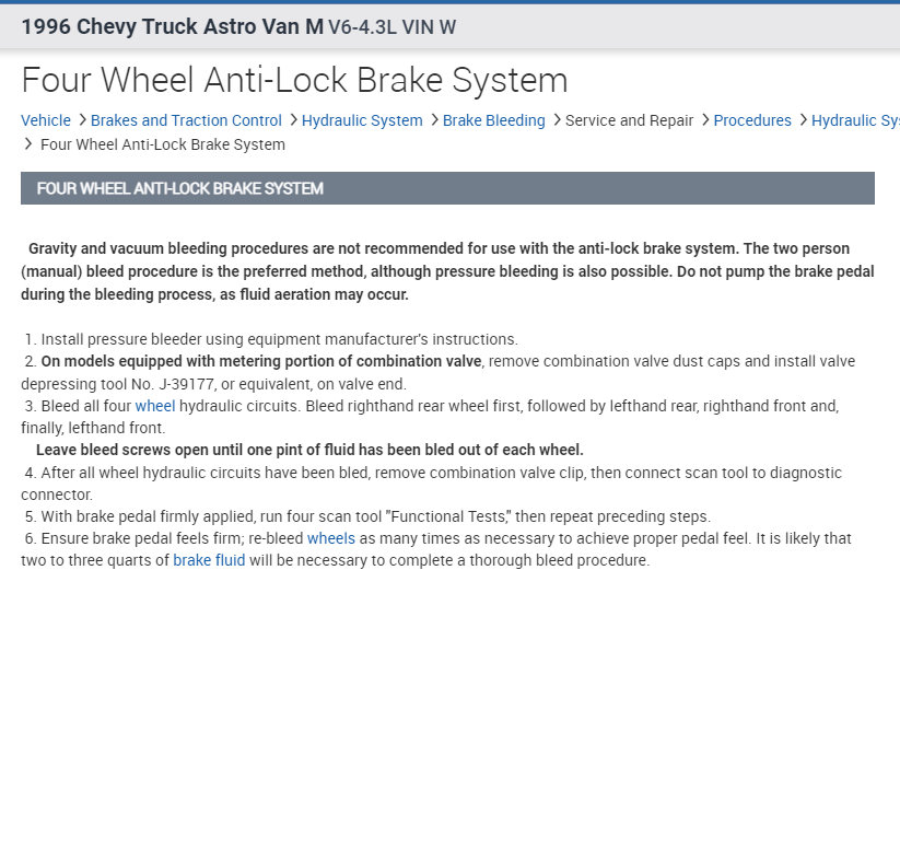

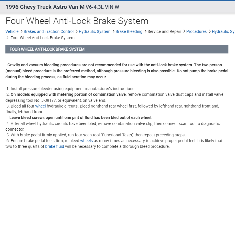

The bleeding of the ABS system is little different compared to standard brakes.
When proper procedure does not get followed, it can lead to having air in the lines.
Here is a helpful guide:
https://www.2carpros.com/articles/how-to-bleed-or-flush-a-car-brake-system
I have attached the bleeding procedure for the brakes below.
Thank you.
