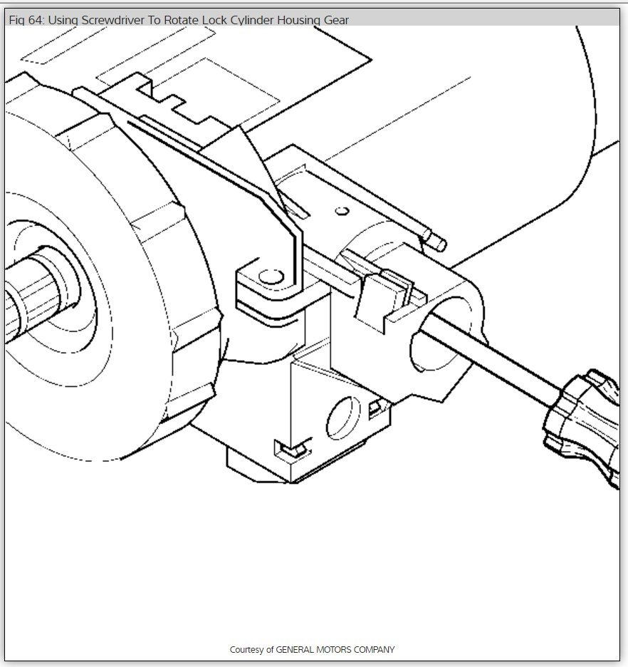

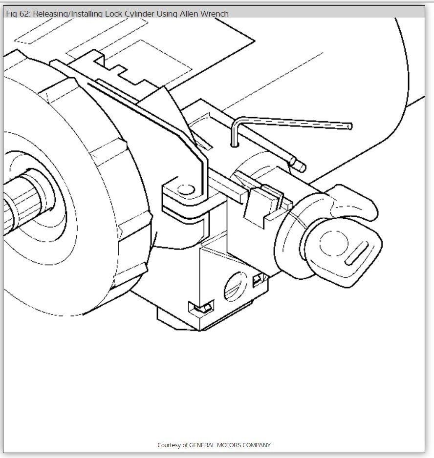

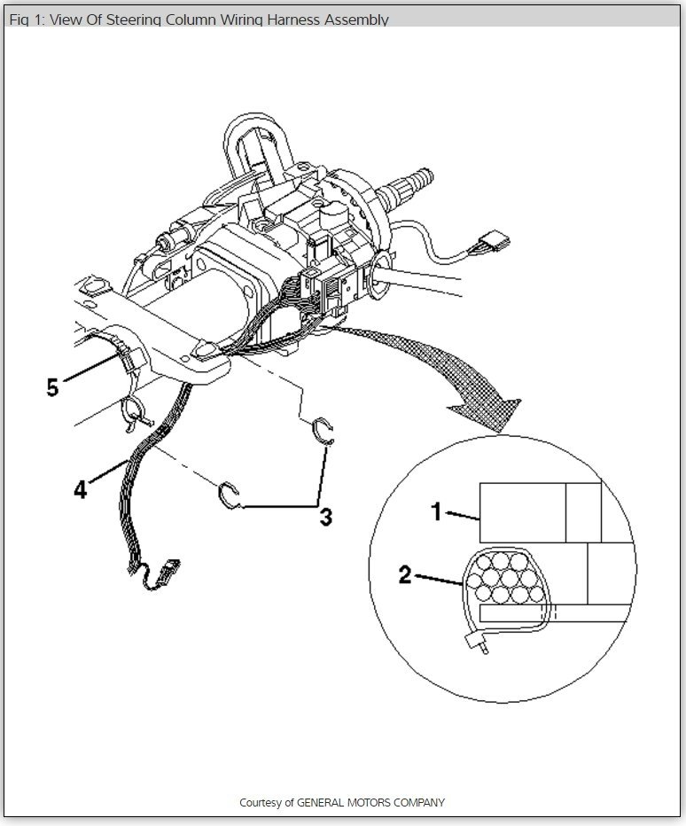

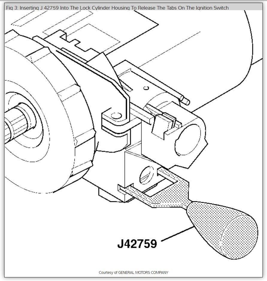

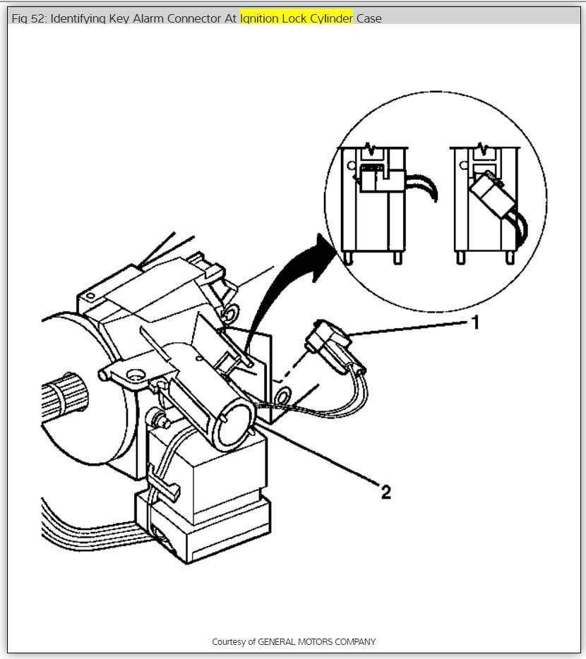

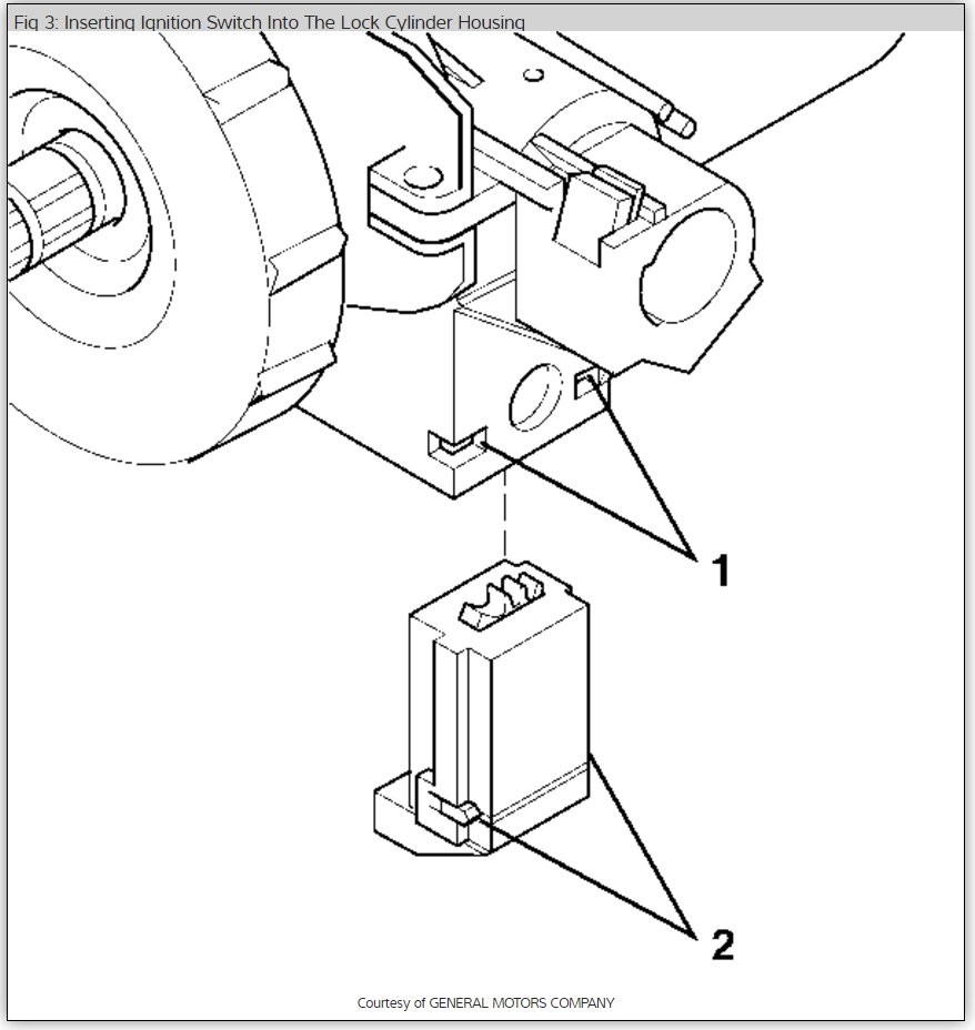

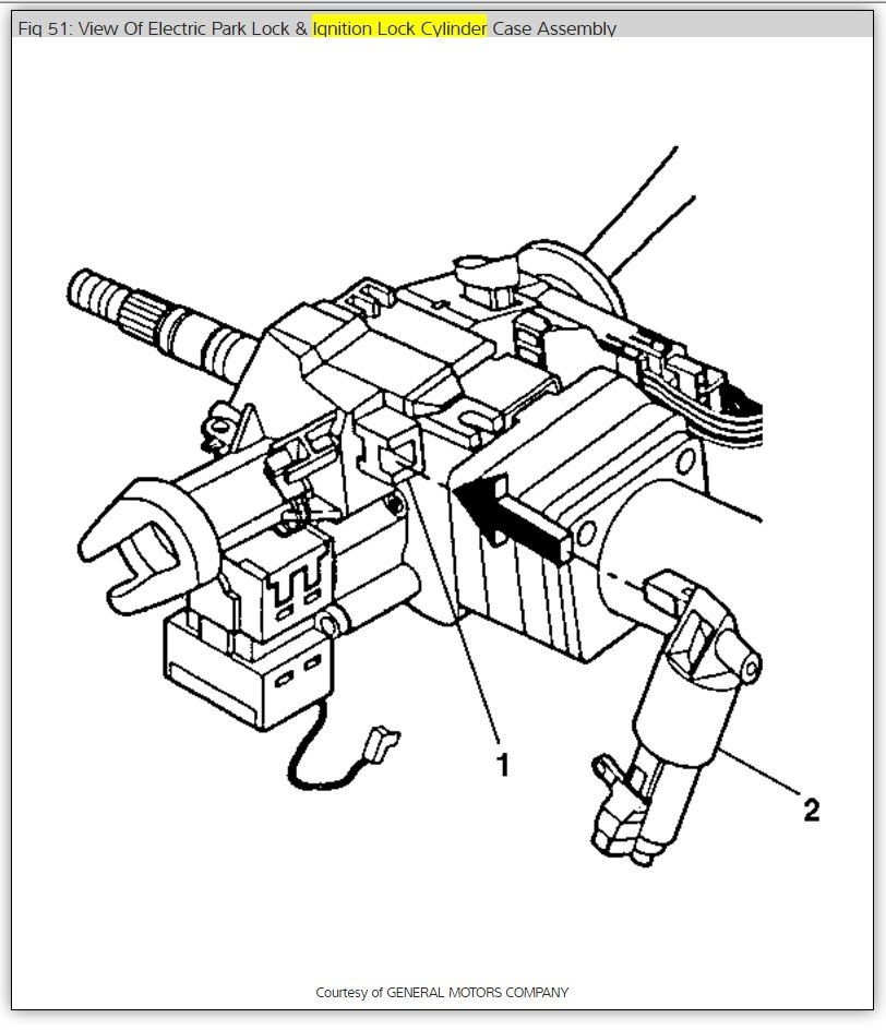

If it is the ignition switch, how easy is that to replace by a novice level? I do oil filters, starters, plugs etc when I can get to them.
Apr 7, 2008 at 6:56 AM
RHALL77
  • 3,361 POSTS

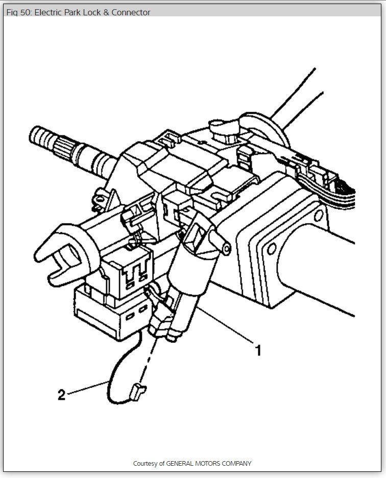

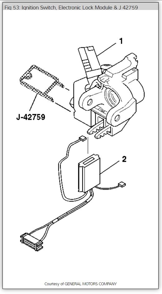

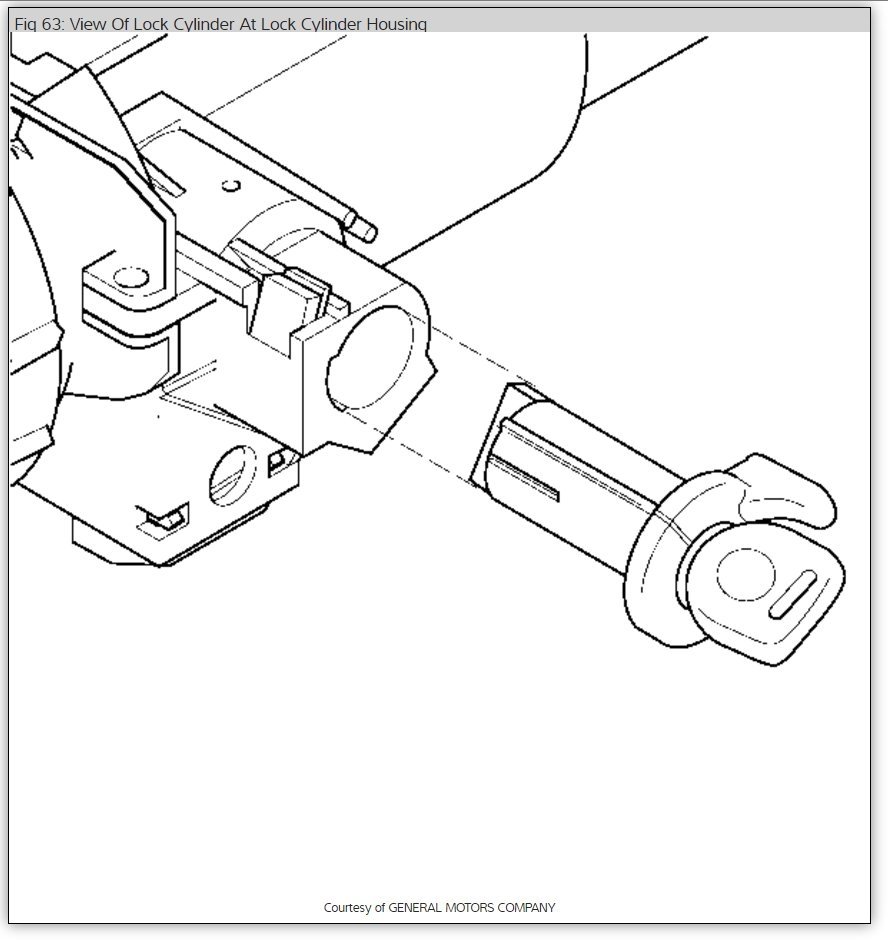

Here are the instructions on how to change out the ignition switch which is not that hard. Check out the diagrams (Below). Please let us know if you need anything else to get the problem fixed.
