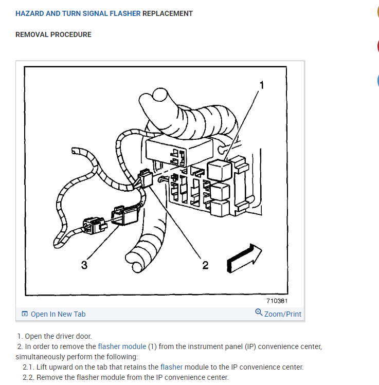

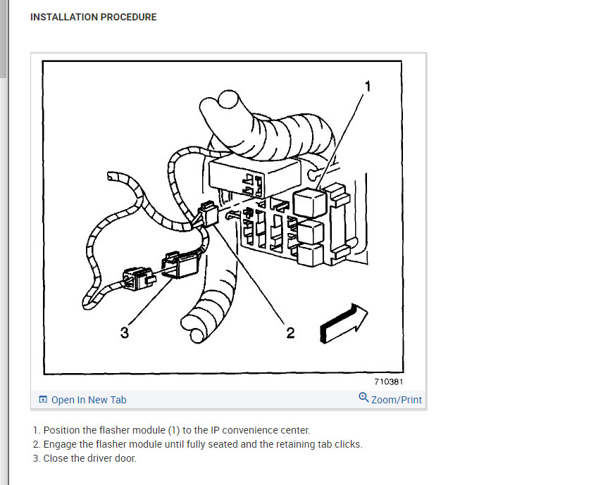

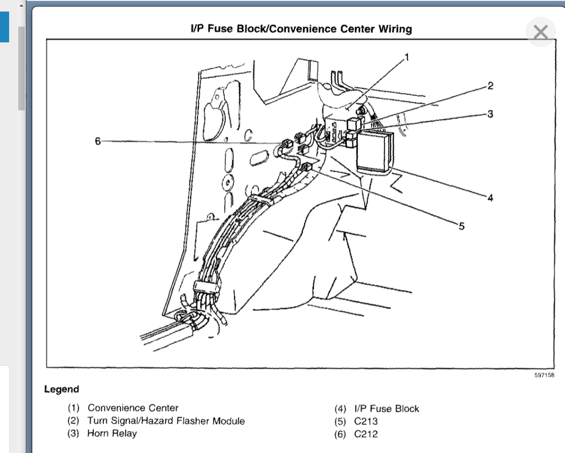

This is called a turn signal flasher module and it is in the driver foot well.
Here are a couple guides that will help with this:

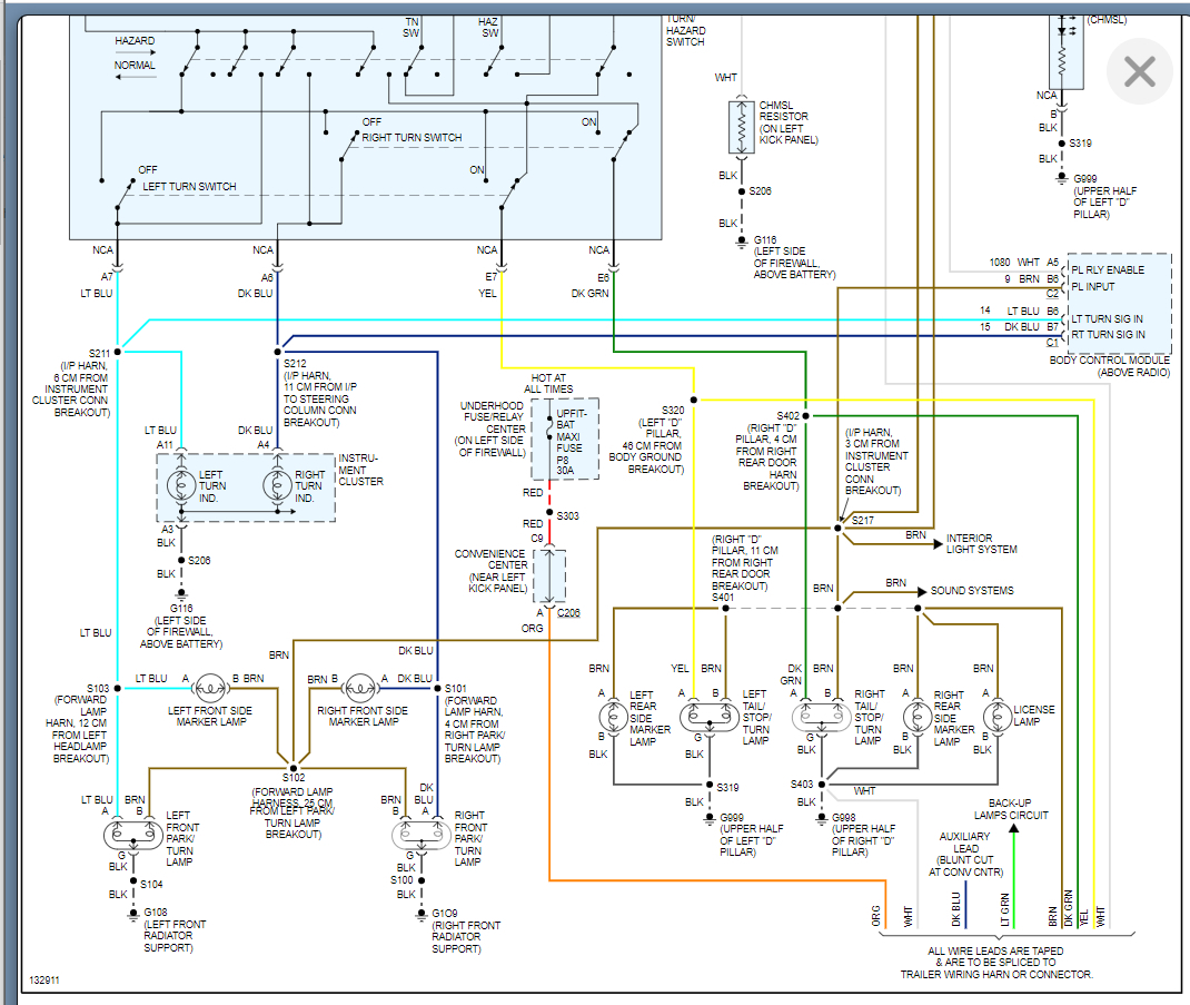

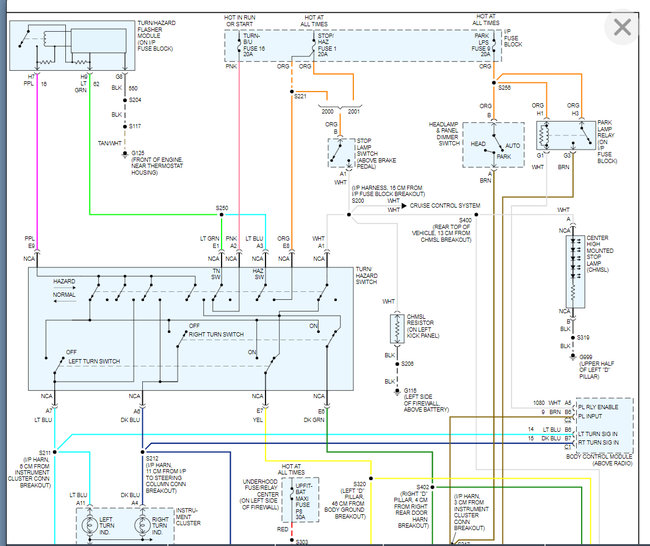

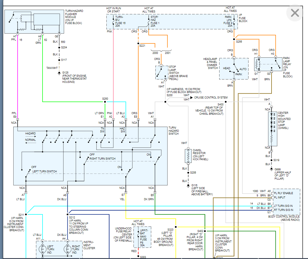

Below you will find the wiring diagram and the location view and process to replace it.
Please run through this and let us know if you have other questions.
Thanks
