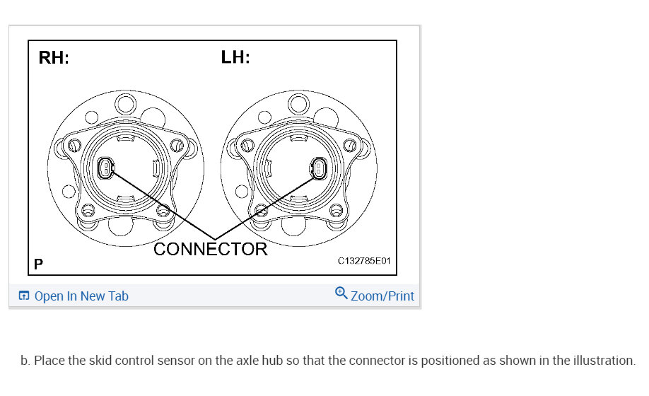

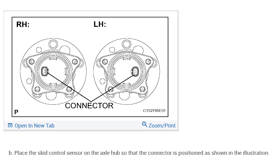

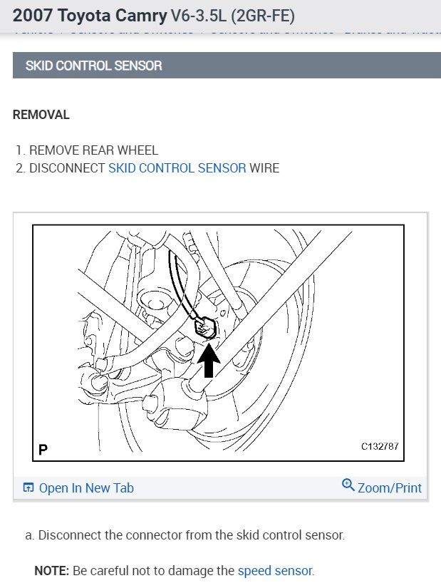

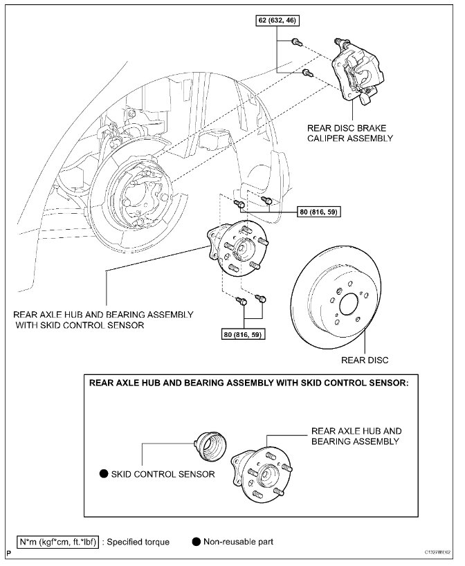

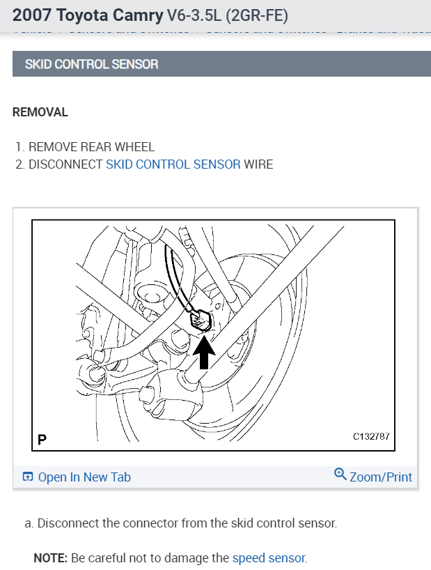

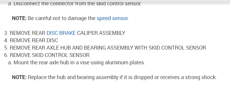

I would start with the replacement of the rear wheel speed sensor and then clear the codes to see what happens. I included instructions in the images below. I would replace the bearing hub and sensor together because the bearing can go out causing the sensor not to work.
C1201: This code indicates a problem with the Engine Control Module (ECM) communication circuit.
C0365: This code relates to a problem with the traction control input signal.
C1241: This code points to a problem with the ABS control system.
C1237: This code indicates a problem with a rear wheel speed sensor.
Check out the images (below). Let us know what happens and please upload pictures or videos of the problem so we can see what's going on.
