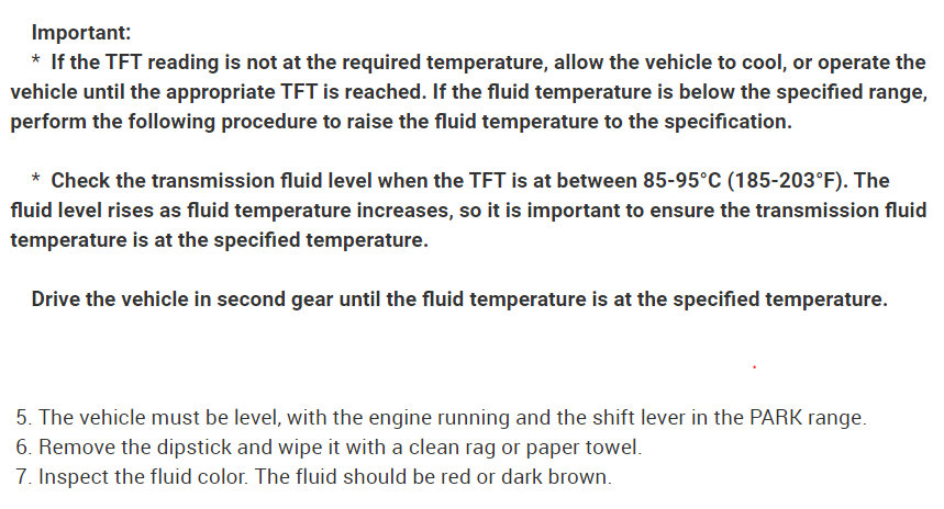

Hi, where is the transmission fluid level plug located?

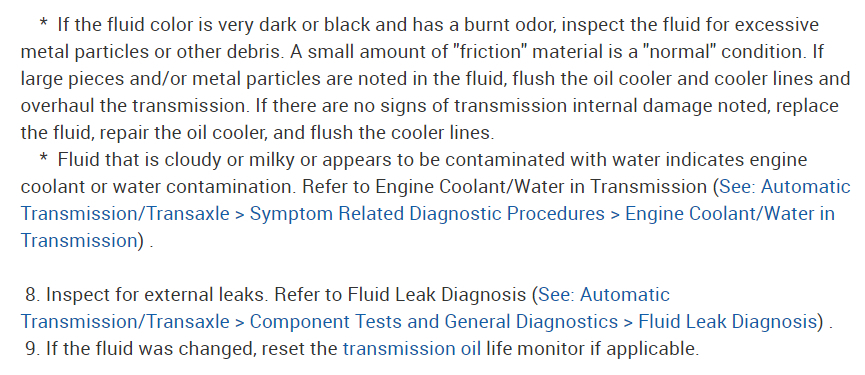

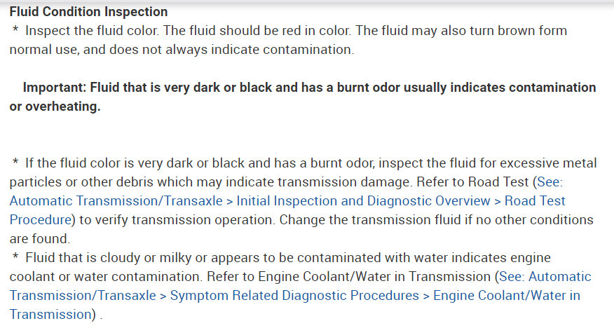

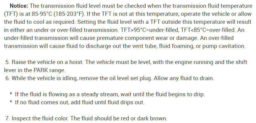

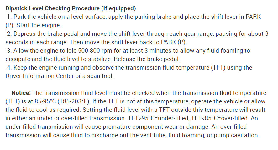

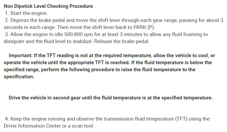

As far as visually checking the transmission fluid level I found this video for you.
https://youtu.be/ualklGHjBYM?t=3
I've attached picture steps below describing how to check the fluid level as well. Hope this helps and thanks for using 2CarPros.
