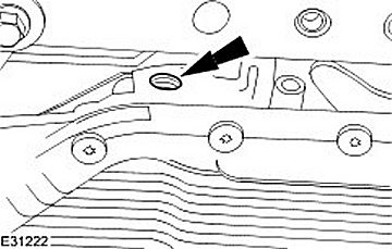

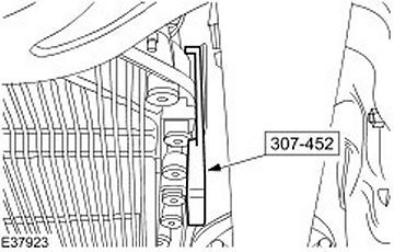

Special Service Tools
picture 1
Adaptor 307-452
Check

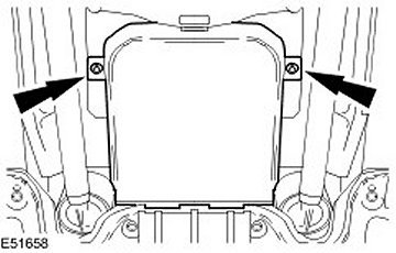

5. Raise and support the vehicle.
picture 2
6. Remove the transmission undertray.

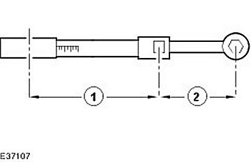

12. Using the special tool and a torque wrench, tighten the transmission fluid fill plug.
- Tighten the transmission fluid fill plug to the torque given by the calculation
- To make sure the transmission fill plug is torqued to the correct specification. Using the special tool and a torque wrench the following calculation steps must be followed.
Step 1.Multiply 35 Nm by the effective length of the torque wrench (1).
Step 2.Add the effective length of the special tool (2) to the effective length of the torque wrench (1).
Step 3.Divide the total of step 1 by the total of step 2.
Step 4.Set the torque wrench to the figure arrived at in step 3.
- Tighten the transmission fluid fill plug to the torque given by the calculation.
