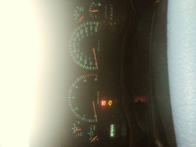

Okay, so i put a new battery now the truck starts on and the rpm's stays at 1200 i have not driven it, it does not turn off, but the check gauges light stills on. that picture is with the engine off it seem like the battery is not charging properly and if i turn the engine on and i do not put a little bit of gas it does not stay on.

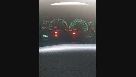

Once i hit the gas pedal a little bit stays on but the rpm's goes to 500 to 800. the battery seems okay, but the oil one empty. i do not know if it works or not.

I cannot see the "check gauges" light in your first photo, but if the engine is not running, that light is going to be on because the oil pressure is at 0 psi.
The do the preliminary test on your charging system, measure the battery voltage with the engine running. You should find between 13.75 and 14.75 volts.
