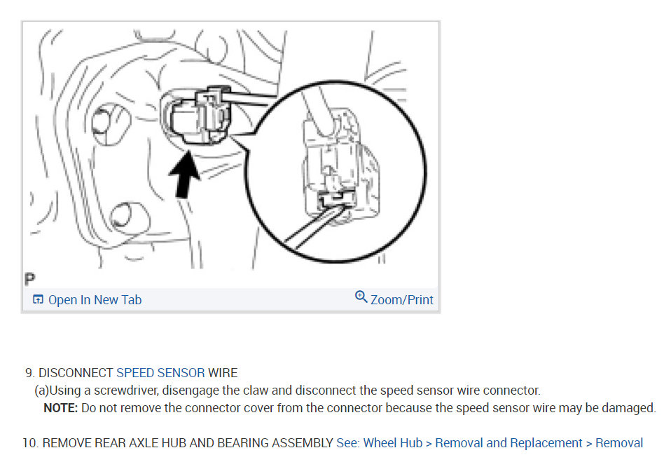

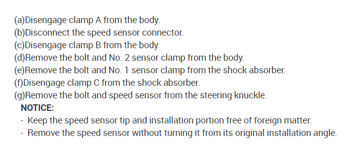

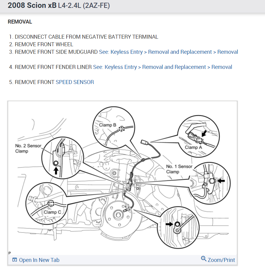

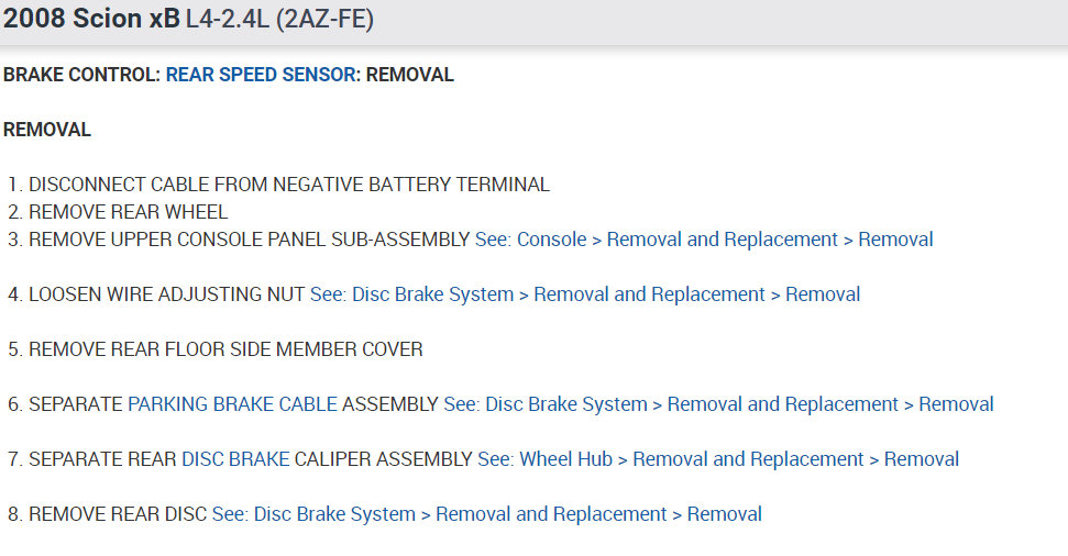

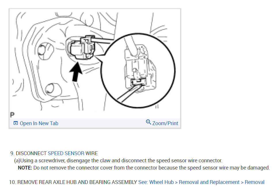

It sounds like you have a wheel speed sensor that is not working correctly but to be sure let follow this video on how to get the codes to help tell us which sensor is out.
https://youtu.be/rTtAnsOlZU4
Here are the instructions below to show you how to change out the wheel speed sensor. Check out the diagrams (Below). Please let us know what you find. We are interested to see what it is.
