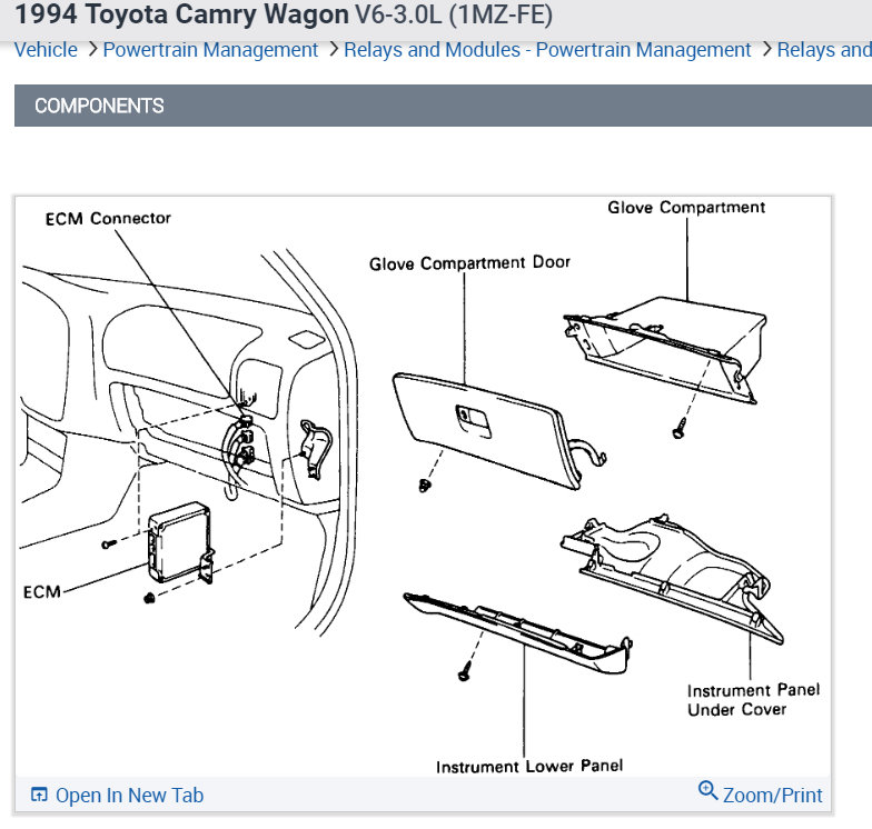

It sounds like the ECM had gone bad I would try to get a used one and plug it in here is the location.
