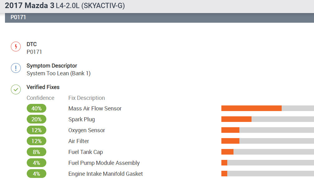

i can feel it shake and vibrate while i drive. I changed spark plugs and MAF did not really help but the code on the OBD changed to suggest p0171 reinstall air duct intake.
Aug 30, 2022 at 9:29 AM
Yep, it sounds like you have a cylinder misfire which will cause the P0171 code. Let's remove the spark plugs and do a compression test. Remove all spark plugs and this guide will should you how:

But would a bad coil pack cause the system to run too lean? That is what the check engine code is saying for P0171.
Aug 30, 2022 at 8:49 PM
Yes, it is for a lean system which a cylinder misfire will cause, 14-1 14 parts air to one part fuel, so 14 parts of air enter the system. Lean

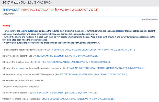

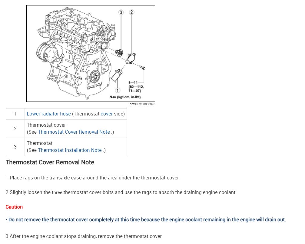

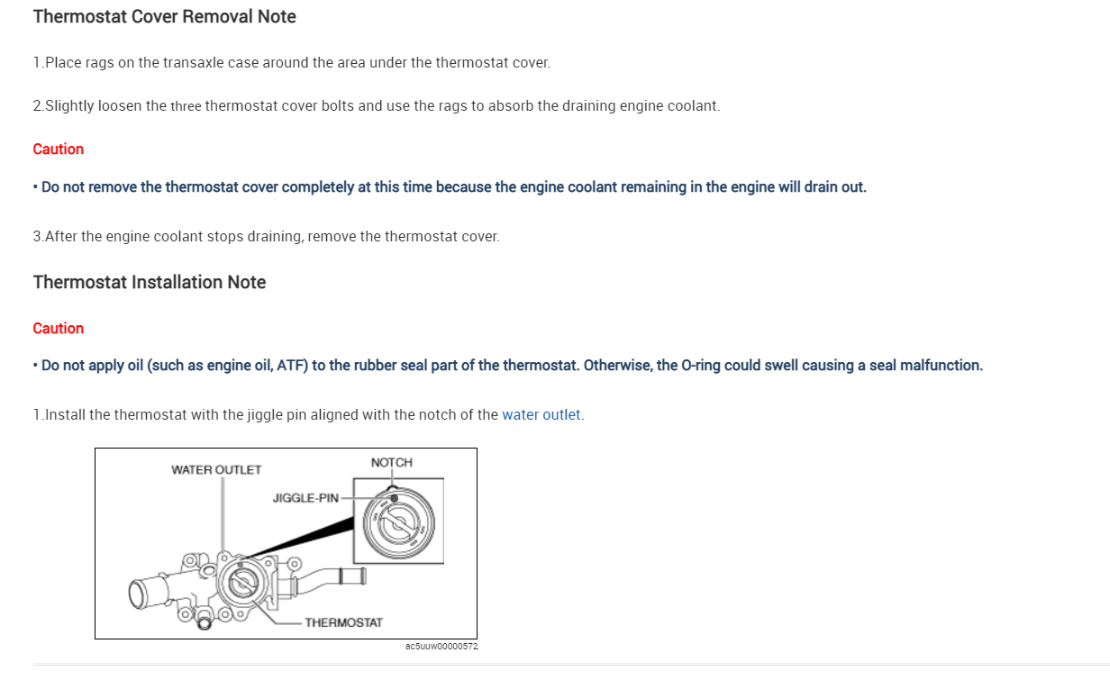

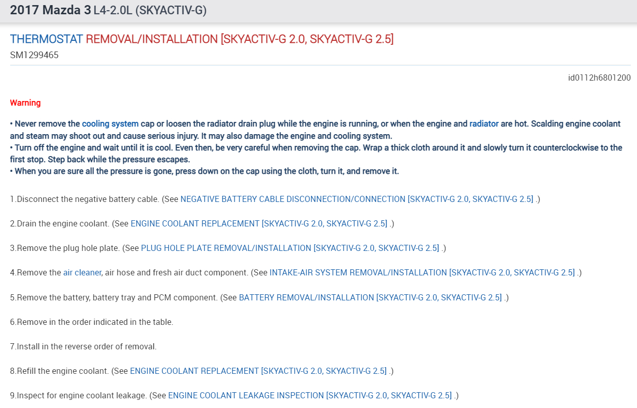

P0171 System Too Lean to the overheating problem will not affect this. Have you tried to replace the thermostat?
Here is a generic guide so you can see what you are in for with instructions for your car in the images below:
And this can help as well:
https://www.2carpros.com/articles/engine-overheating-or-running-hot
Sep 6, 2022 at 6:05 PM

I did not see what to do with a thermostat test. Do i have to flush out the coolant to replace it or can i just replace it? I know some will shoot out.
Sep 7, 2022 at 12:47 PM
When you remove the thermostat, drop it into a pan of boiling water, it should open quickly. Yes, before you begin drain the coolant out of the system to minimize spillage.
