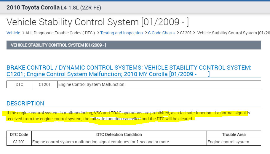

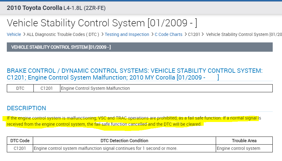

I attached the info from the C1201. I highlighted the area of interest. The P2195 falls into the category of an Engine System Malfunction, so the oxygen sensor code is what is likely causing the issue.
If the sensor is frozen lean, chances are it is bad. However, before you replace it, have the computer scanned to see if the lights go out. If they do and then come back on, suspect the sensor needs to be replaced. It could also be a wiring issue, but chances are it is the sensor itself.

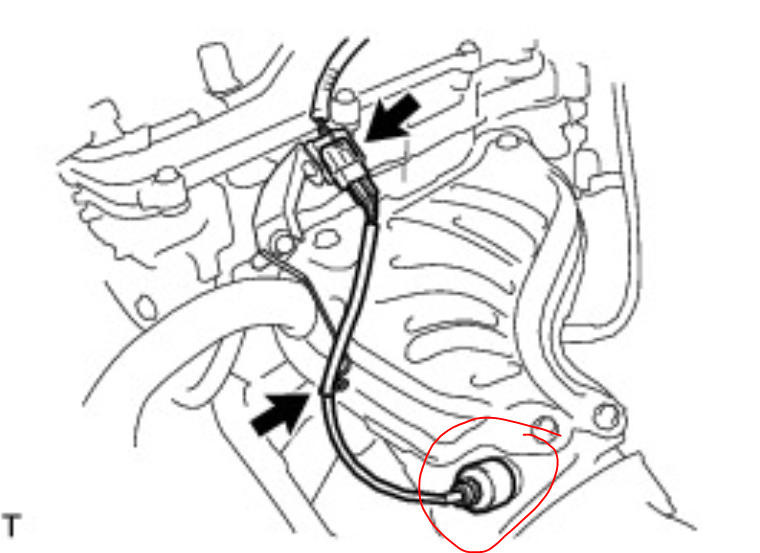

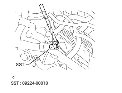

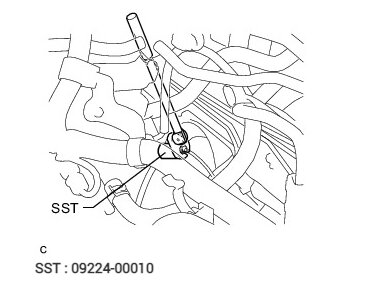

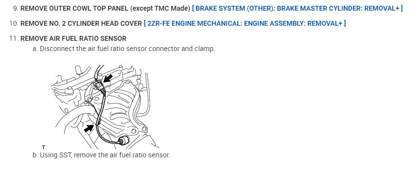

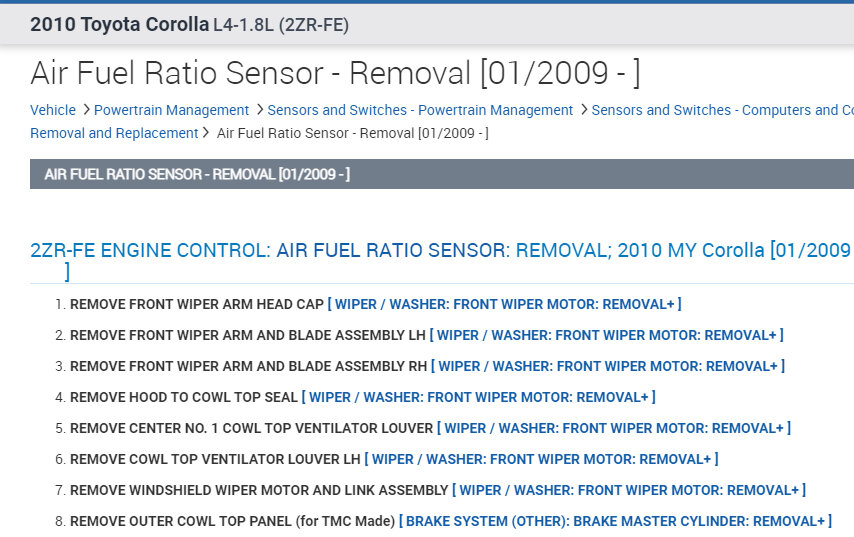

The sensor is located between the engine and firewall right before the catalytic converter. To access the sensor will be somewhat of a nightmare because several things need removing. See pic 1 for location.
The remaining pictures are the removal procedures. Note that if there is a step you need help with, let me know and I'll get you the specifics.
As far as the scan, if you remove the sensor and use the link I attached above, you can skip the scan until we confirm if the sensor is good or bad.

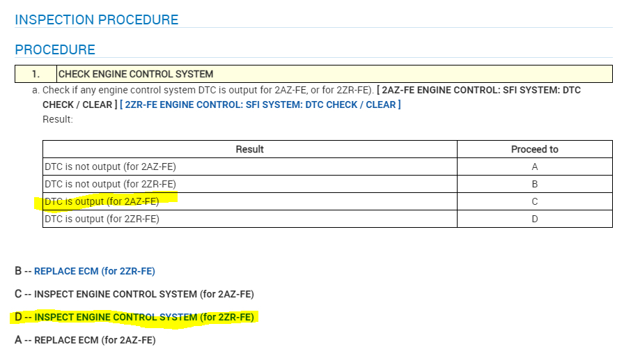

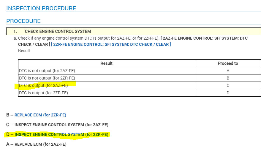

Wow, that is quite a list. Most of the things listed won't affect the drivability. The C1201 is a little different.
The C1201 is tied into the stability/VSC and traction control. If the engine control system is malfunctioning, VSC and TRAC operations are prohibited, as a fail-safe function. So, the reason those lights are on is likely due to the other codes.
