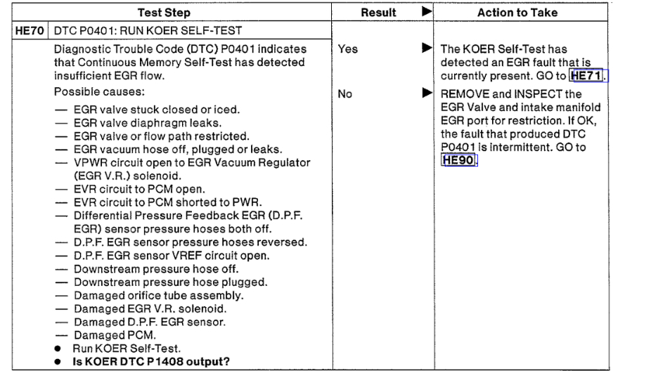

the 401 is common for the delta pressure sensor.
Chart below.
Apr 9, 2018 at 9:21 AM

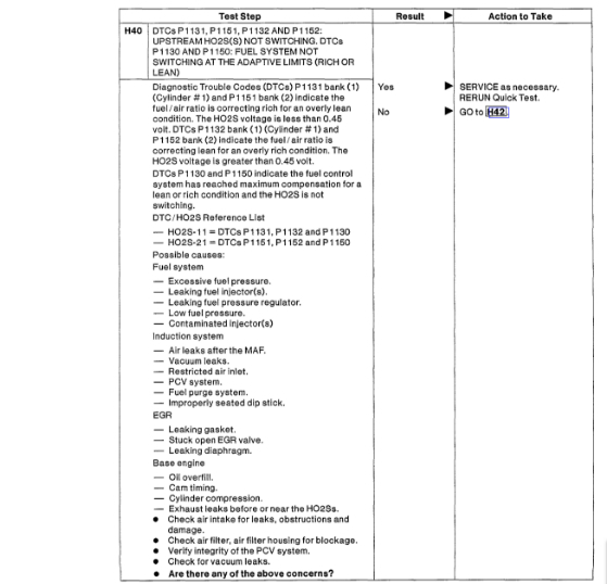

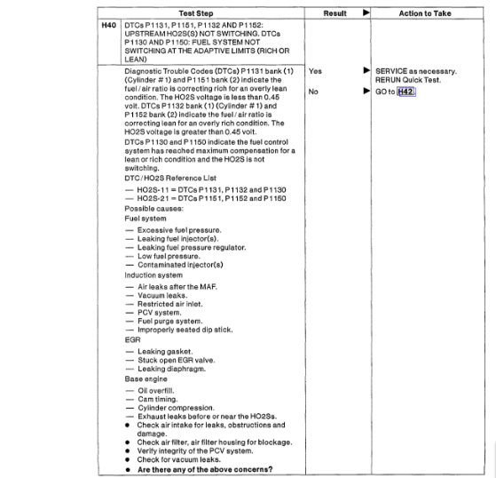

1151 chart and possibilities below.
Apr 9, 2018 at 9:23 AM

The 401 code, yes.
