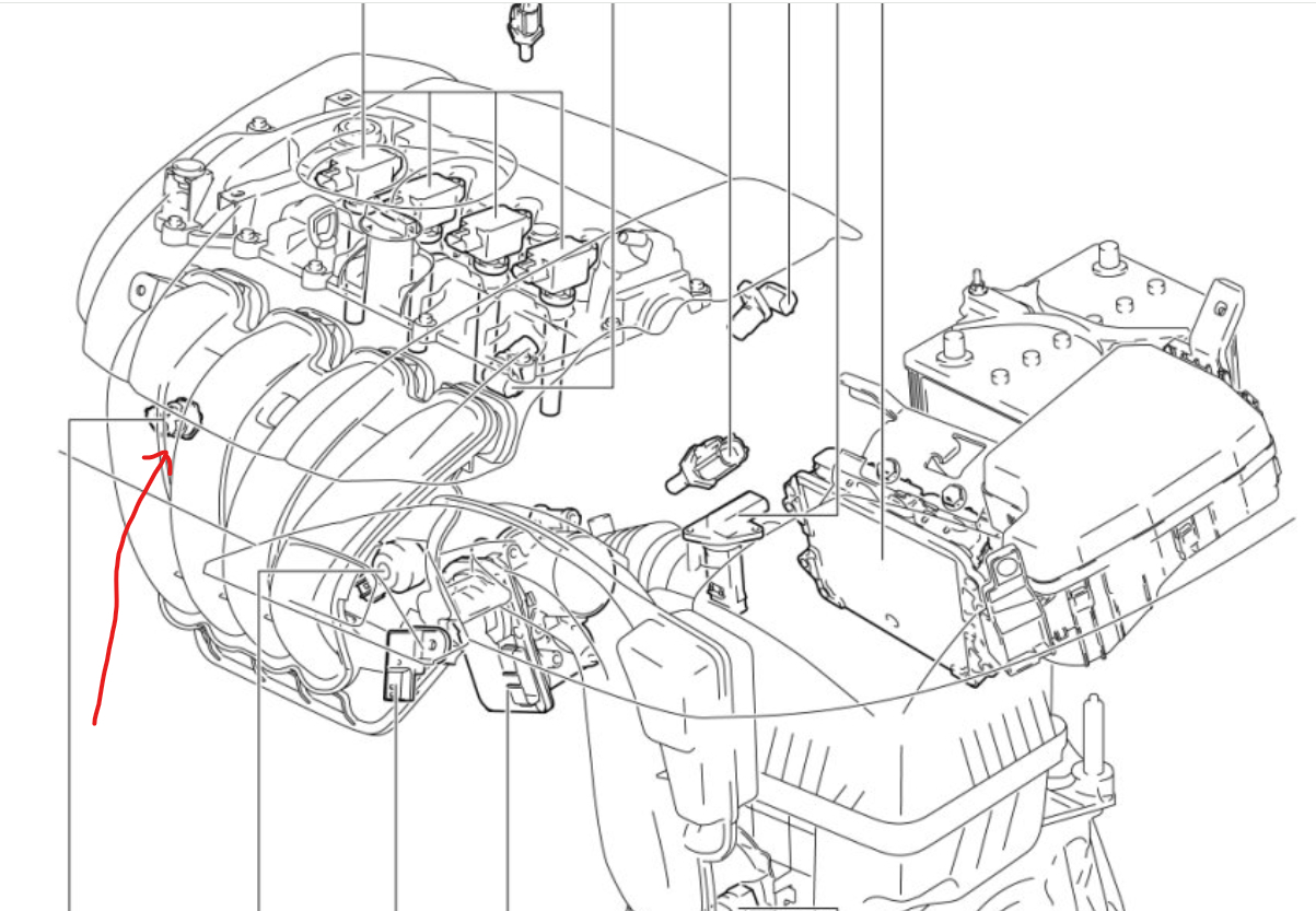

I would replace the fuel pressure sensor which is common and then clear the codes to see if the pending P1450 code comes back.
P0192 - Fuel Rail Pressure Sensor Circuit Low Input (Current):
Here is the location of the sensor. Check out the images (below). Please let us know what happens.

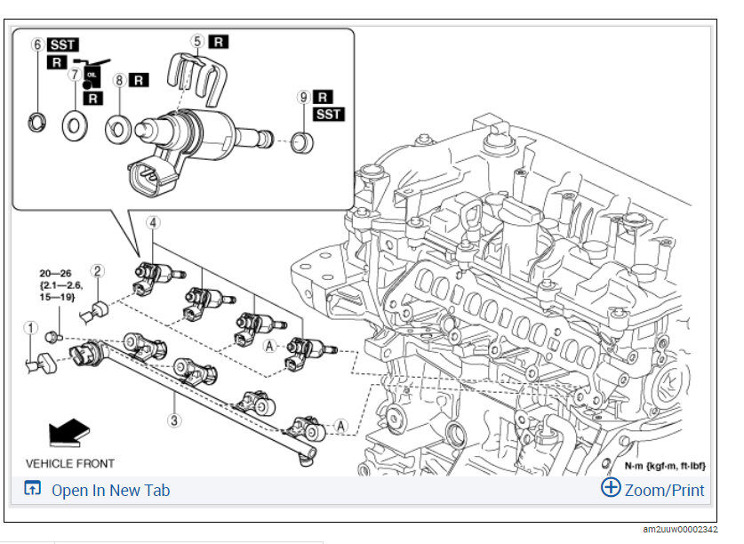

Looking and looking for this sensor. Can't find a part number. Could it be, it's only sold with the whole fuel rail on my car? I can see what looks like the correct sensor in images of the entire fuel rail. I noticed in my original post I said 2016, but when checking the VIN, I guess mine is a 2015. Maybe that makes a difference? JM3KE2CY9F0478828 Thanks
Sep 1, 2024 at 7:30 PM

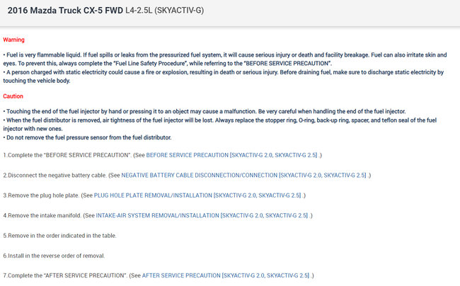

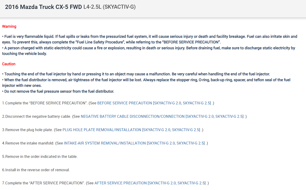

Yep, you are correct:
The fuel pressure sensor cannot be removed as a single unit. When replacing the fuel pressure sensor, replace it together with the fuel distributor as a single unit.
Sep 2, 2024 at 10:45 AM
