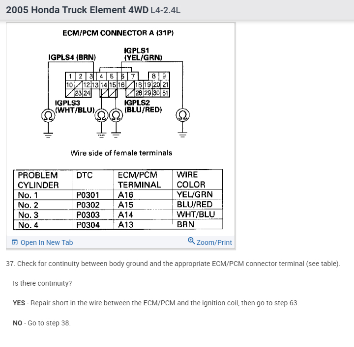

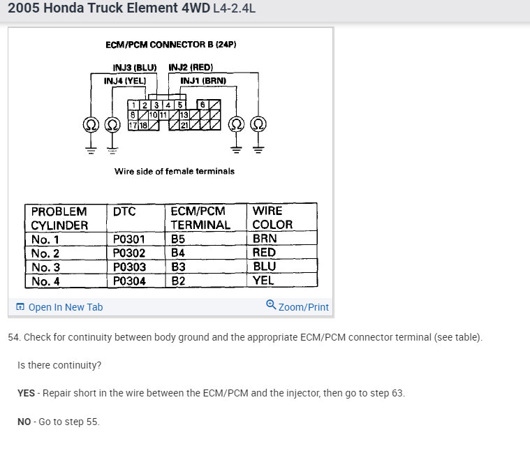

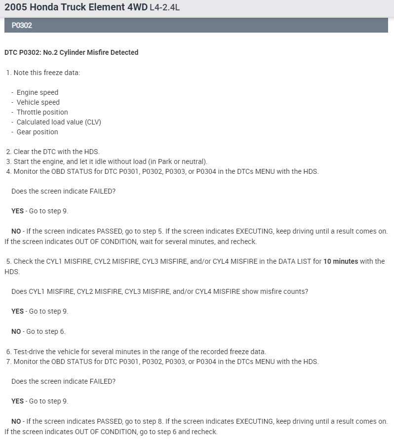

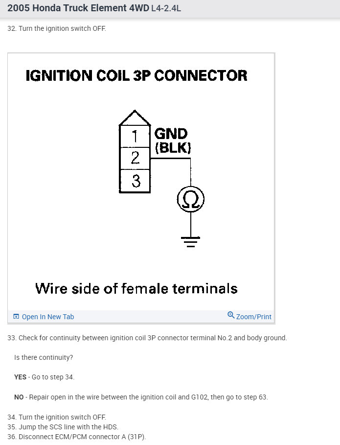

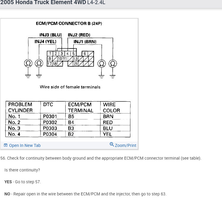

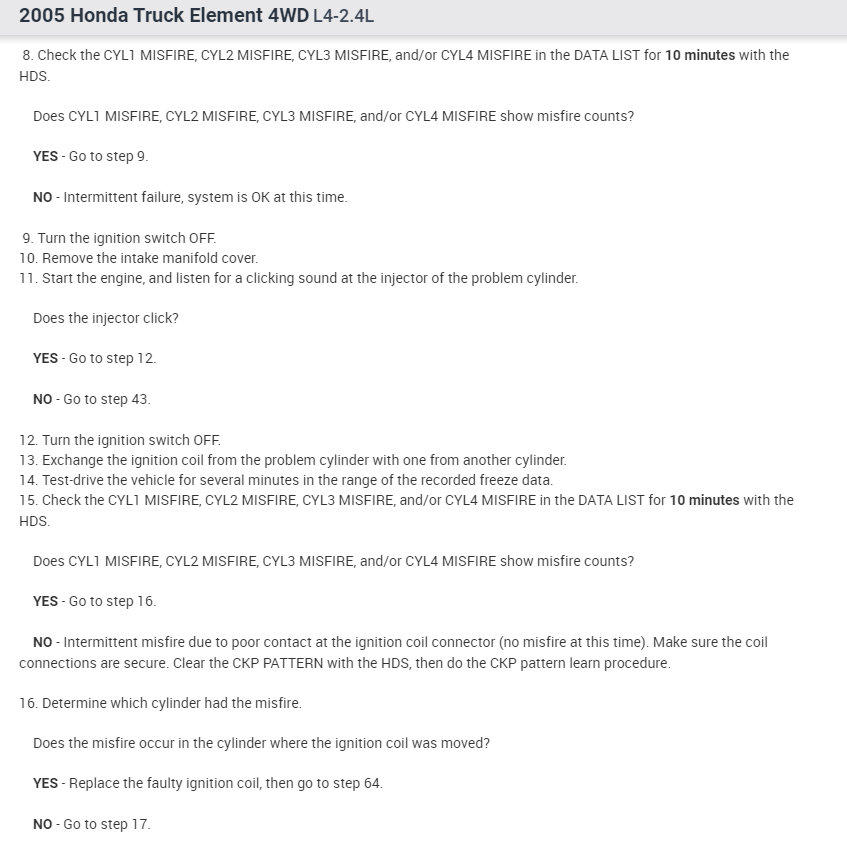

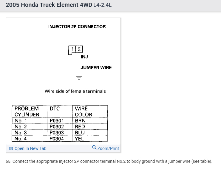

The code P0302 is due to misfire in cylinder two.
It could be simple as a worn spark plug.
It can also be due to a faulty injector or even the ECM.
Here is a helpful guide on how to diagnose engine misfire:
https://www.2carpros.com/articles/engine-misfires-or-runs-rough
As for finding a good mechanic, you will have to just call around a few of the reputable local shops.

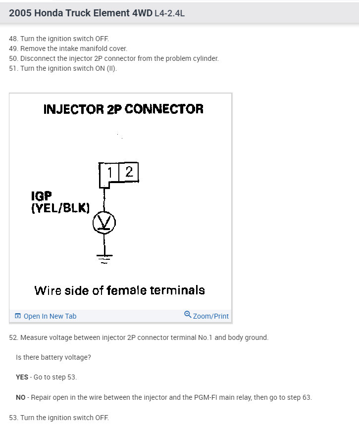

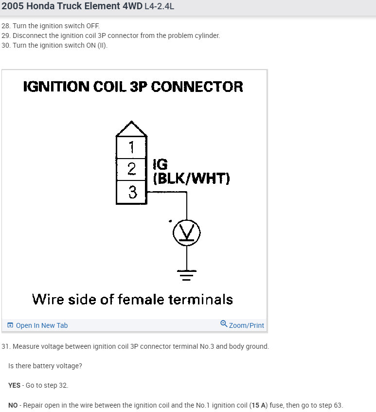

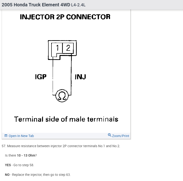

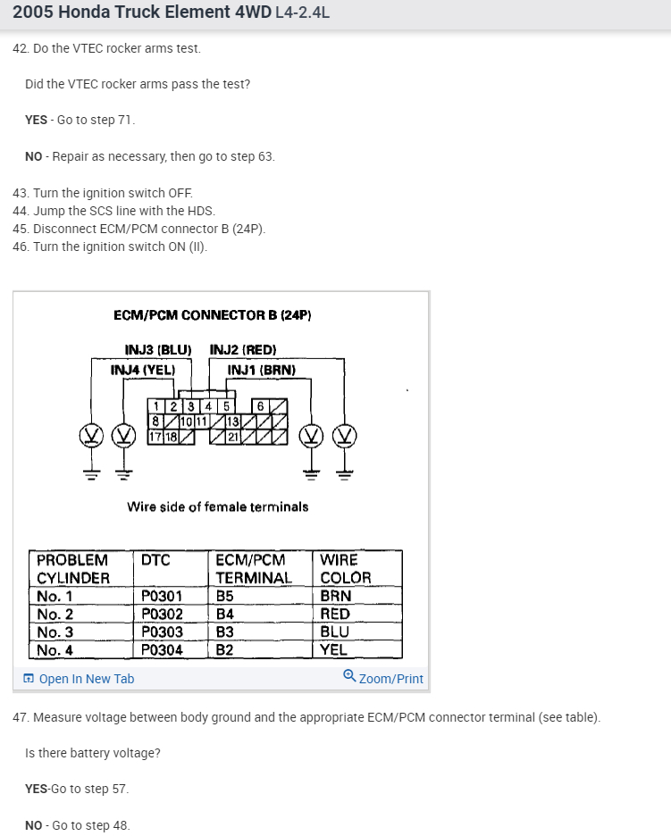

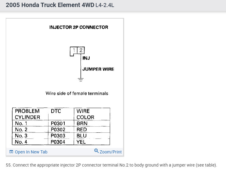

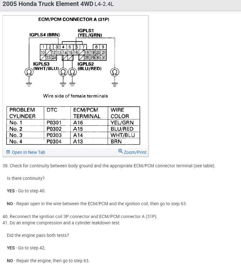

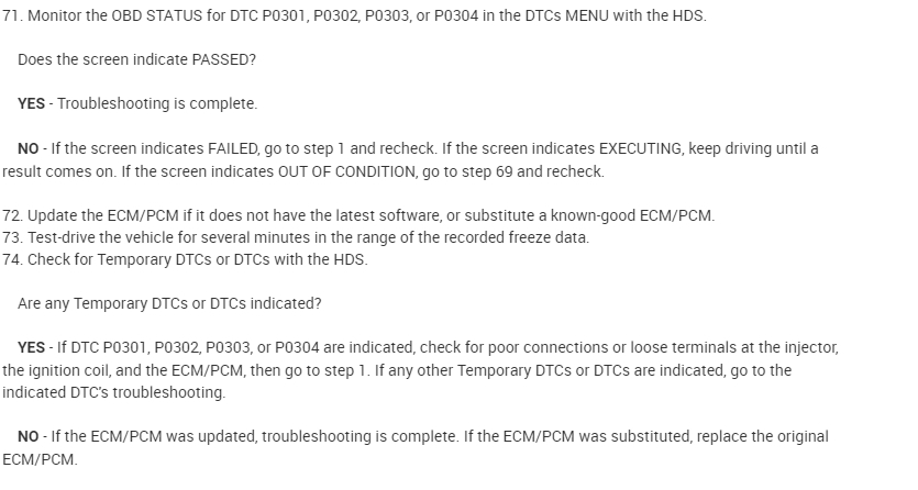

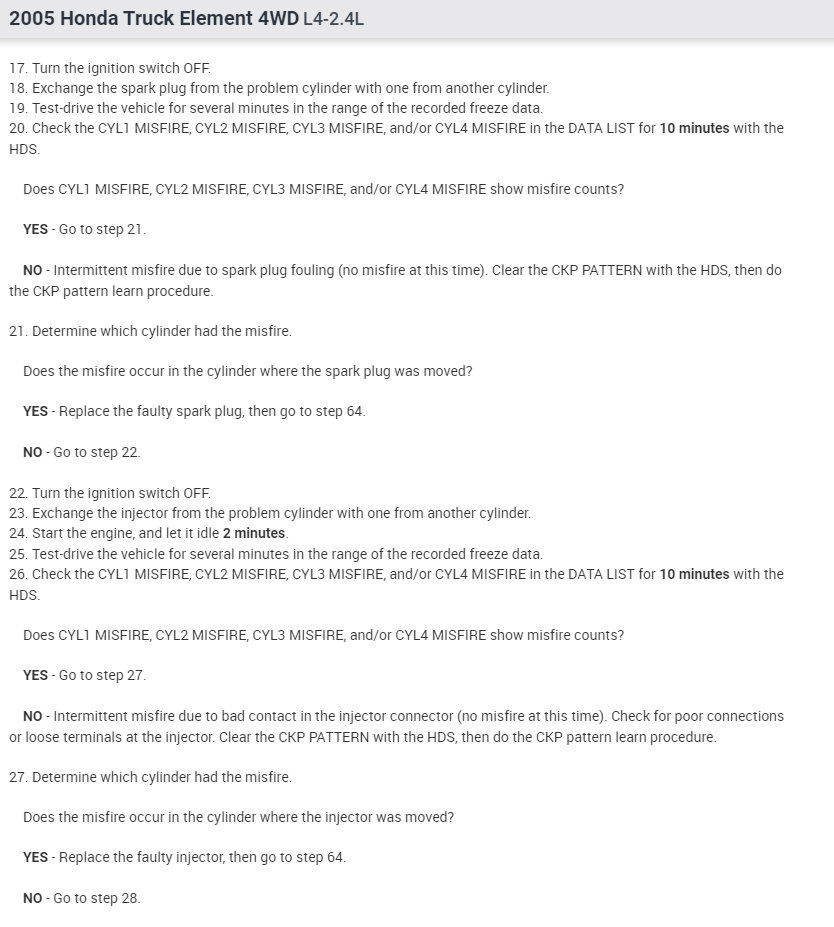

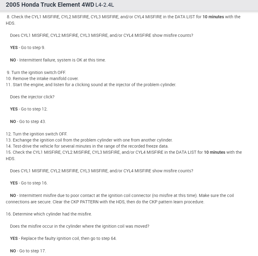

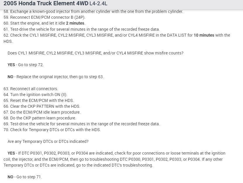

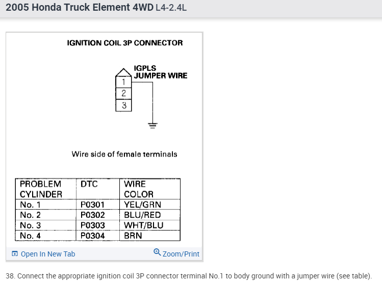

I have attached the diagnostic procedure for the code P0302 below for your reference.
Let me know of any questions.
