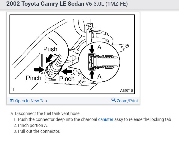

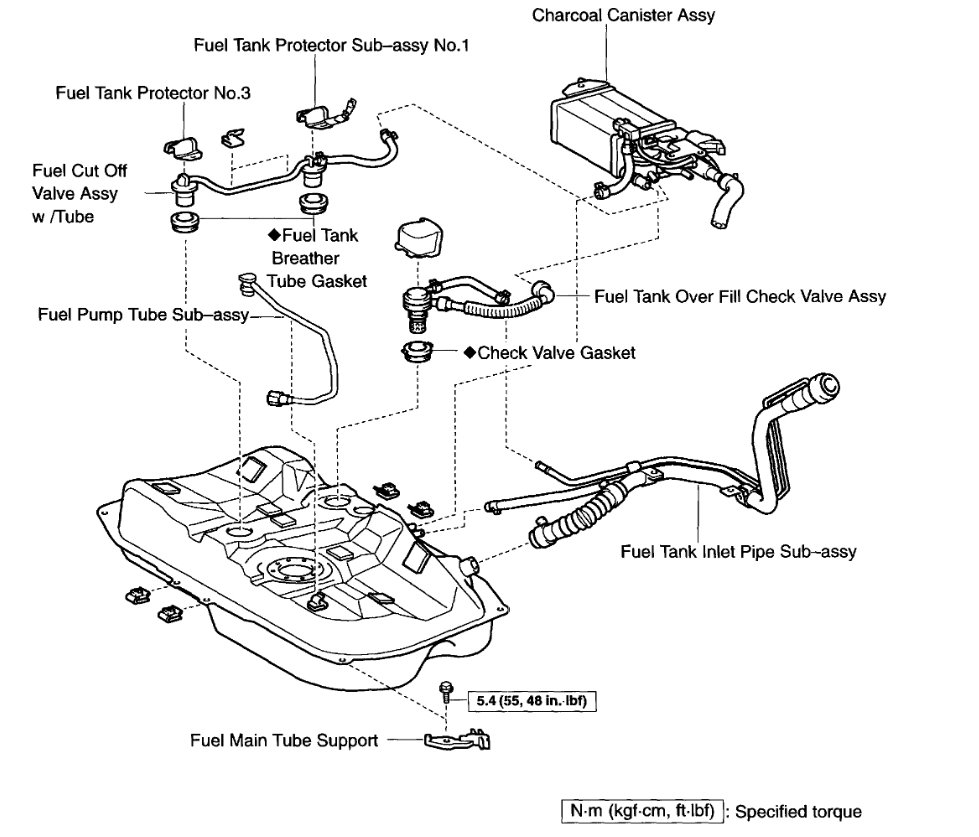

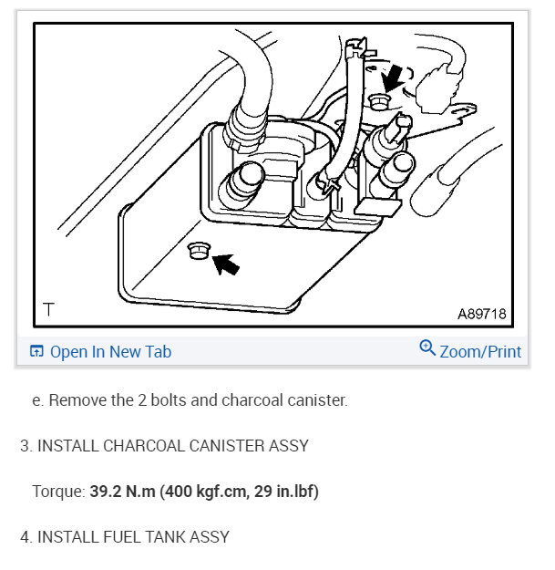

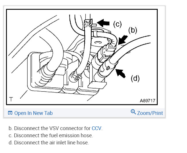

Shop gave me codes p0440, p0441, p0446, said car needs canister, purge valve and fill cap. Quoted $1,625.00 parts and labor. Is the cost reasonable? Is it worth it to even fix? :-(
