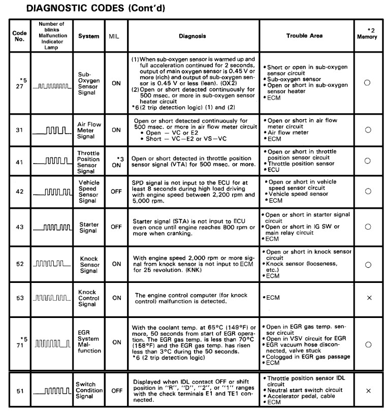

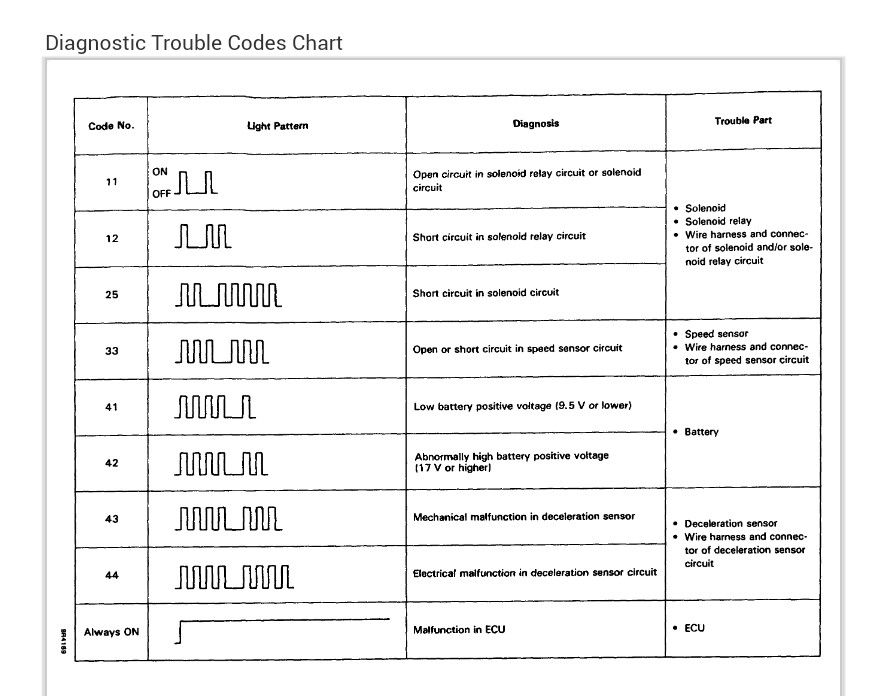

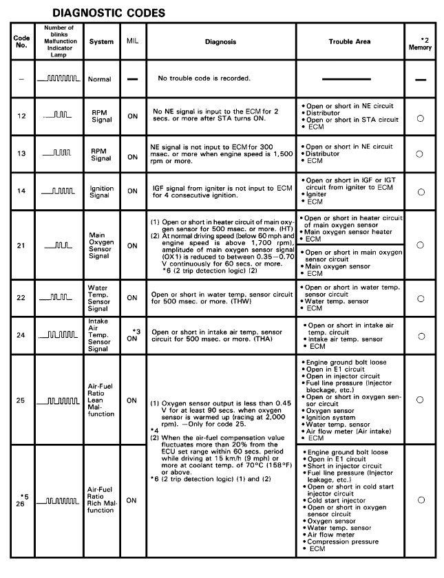

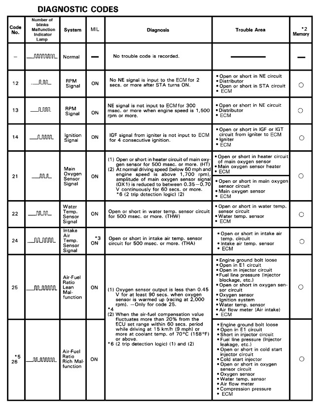

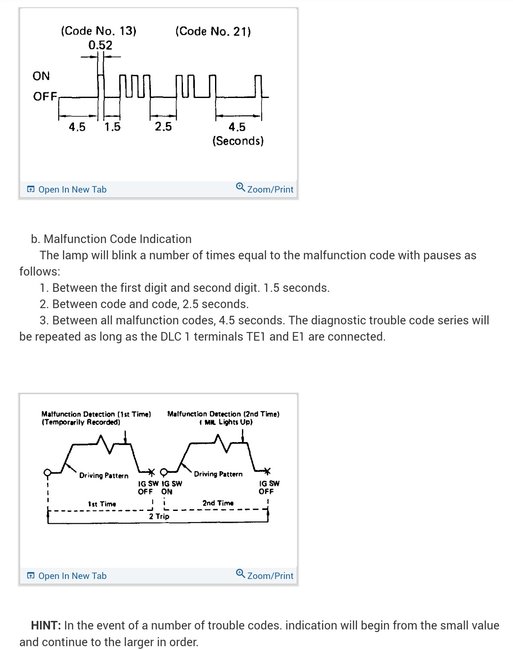

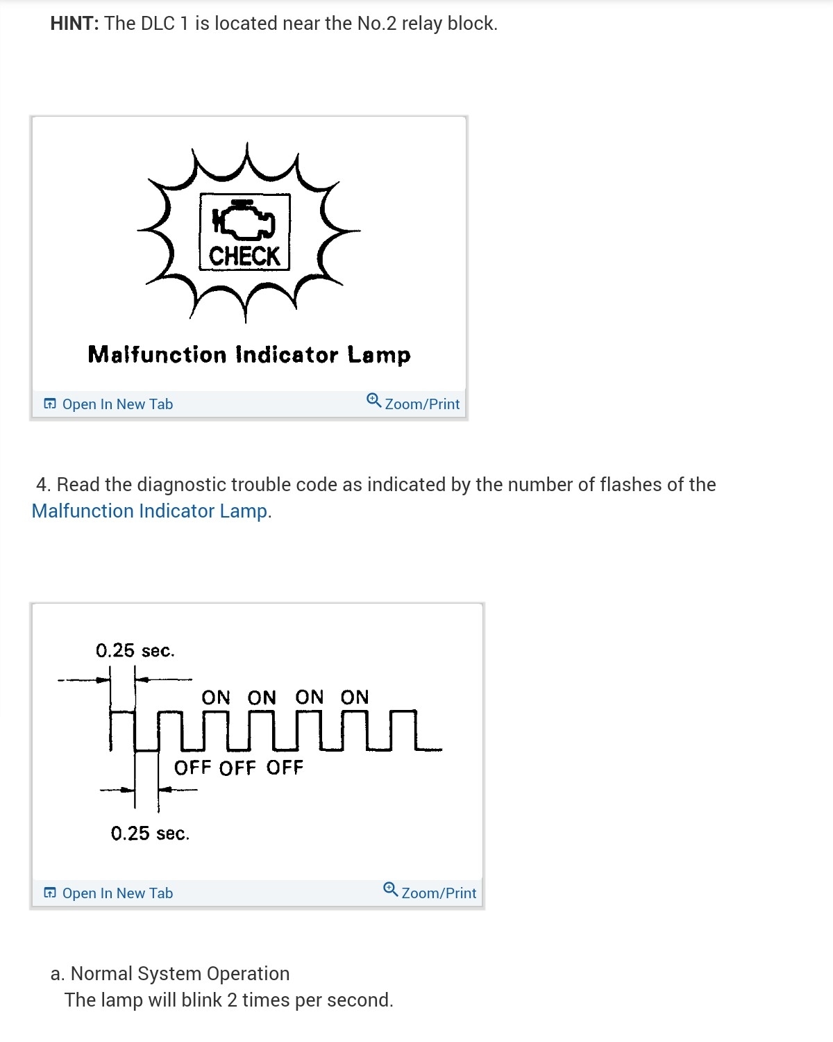

Hello, sorry to hear of your issues there. The engine computer is seeing an intermittent fault. There should be a diagnostic trouble code stored in the ECM (engine computer). Here are the instructions for retrieving diagnostic codes for truck. Let us know what codes you get from watching the check engine light flash. Also be sure to check all the fuses. With wires being shorted out like that, there may be a blown fuse. Here is our YouTube page as well, there are many videos that might help you: Edit I'm adding the list of codes and their definitions.

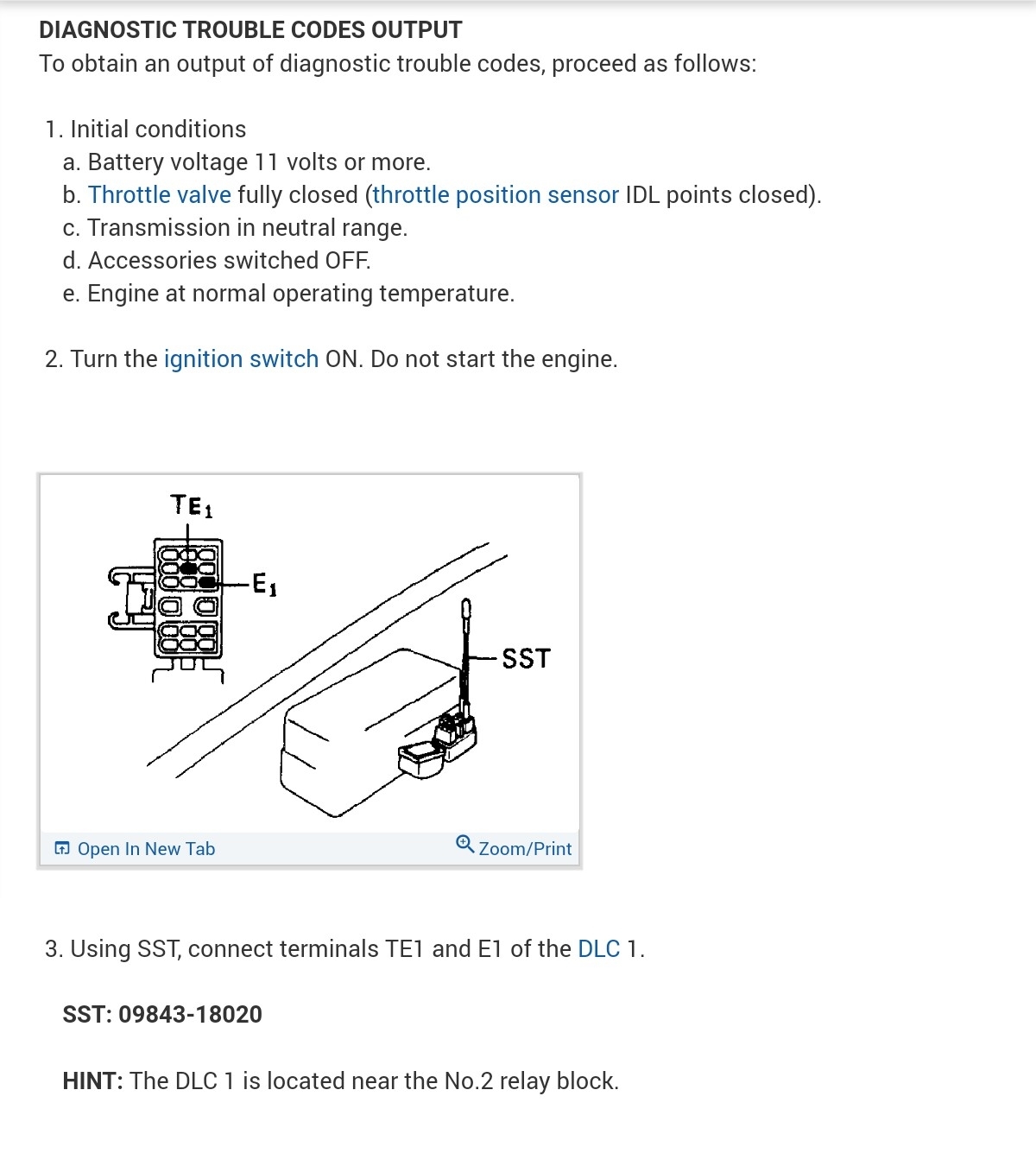

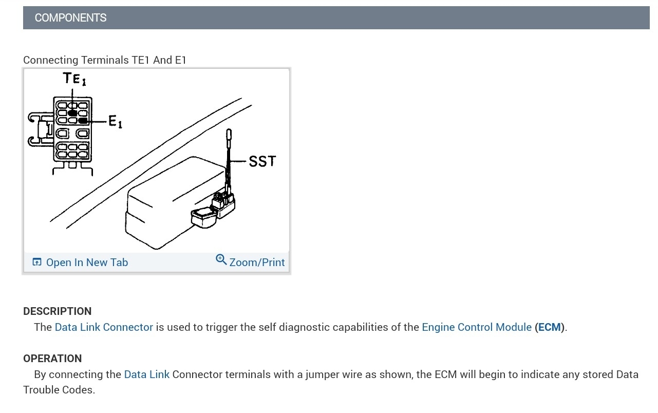

I put a wire on the e1 and e1. And the engine light stays on. No blinking at all.

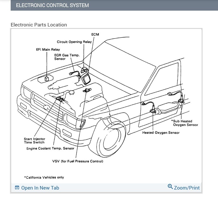

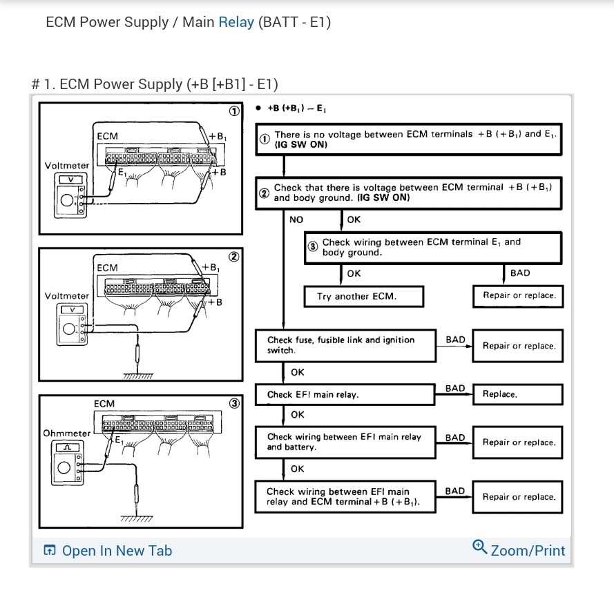

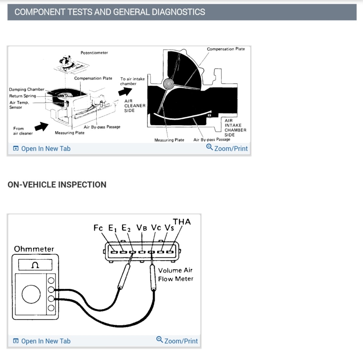

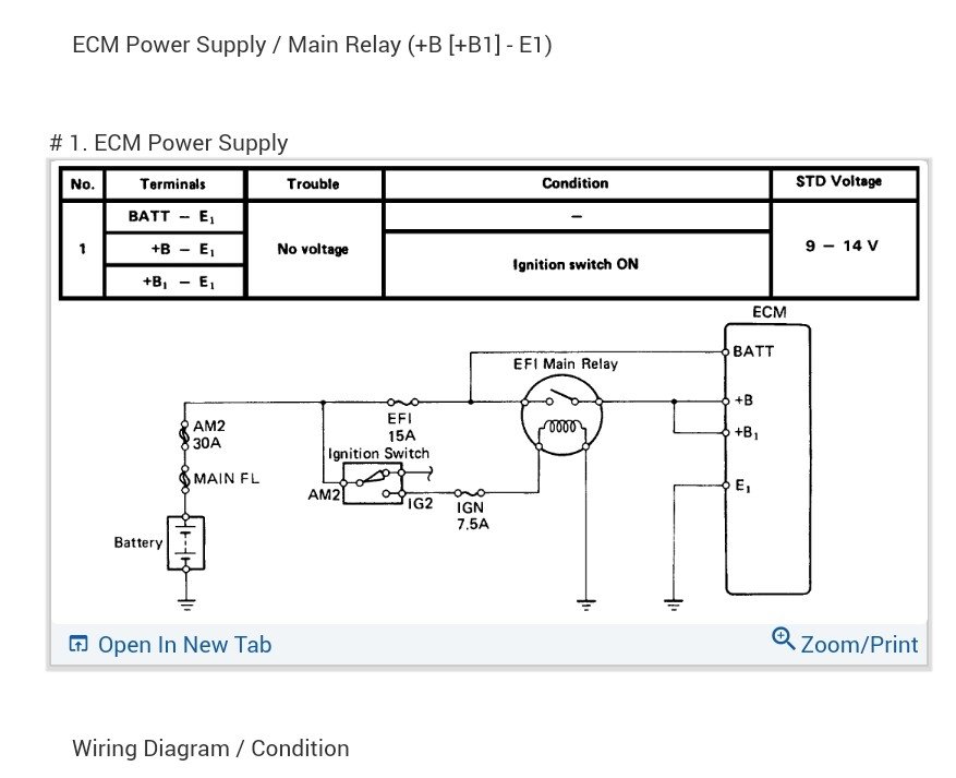

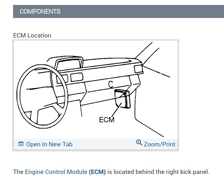

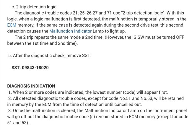

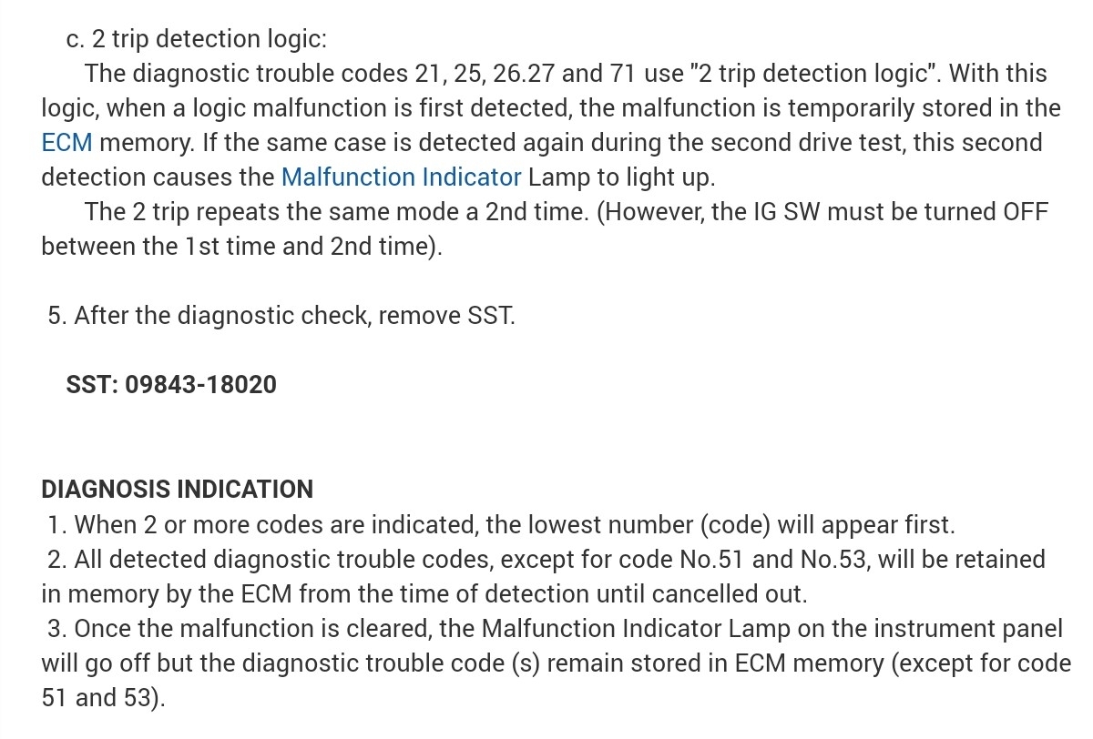

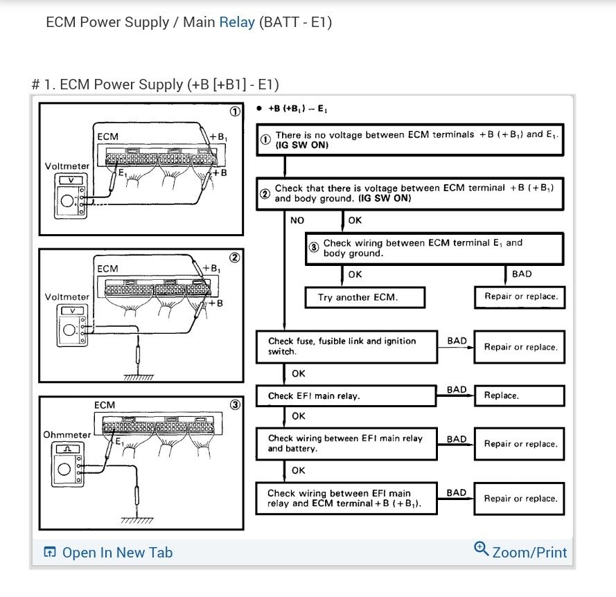

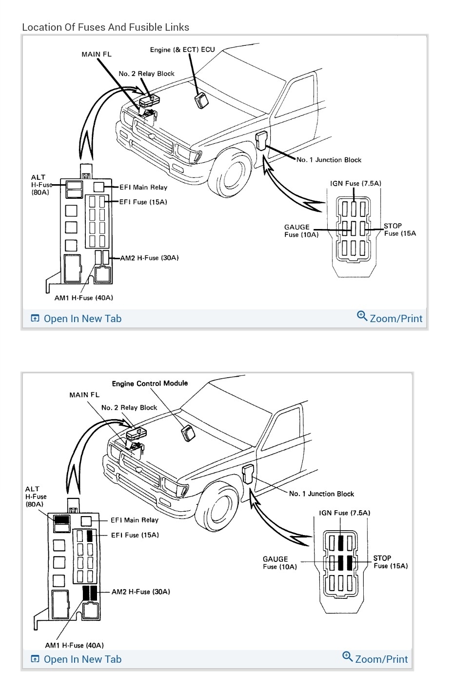

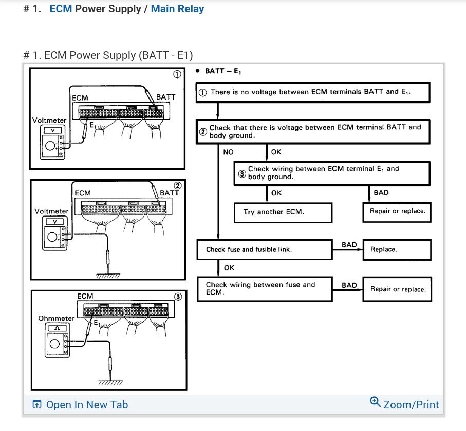

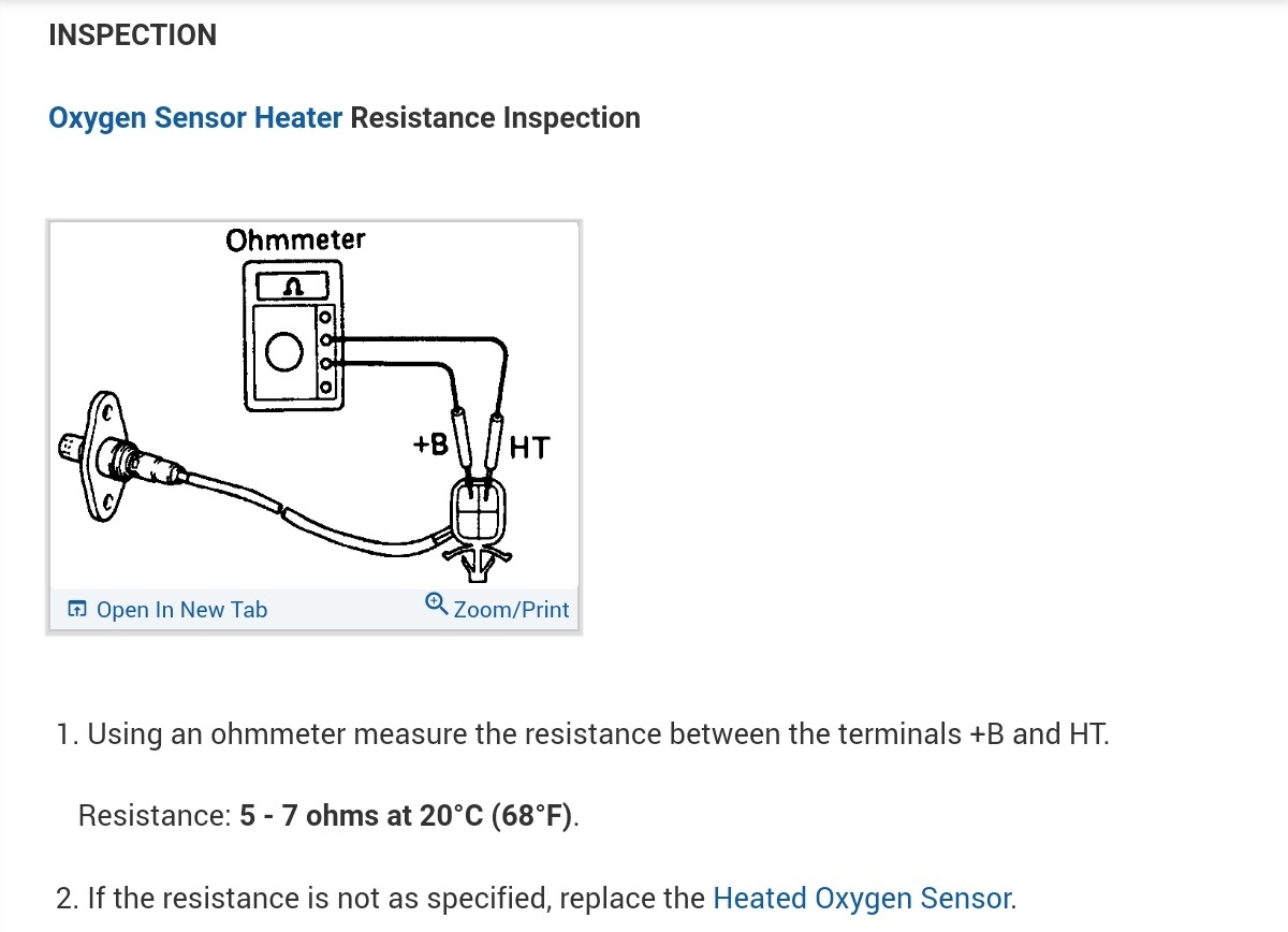

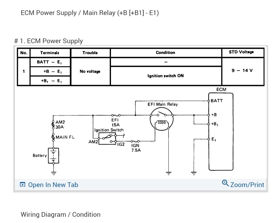

Did you follow the instructions closely? the engine must be at operating temperature, all accessories off, and vehicle in neutral and the pins are TE1 and E1. This might take a couple tries. Was the damaged oxygen sensor replaced, and all the fuses checked? The first 2 diagrams show where the fuse boxes are, one in the engine compartment and one in junction block 1, to the left of the steering column. The oxygen sensor may be damaged, which could have happened when those wires shorted out on the exhaust. I have included the bottom 3 diagrams to check for the correct voltage at the ECM connector. If any of these tests fail, most likely the ECM was damaged during the short of the oxygen sensor wiring. These checks should be done with a multimeter. I'm including some guides to help with testing. But the solid check engine light means no codes are stored. The oxygen sensor probably should have been replaced. It may only take the ECM warming up for the problem to show. I'm adding one more guide for Toyotas.
https://www.2carpros.com/articles/toyota-trouble-code-definitions-and-code-gathering-method-1990-1995
