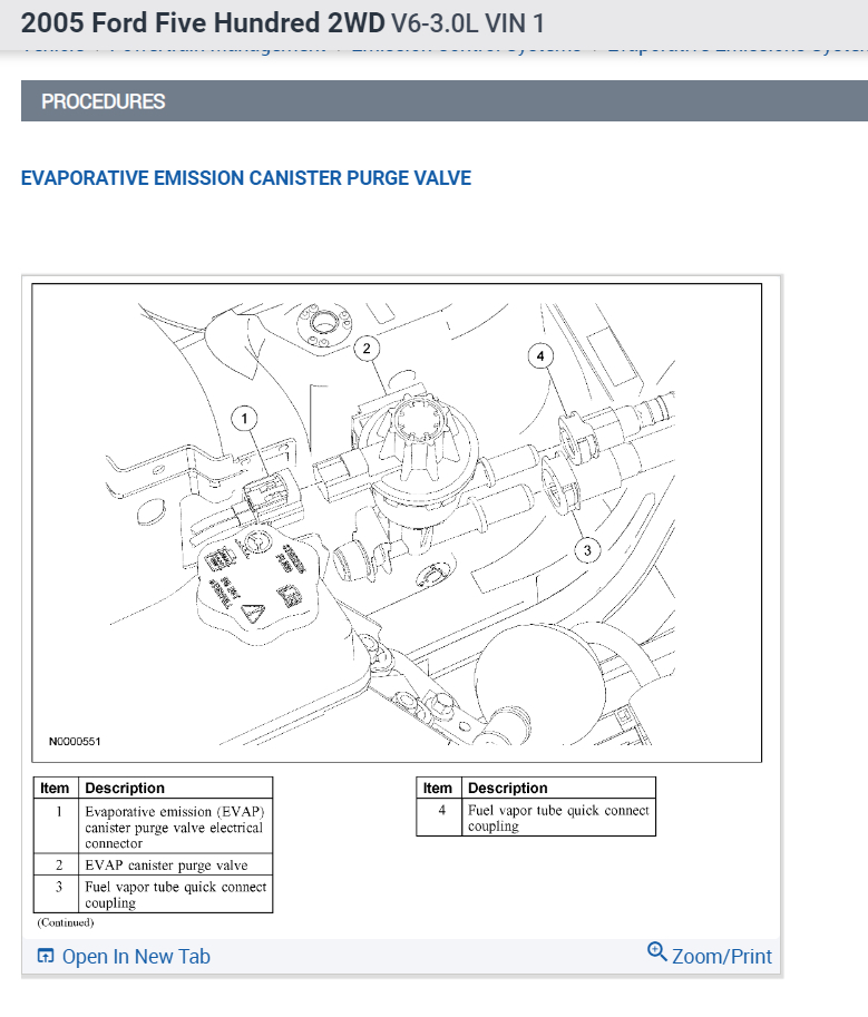

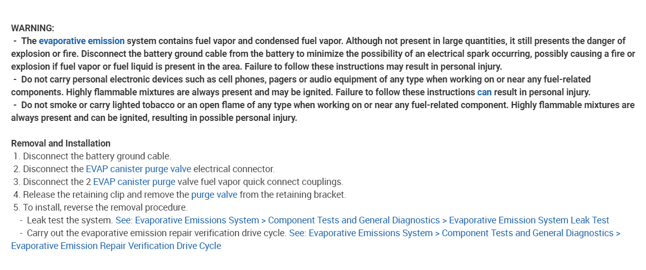

Can I get the code number? Also, we need to do a compression test on cylinder number two to make sure the engine is okay. I have seen the EVAP purge solenoid cause this problem when it is stuck on, and it might cause the gas cap message as well. Here is the location of the solenoid so you can remove it and try to blow through it, you shouldn't be able to. Please go over these guides to help us fix the problem.
and
Also check the gas cap to see if the O ring seal is okay. If not replace the gas cap. Check out the images (below). Let us know what happens and please upload pictures or videos of the problem so we can see what's going on.
