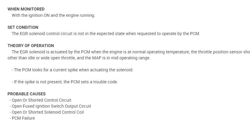

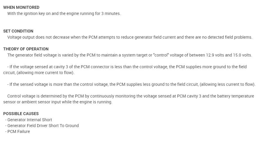

Good afternoon,
I attached the code chart for you.
12 is the battery disconnect. Do not worry about that.
55 is the end of the sequence.
32 and 41 are for the EGR solenoid and the generator field circuit.

32** EGR solenoid circuit An open or shorted condition detected in the EGR transducer solenoid
or circuit.
EGR system failure Required change in fuel/air ratio not detected during diagnostic test.

41** Generator field circuit An open or shorted condition detected in the generator field control circuit.
