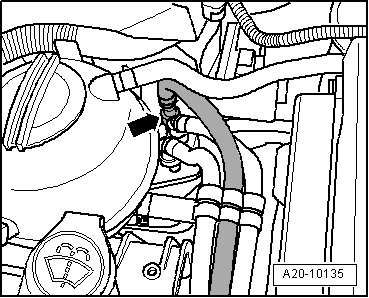

Remove fuel supply line - arrow - and catch escaping fuel using a rag.
¤ Press in securing ring to disengage the fuel line.

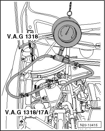

Install the fuel injector pressure gauge (V.A.G 1318) with the adapter set (V.A.G 1318/17A).
Open shut-off valve of pressure gauge set.
Switch ignition on often until fuel pressure on pressure gauge no longer rises.
Read off fuel pressure on pressure gauge. Specified value: 3.5 to 6.0 bar.
