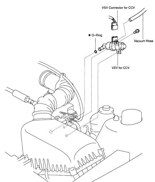

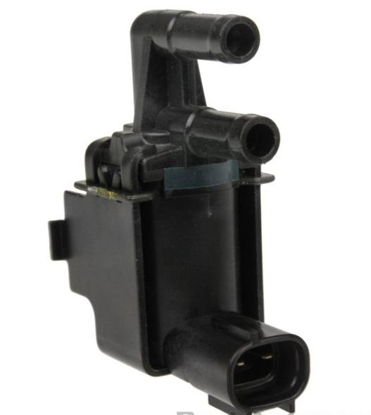

The solenoid is mounted on the side of the air cleaner housing and looks like the image. Testing is easy to do. Disconnect the power connector and the hoses and remove the valve. Then just try to blow through it in both directions. It shouldn't let air through either way. If it does it's stuck open and needs to be replaced.

The leak would be an internal vacuum leak. That solenoid runs from the vapor recovery canister up to the intake. It's job is to pull fuel vapor out of the canister in controlled amounts at specific times. When the EVAP system operates normally it captures the fuel vapors and stores them, then that solenoid is operated under computer control to allow the engine to burn off those extra vapors. The EVAP system runs tests on itself and in this case has discovered a leak. However the leak isn't something you can see. What happens in the test is that a valve on the fuel system closes off the vent system, then the computer counts how long it takes for the system to build a vacuum in the system, once it hits the correct level the vents are opened and it times how long it take for the vacuum to drop. If any of the valves fail to close and it cannot pull a vacuum, it sets the P0440 code or if it stops the test and the vacuum drops suddenly, it sets the same code. In this case with a leak and incorrect purge flow I would look at the pieces of the purge system that could cause a "leak" but not set other EVAP codes.
