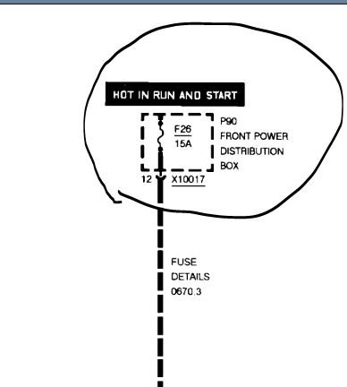

Okay, lets start at the beginning. If the DLC isn't working, first check the fuse 26 in the under hood power distribution box. See picture 1.

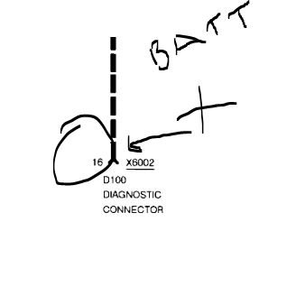

Next, check pin 16 on the DLC to confirm power. See picture 2.

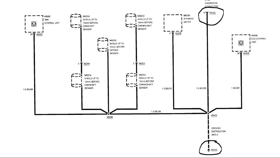

Next, confirm continuity to ground at the DLC. See picture 3.

Hey Joe,
fuse 26 good.
Pin 16 no power.
Pin 19 ground.
tell me what to do next Joe. Thanks.
