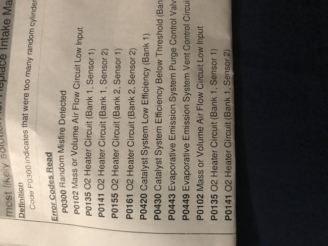

Getting a rough idle at times with black smoke coming from exhaust. Also i keep blowing an engine sensor fuse.

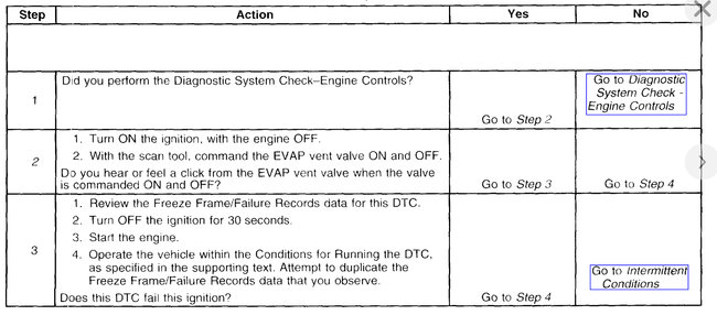

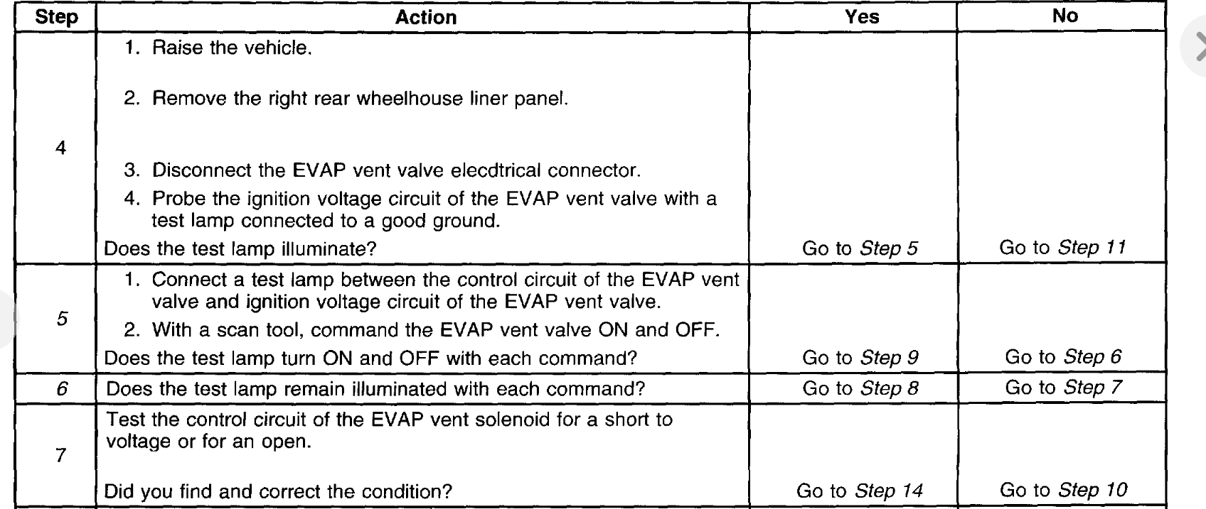

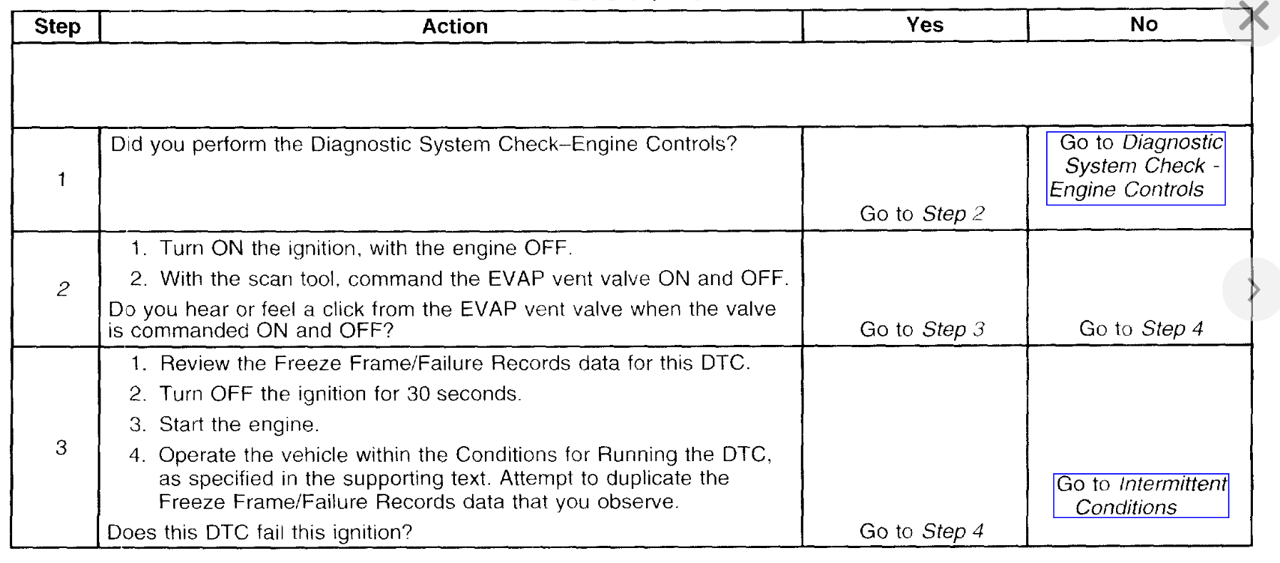

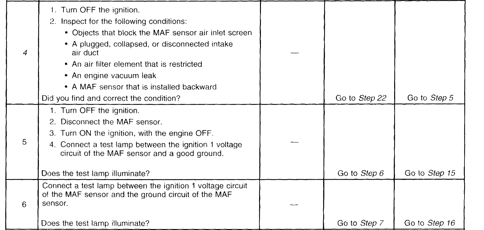

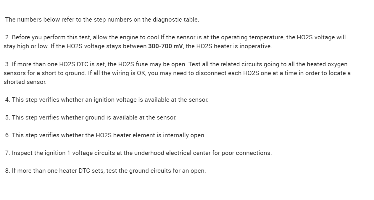

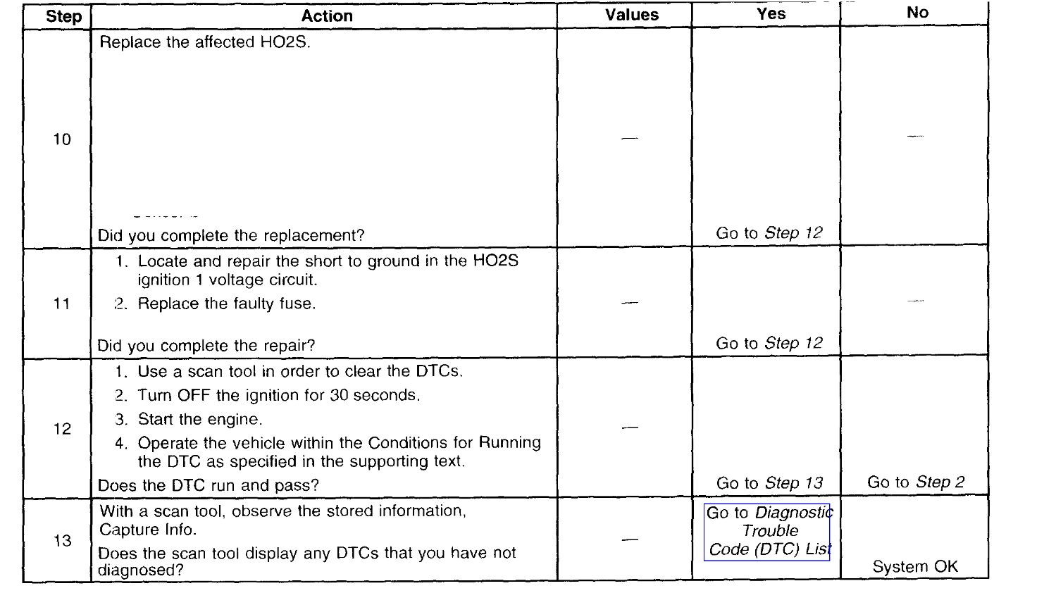

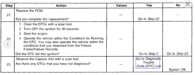

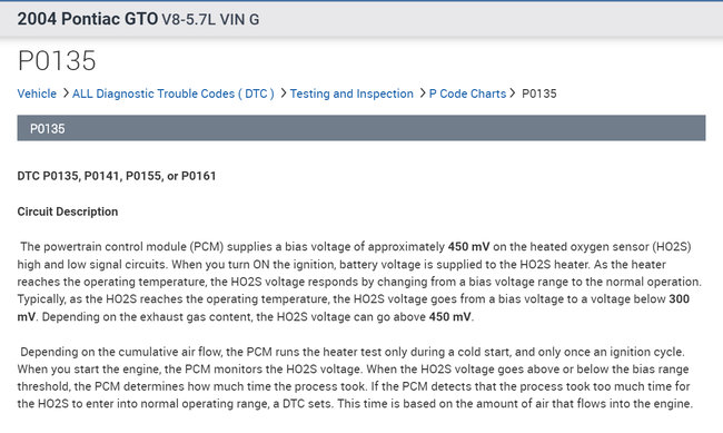

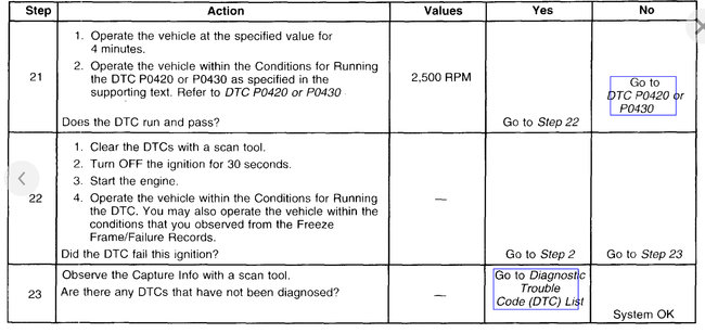

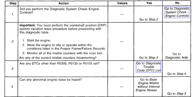

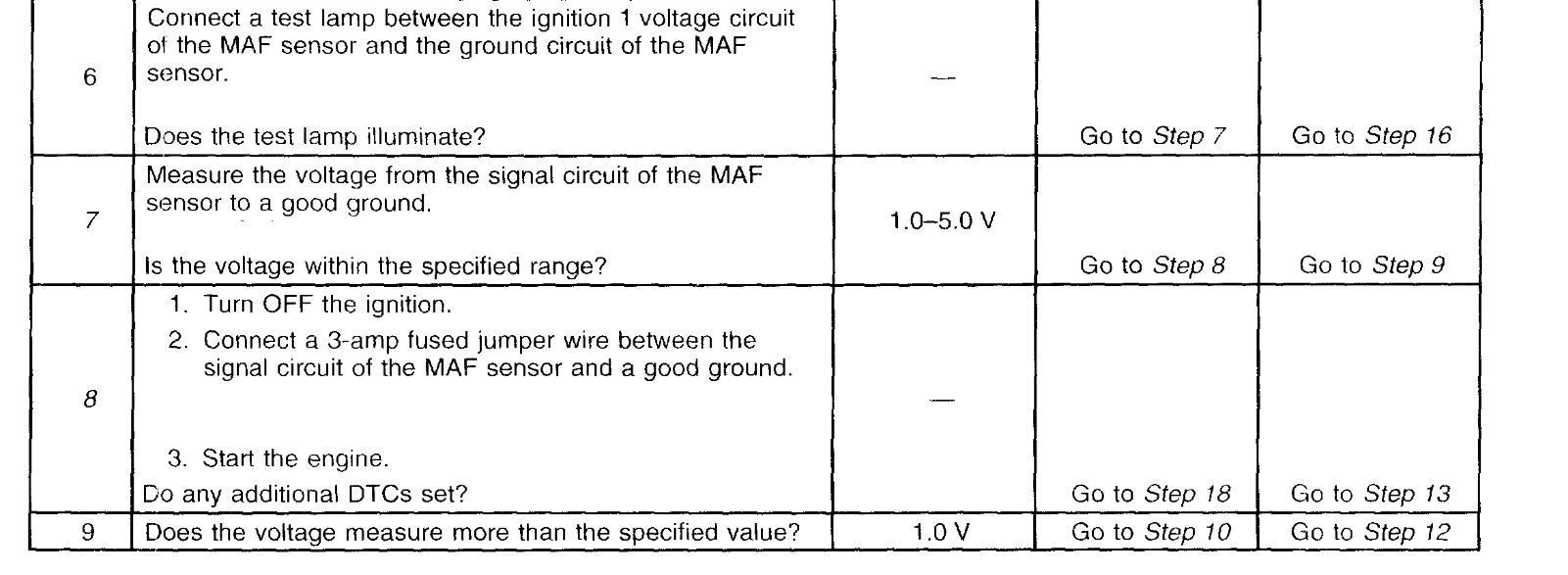

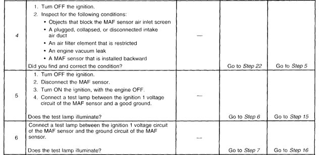

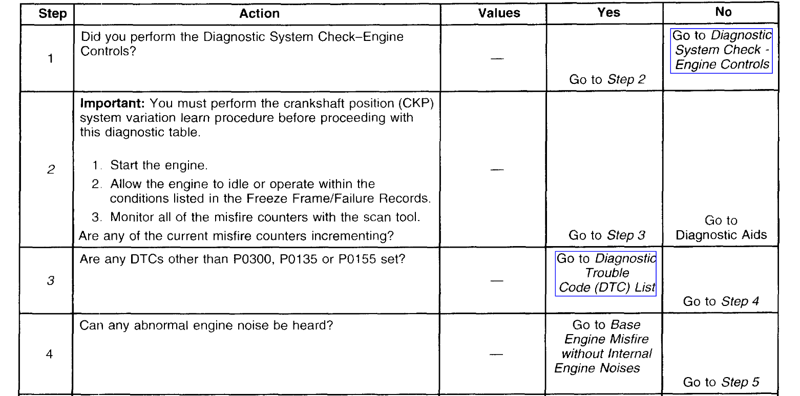

Checked all the codes all these came back.
Jul 3, 2019 at 4:25 AM
SCGRANTURISMO
  • 4,897 POSTS

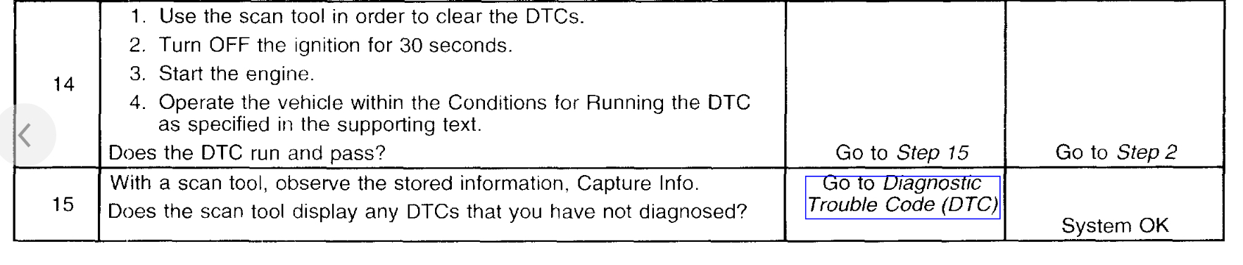

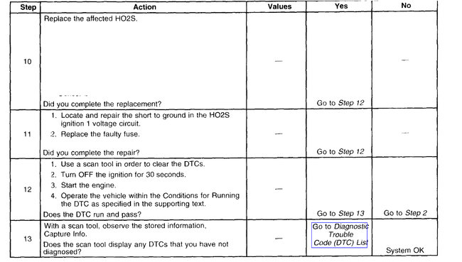

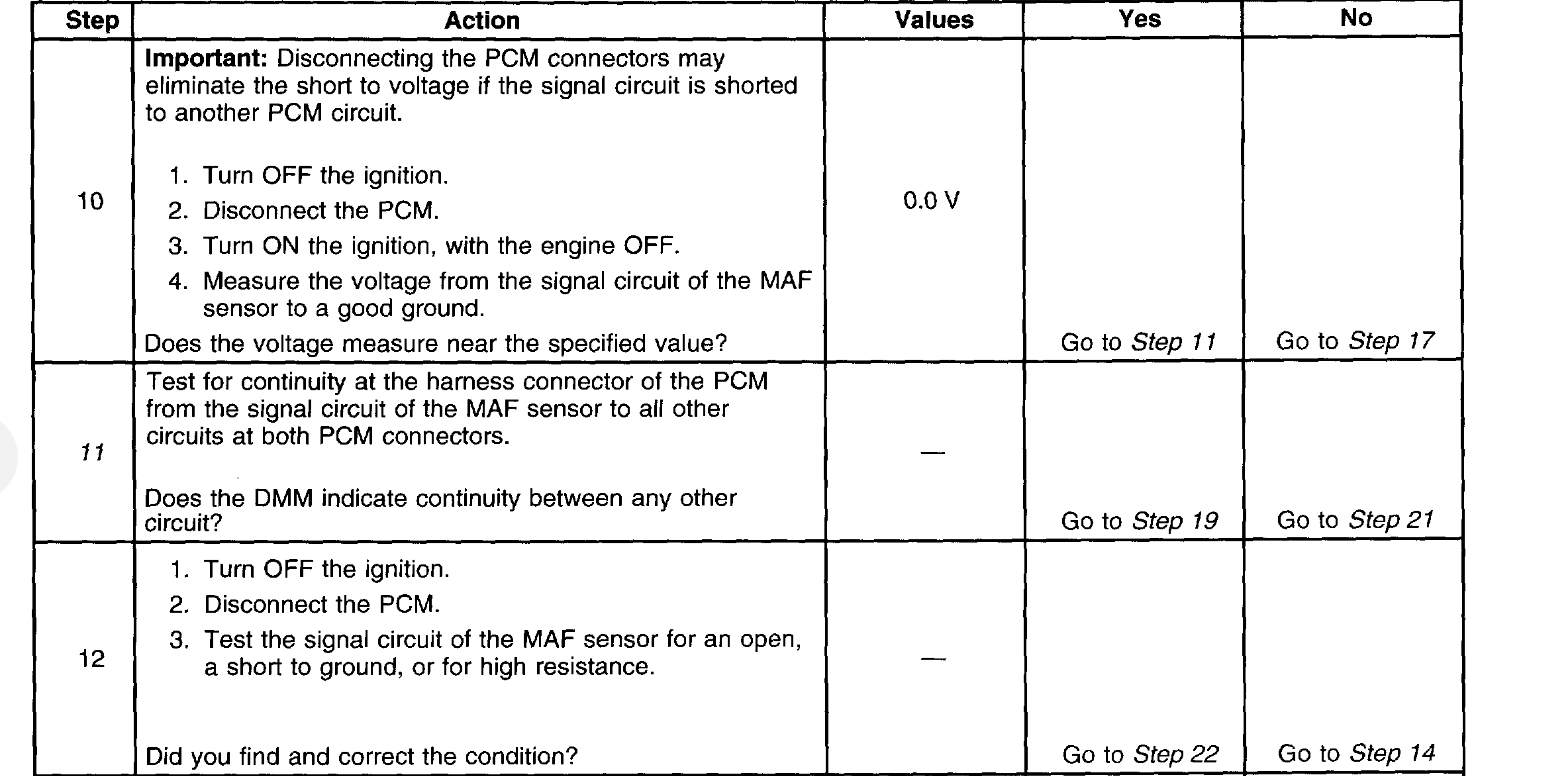

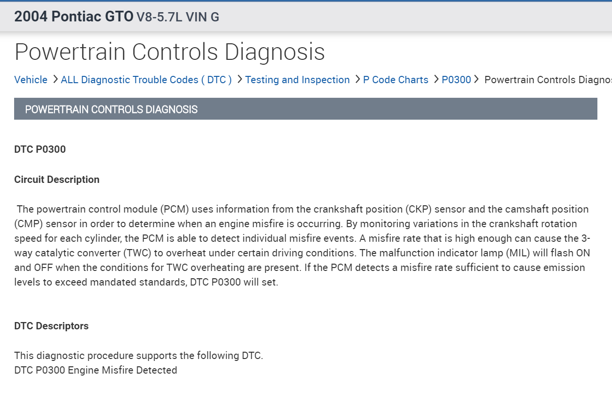

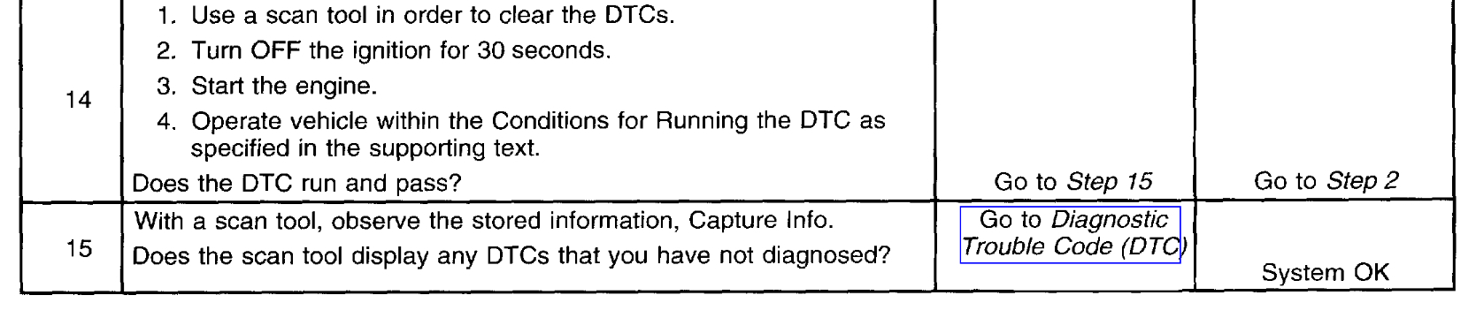

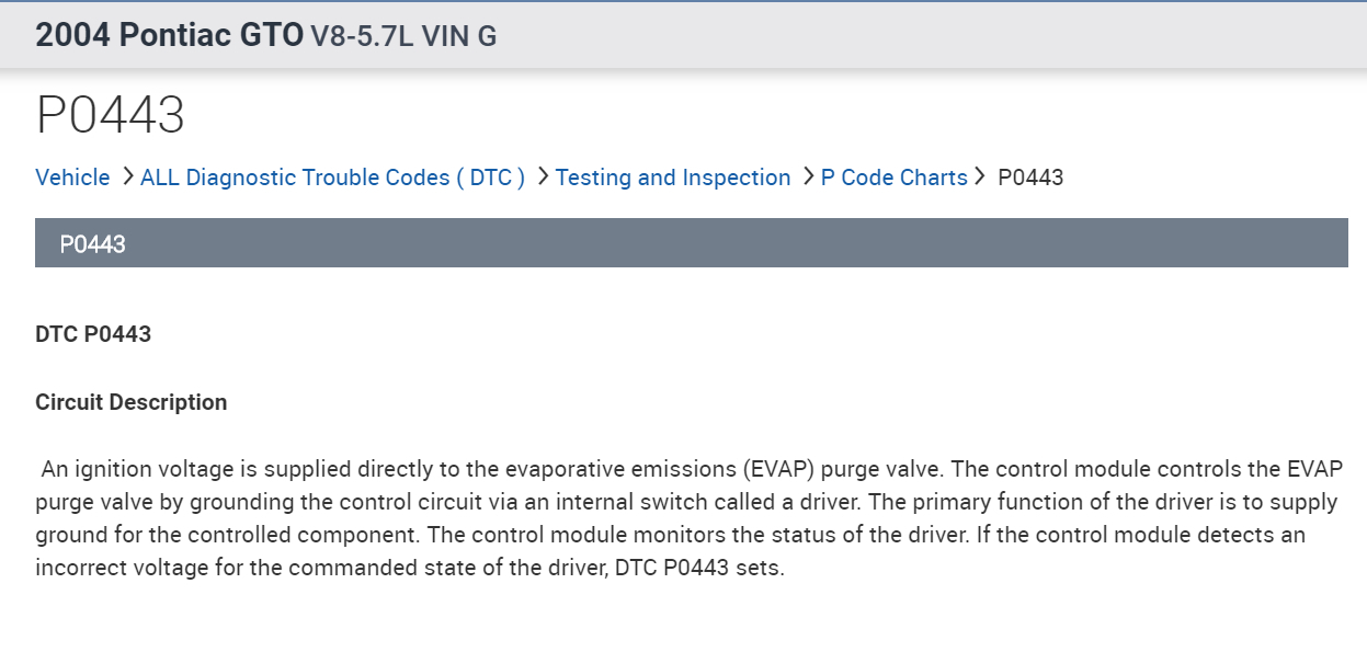

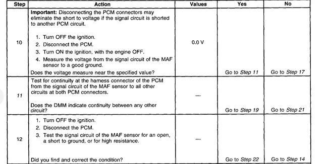

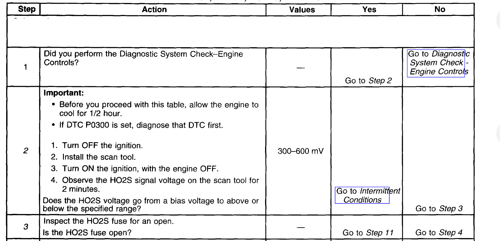

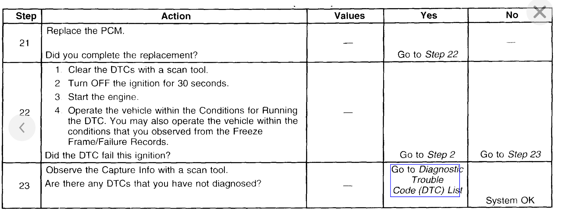

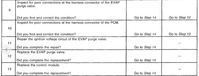

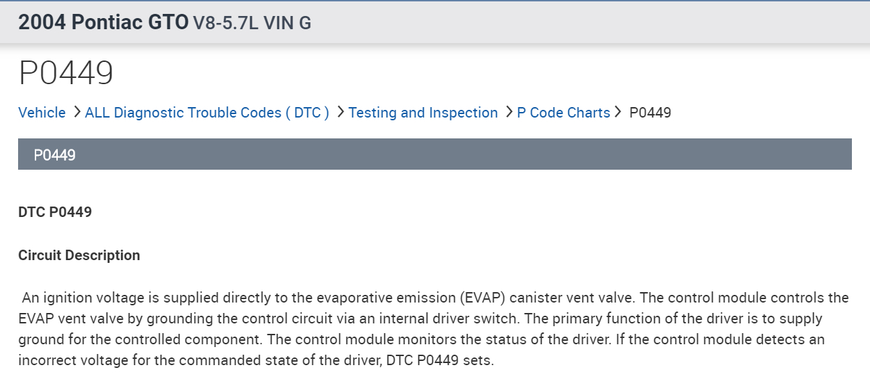

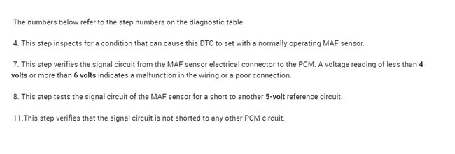

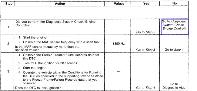

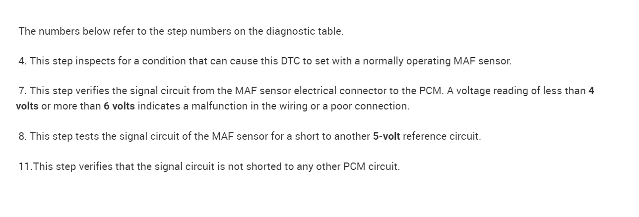

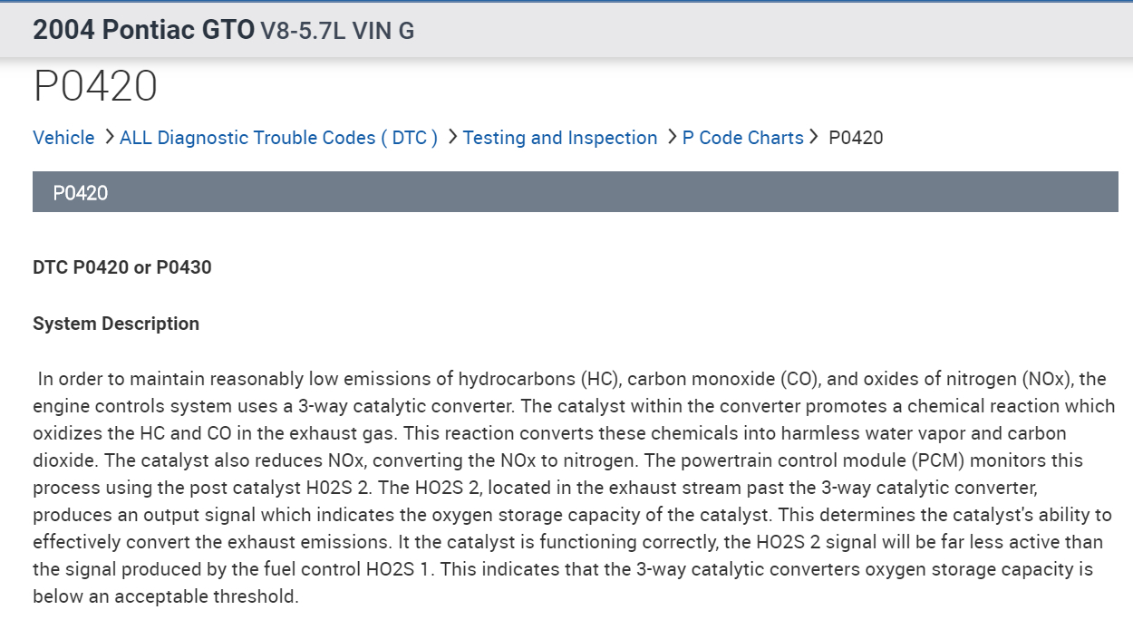

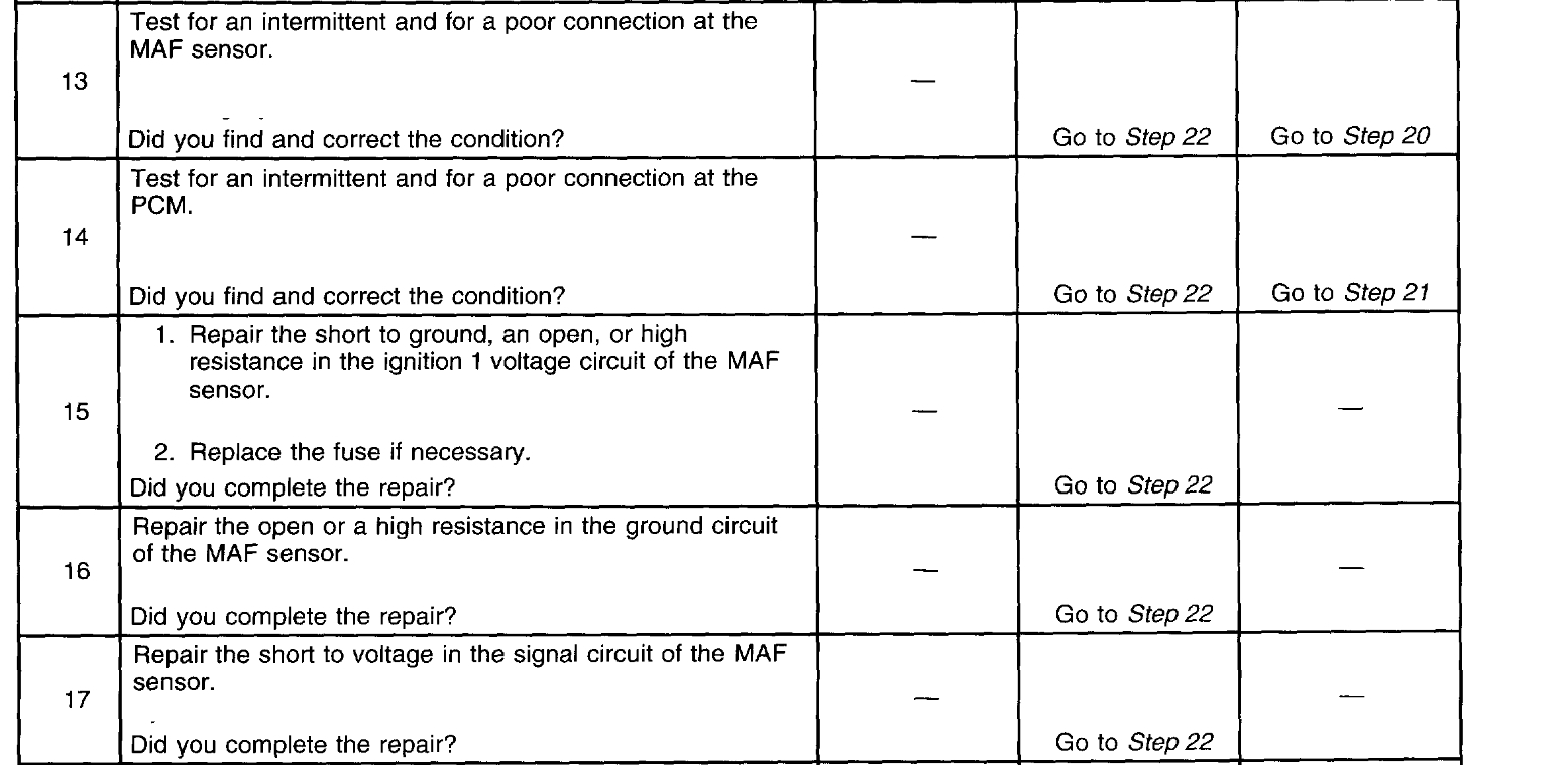

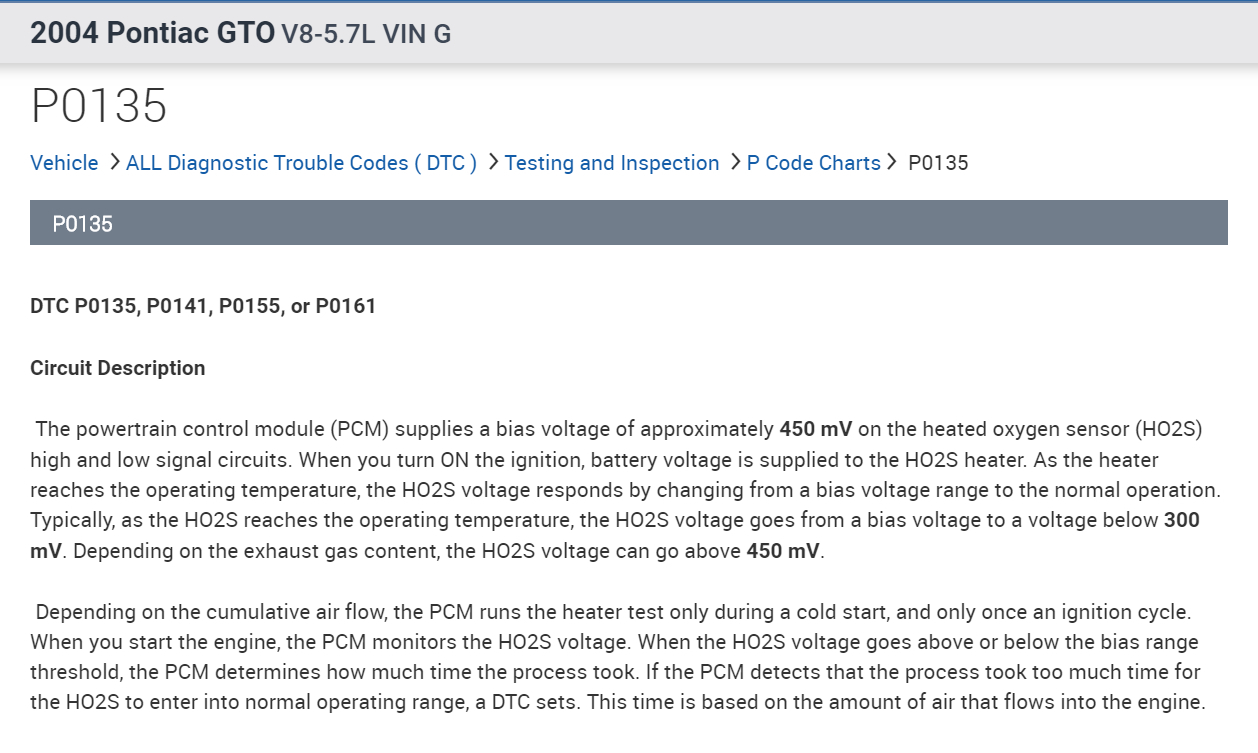

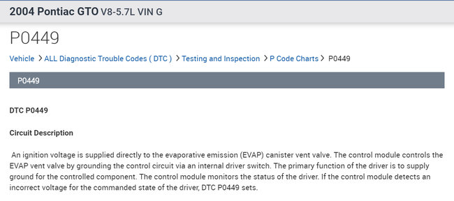

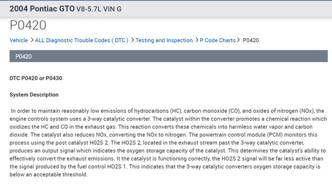

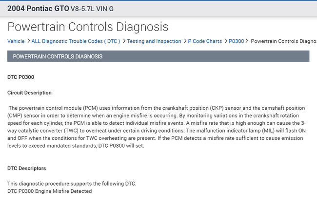

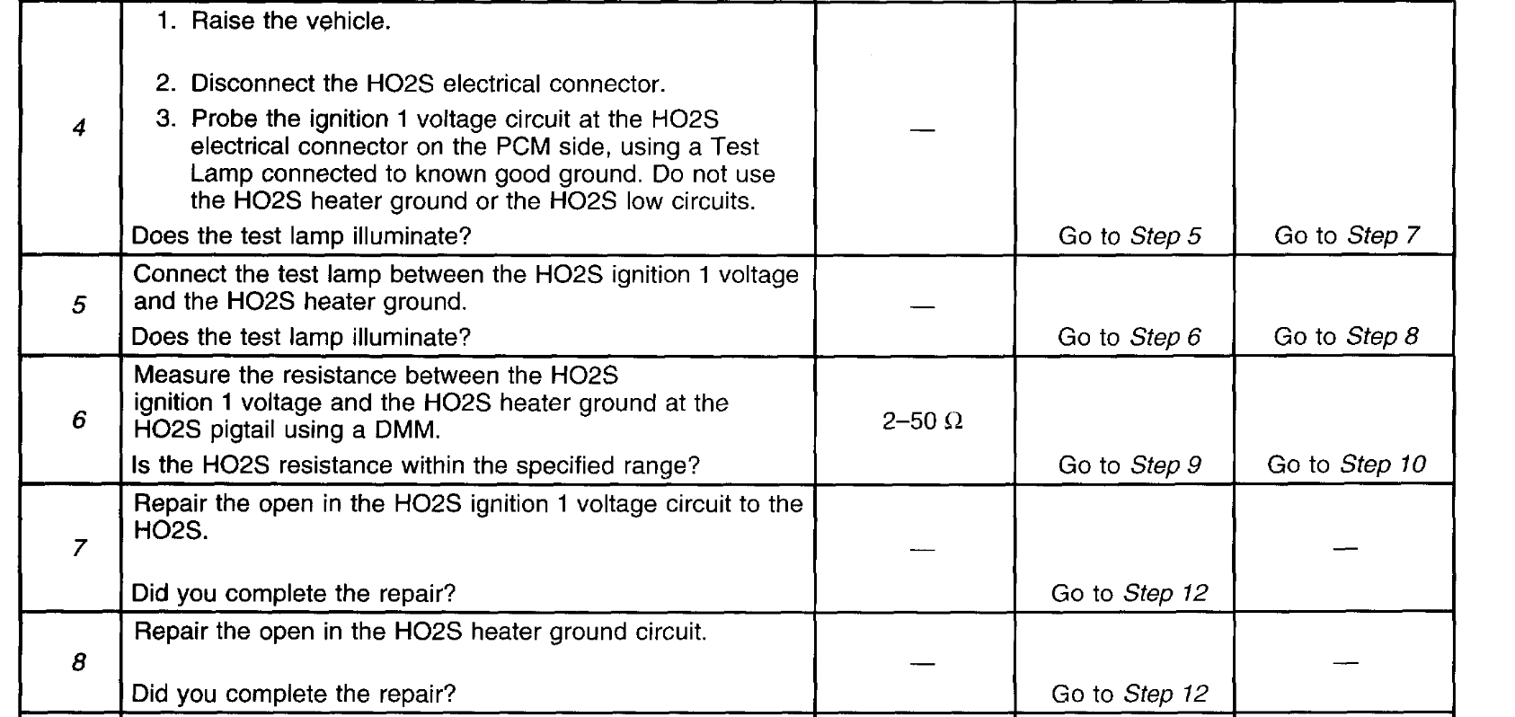

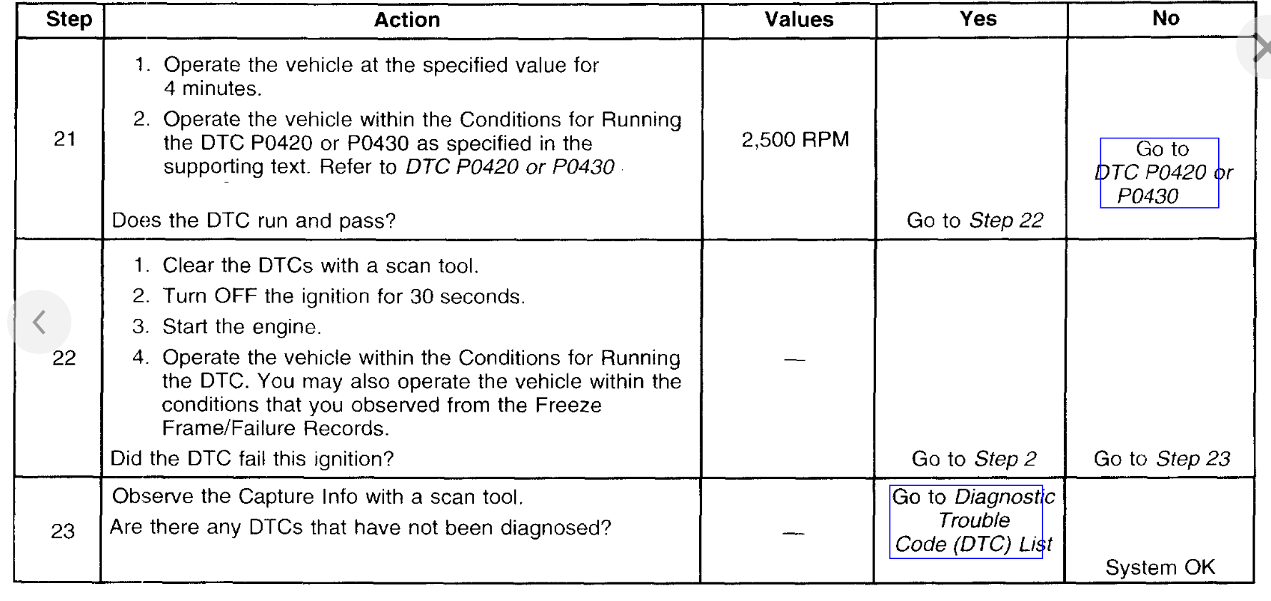

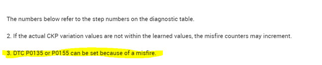

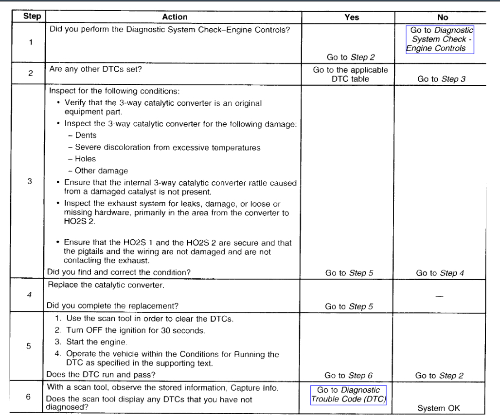

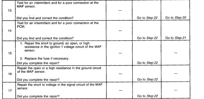

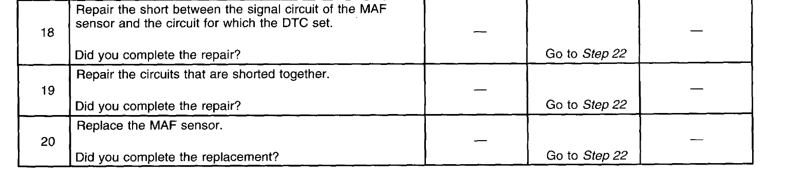

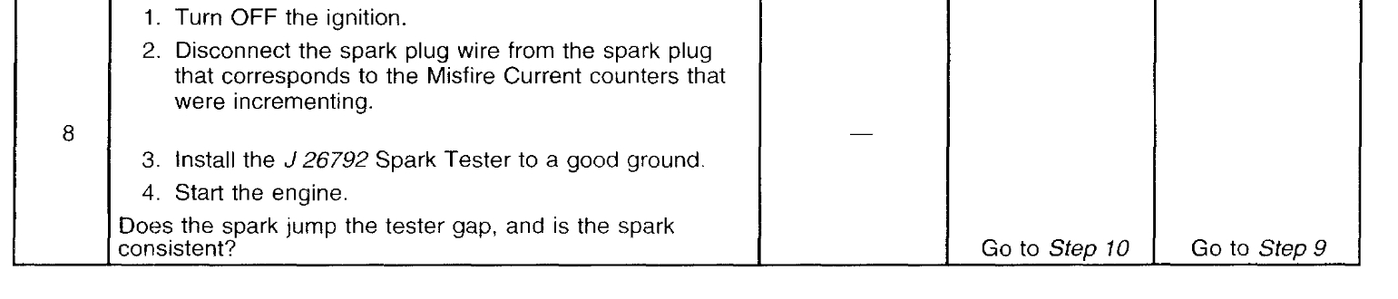

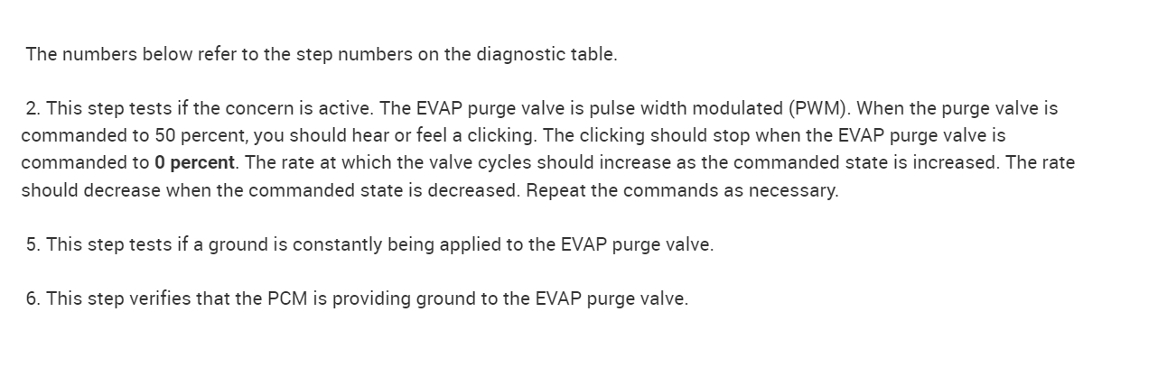

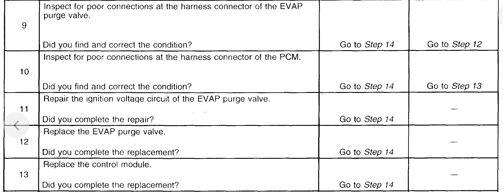

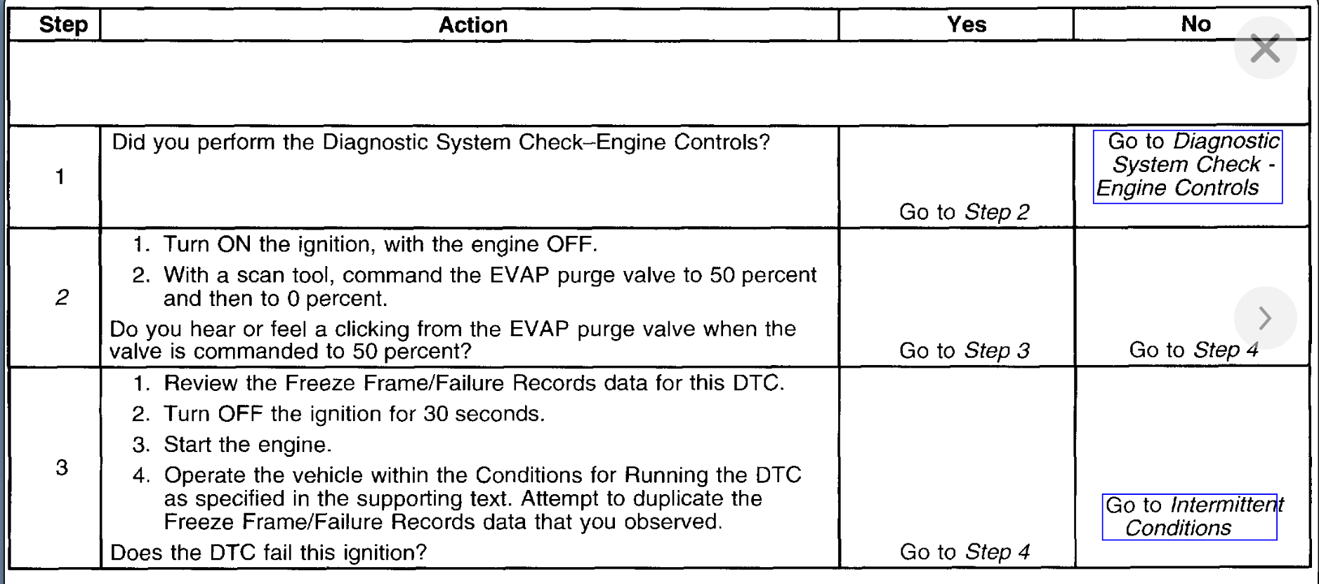

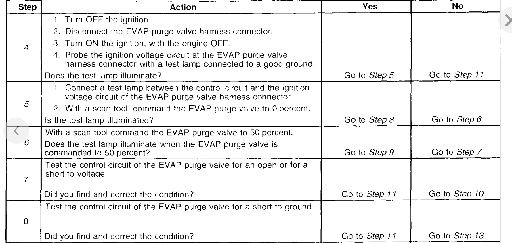

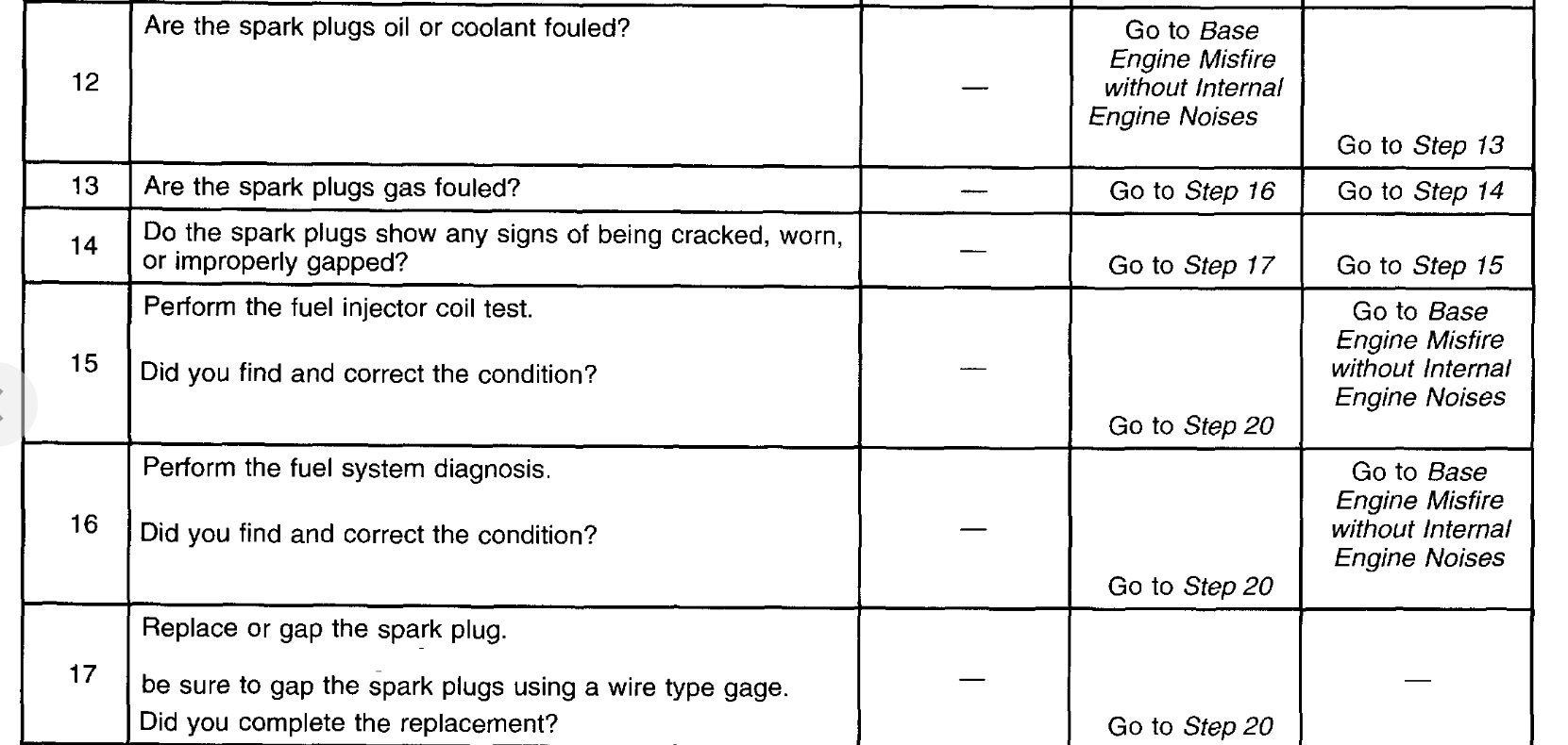

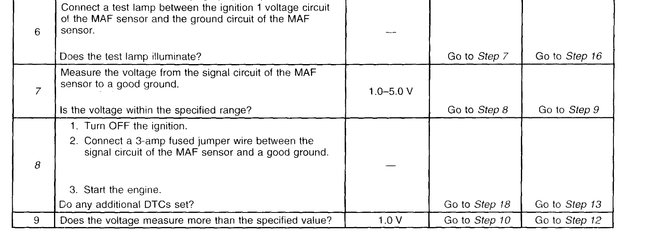

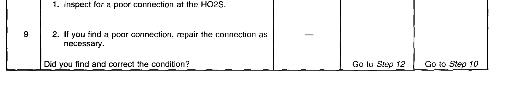

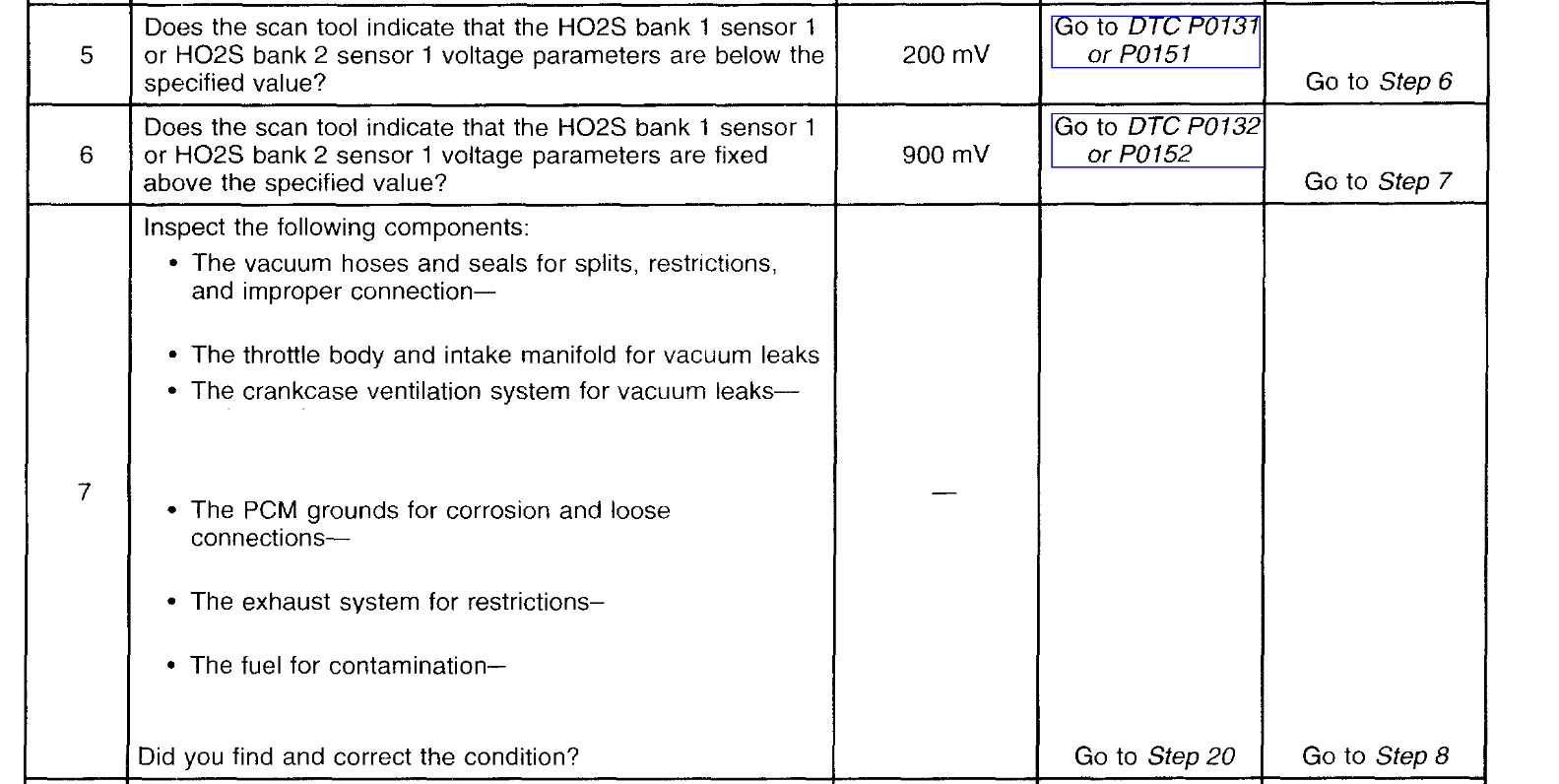

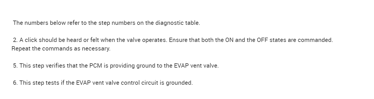

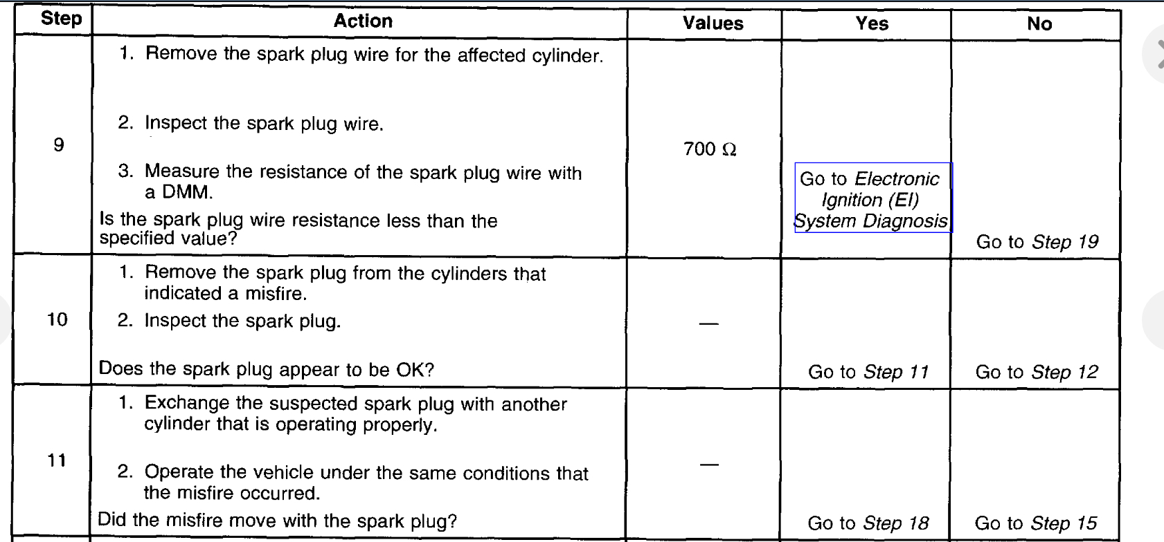

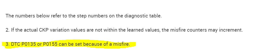

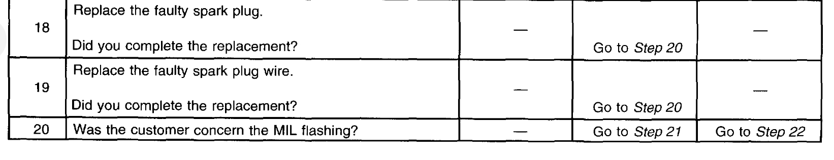

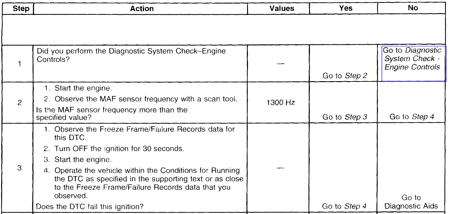

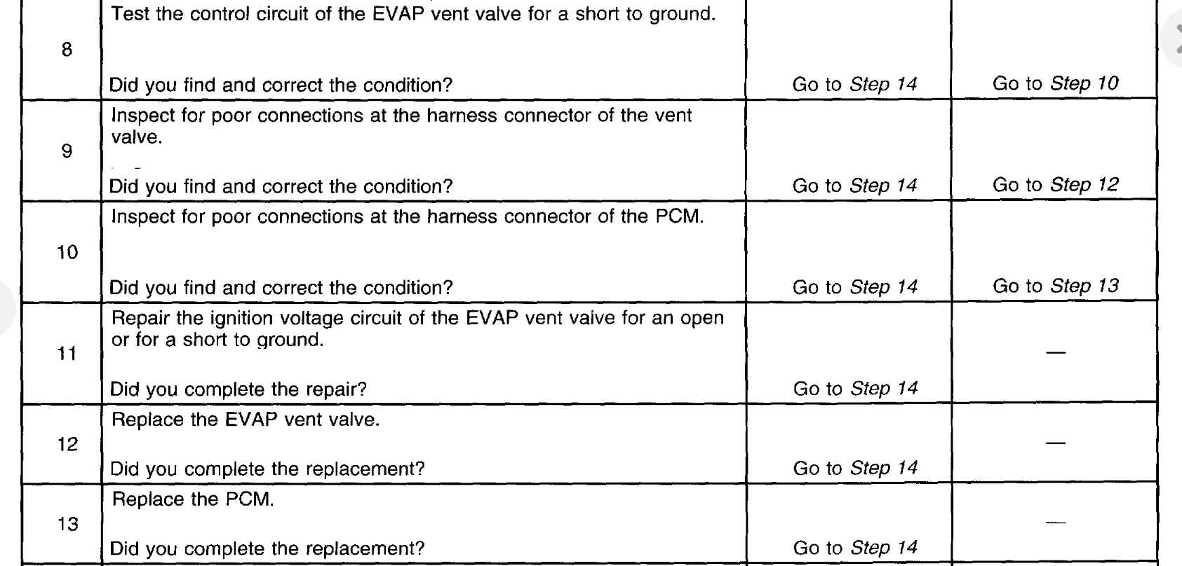

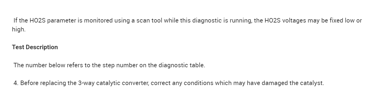

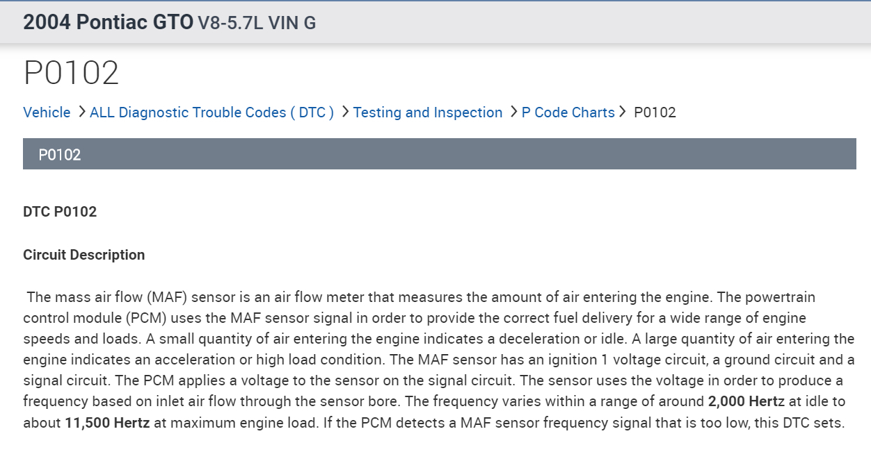

I have included all the factory diagnostic troubleshooting guides for all of the Direct Trouble Code(s)DTC(s) that were listed in the picture that you sent. They look like they are all related to each other, so read the guides carefully, as they will explain which are related to which. Once you get one or two fixed they will start to fall like dominoes. Please get back to us with what you are able to find out.
